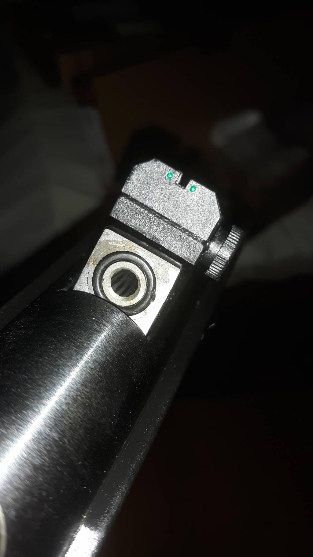

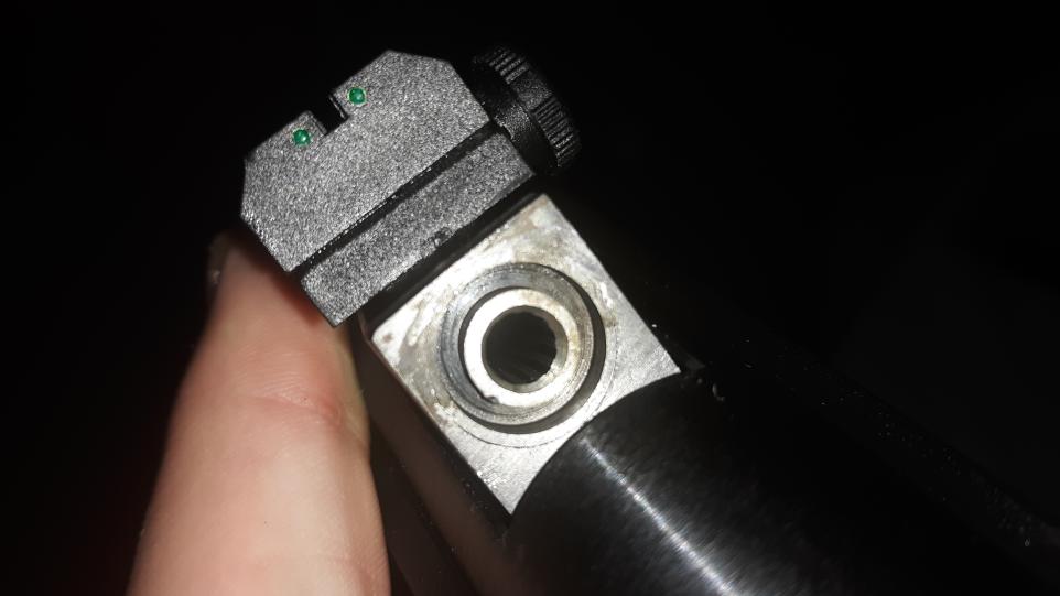

I just got a new airgun (Hatsan edge spring piston .22 caliber) and I'm wondering if I need to return it or just buy new breach seals. After unboxing the rifle and inspecting it to the best of my limited ability I started to shoot it. After about 10 normal shots of the rifle, an extremely loud sound came from the breach of the gun, causing ringing in my left ear for about 3 minutes. After that shot, I took it inside to look at it. I might have looked something over, but I figured it was just oils from the manufacturing process burning off. I waited a bit and decided to shoot it again, with a pillow over the breach (I didn't want to bother the neighbors). after a few shots, I tried firing the gun without the pillow, holding the rifle a good distance from my ear. It produced another incredibly loud sound. I think that the breach seal and the breach may be damaged. ( pictures below)
I know that the seal is damaged badly because of the strands of rubber that are sticking out of it. My question is whether or not the breach itself is damaged as well.

That Breech seal Doesn’t look that bad to me. I have a Hatsan 95, and It dieseled Real bad for quite a few shots.It took at least 20 to 30 shots for mine to quiet down. They overlubed The compression chamber. Not saying that is the issue with yours but just a thought.Your first picture is hard to tell but the second picture seems to look OK to me.There are other guys on here that or more experienced than I am on break barrels and can maybe Give you their opinion or help.I don’t like my Hatsan Break barrel. It was actually my third break barrel and was about to give up on break barrels. But then decided to give them one more try. I did some research and found out for the price, you can’t beat the Weirauch Air rifles. I Bought The HW 50 and love it. Fit and finish is way better than the Hatsan.It shoots smoothly and has a great Trigger And is accurate. I’m just saying that because if I was in your shoes I would send it back And buy a German made one.I bought mine at Pyramid air for $300 and was a refurbished one but didn’t look like it. It looked brand new when I got it and shot like brand new.

Breech seal looks fine although your first pic shows you took it out. As long as you didn't damage it any taking it out, re-install it and your barrel, if you haven't already will need to be cleaned. Depending on how long you've had it, I'd say shoot the daylights out of it for a week or 2 and see what happens and then should you choose to, you'll still have plenty of time in the 30 day return period to send it back. You might also get a phillips head screw driver and snug up the stock screws...2 on either side in the front, third one behind the trigger and there's a hole in the trigger guard for the screw driver. Springers are notorious for loosening stock screws.

The seal was sticking out of the breach when I opened the rifle after the dieseled shot. It looks damaged and has little pieces tearing off of it. I am planning on buying a new seal. I see the 5 piece kit on the hatsan store and was wondering if I could find breach seals that would work at a hardware store or elsewhere in person.

If you feel like you should replace the breach seal, I'm not gonna say you shouldn't. However, if it failed BECAUSE the rifle is dieseling, which it shouldn't, but if it did and you replace the breach seal. You run the risk of damaging the new one before the rifle settles down and stops dieseling. My recommendation would be to get the new seal, but wait to install it, until velocities have leveled off. What were you getting for velocities when you shot it? Can't speak to Hatsan or HW as I have limited airgun experience, but my Benjamin trail took almost 2 full boxes of pellets before velocities became what I would consider consistent. If I accidently get too much oil around the piston when I oil it, it takes about 50 shots to blow all that out and settle down again.
Another possibility (in addition to the dieseling, not instead of) is that you may not have had the barrel fully locked in place after cocking it. I had this happen to me with a Hatsan once. When I pulled the trigger, boom! I looked and the barrel had opened up and the breach seal was about 3/4 the way out of the groove. I looked everything over carefully and put the breach seal back in. I then loaded the rifle again, this time triple checking that I had fully closed the barrel, then carefully took a shot and everything was normal. My Hatsan was relatively new at the time and I was in the process of breaking it in and getting rid of the excess lube.
What happened could have been a combination of the dieseling and the barrel not being fully locked in place.
Is that a small burr at the 8 o'clock position on the breach or is that just some gunk?

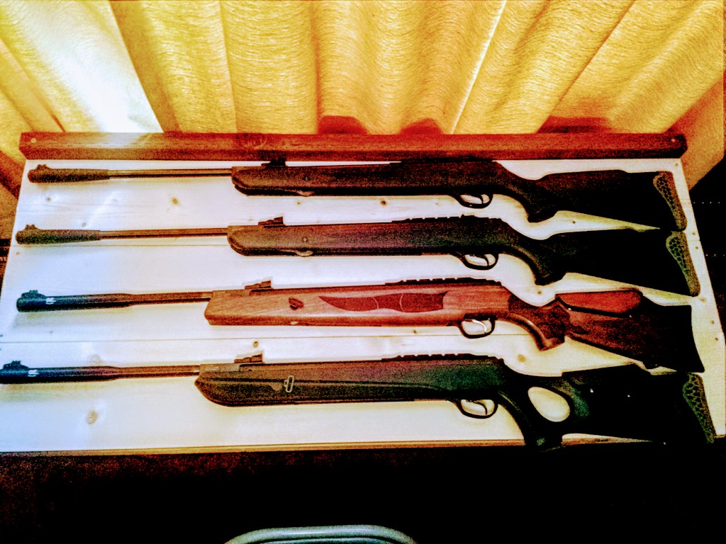

A few of my Magnums
