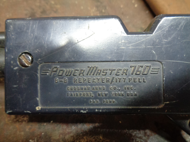

Tuning I'm new here. Trying to repair old Powermaster 760.
I read you need a serial number to know the year and I can't find one anywhere. And it says patent pending. The stock is plastic that looks like wood. Any advice?

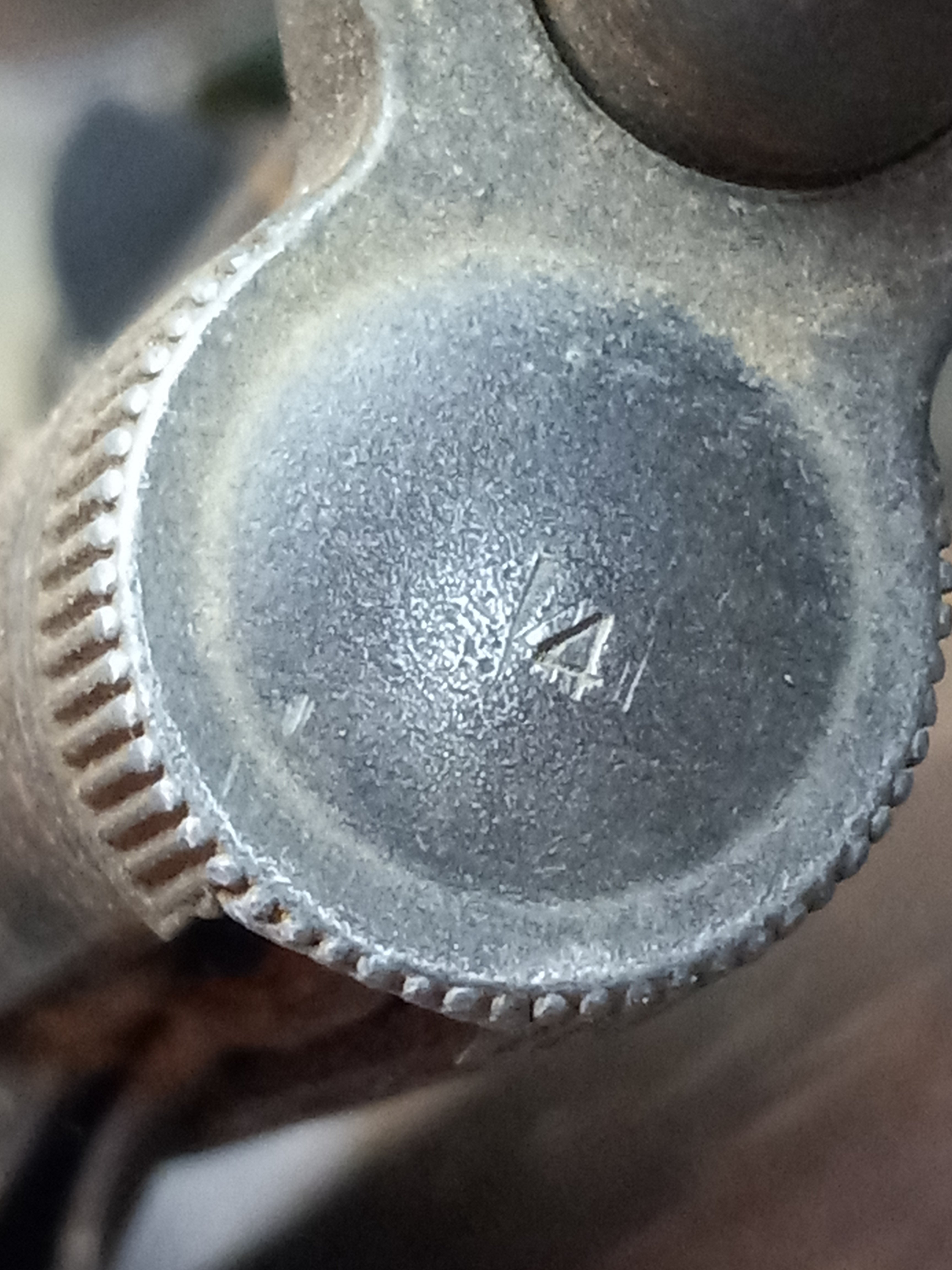

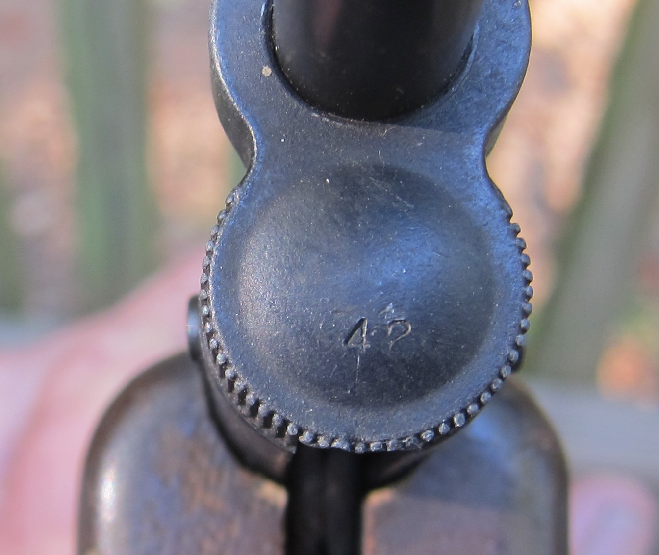

If you look at the front of the pump pivot beneath the barrel, you'll probably find a couple of numbers like this.
They'll tell you the month and year that your rifle was manufactured. This one was made in April of '72. If yours has the heavy plastic (polystyrene) stock and forearm, it's of the same (early seventies) era like this one.

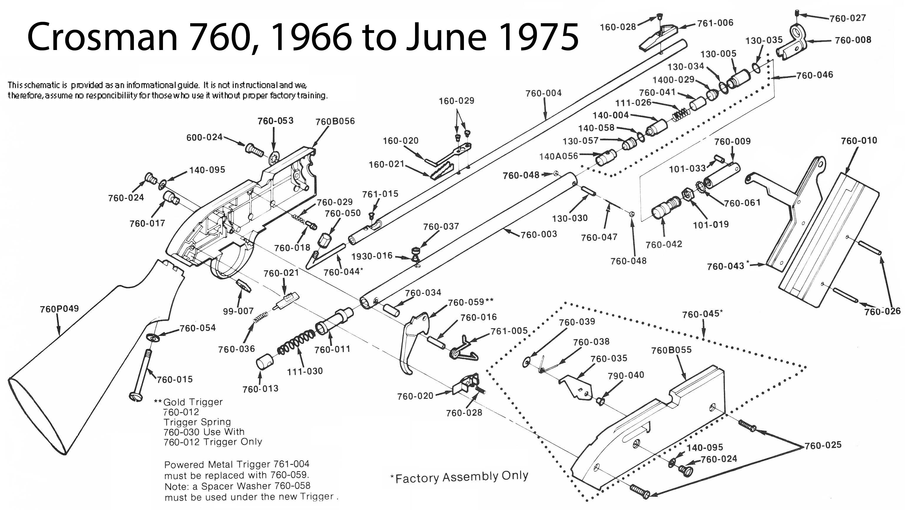

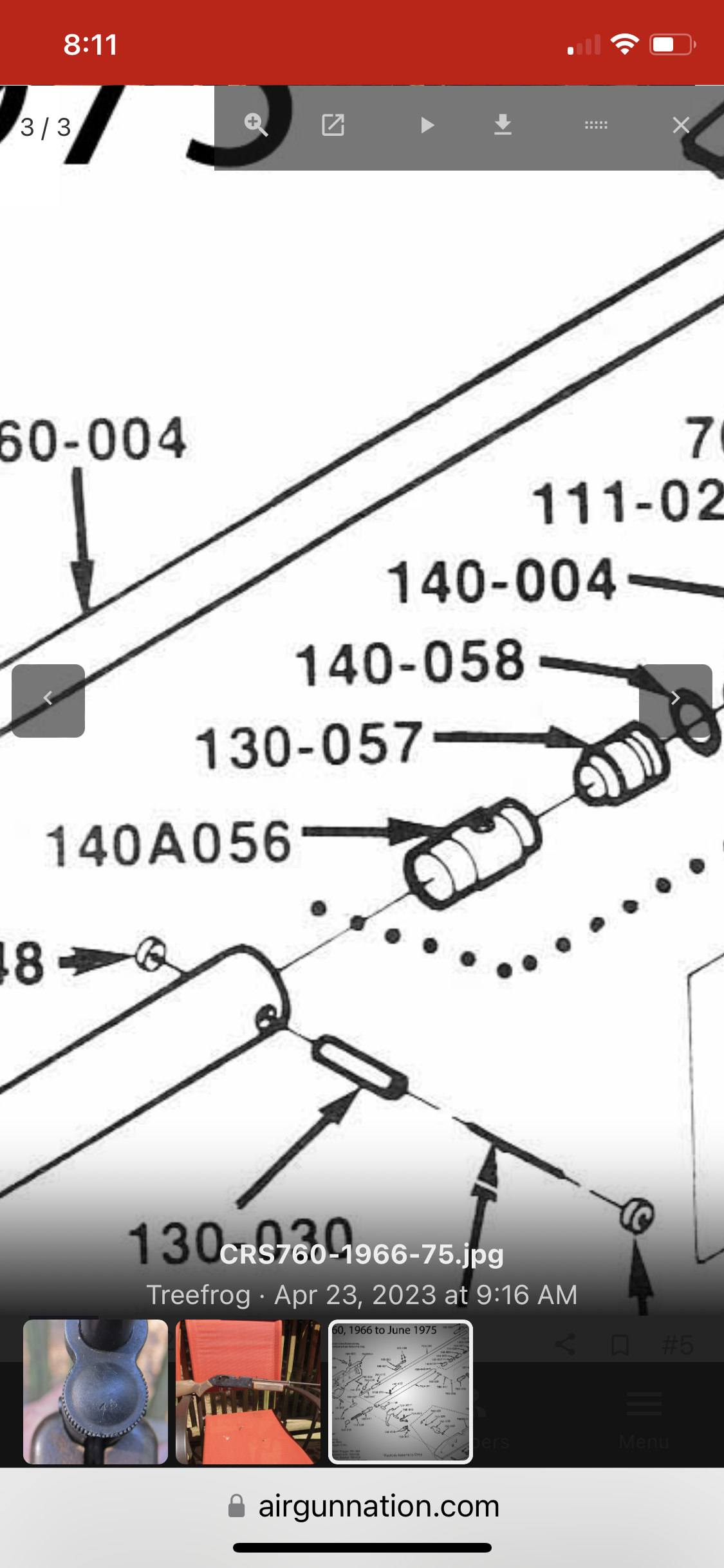

They're not too hard to repair. Parts are available from a few places. Mac-1 Airguns, among others. Here's a parts breakdown -

^ I think he's right. That does look like a double stamp. If so, then April of '74, probably. Those stamps are known not to be done very consistently. Perhaps the Crosman pivot-stamper-guy was low on the totem pole and it's reflected in his less than firm or accurate work. I have a pivot like that from an early gun that isn't stamped at all.

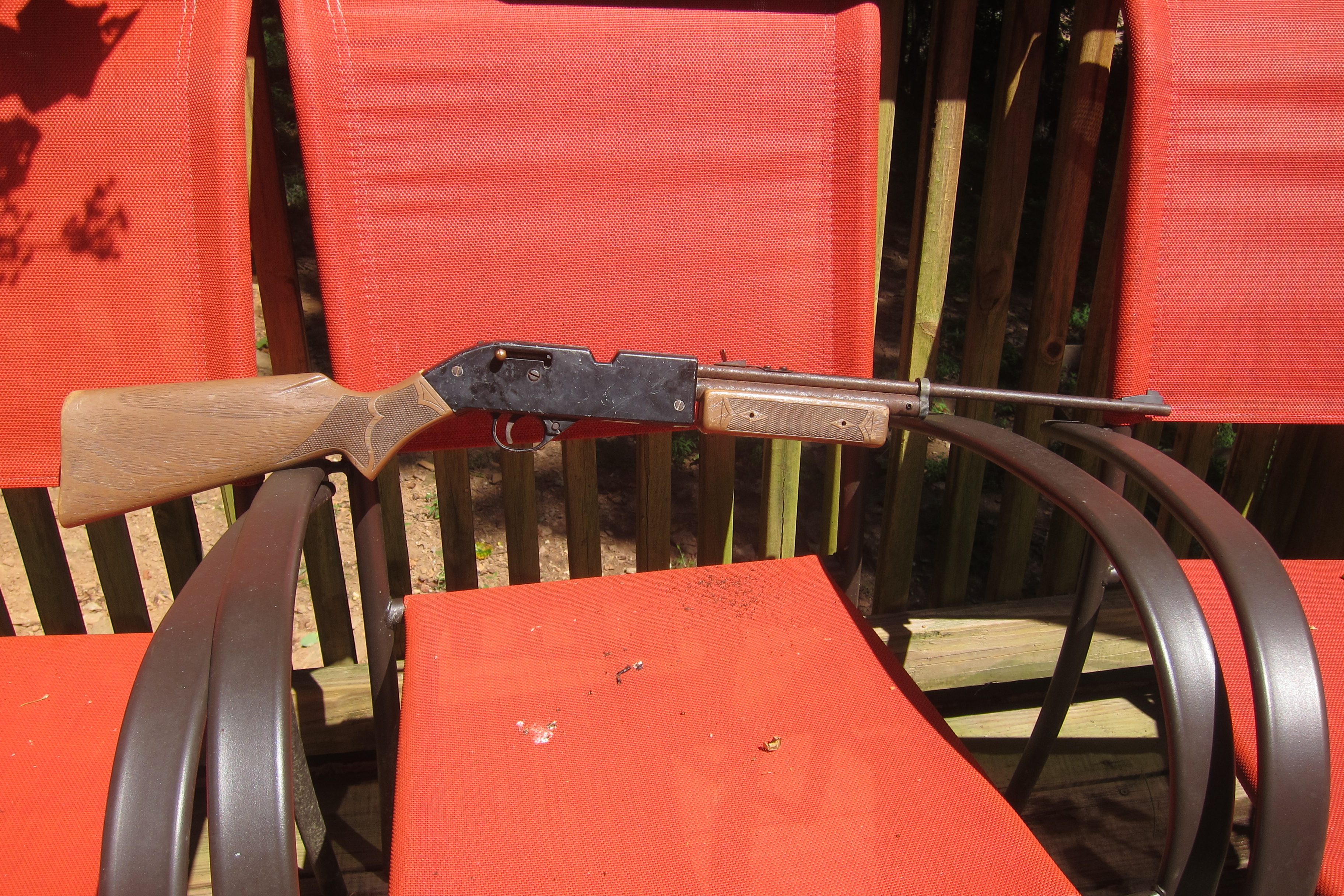

Post some more pics, Jim. I'd like to see the rest of the gun.

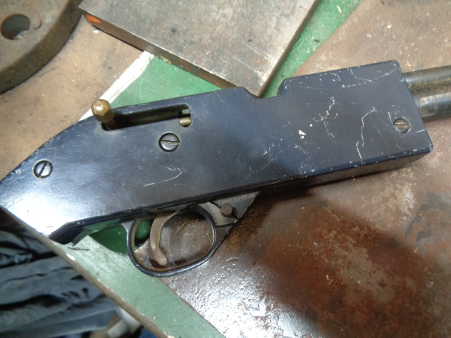

Thanks, Jim. Looks like it's all there and you've got a fun project. The gold trigger is a bonus as it reinforces the era of the build.
Mind the BB-retention button on the back of receiver when you pull the sides apart as it can launch the spring across the room.

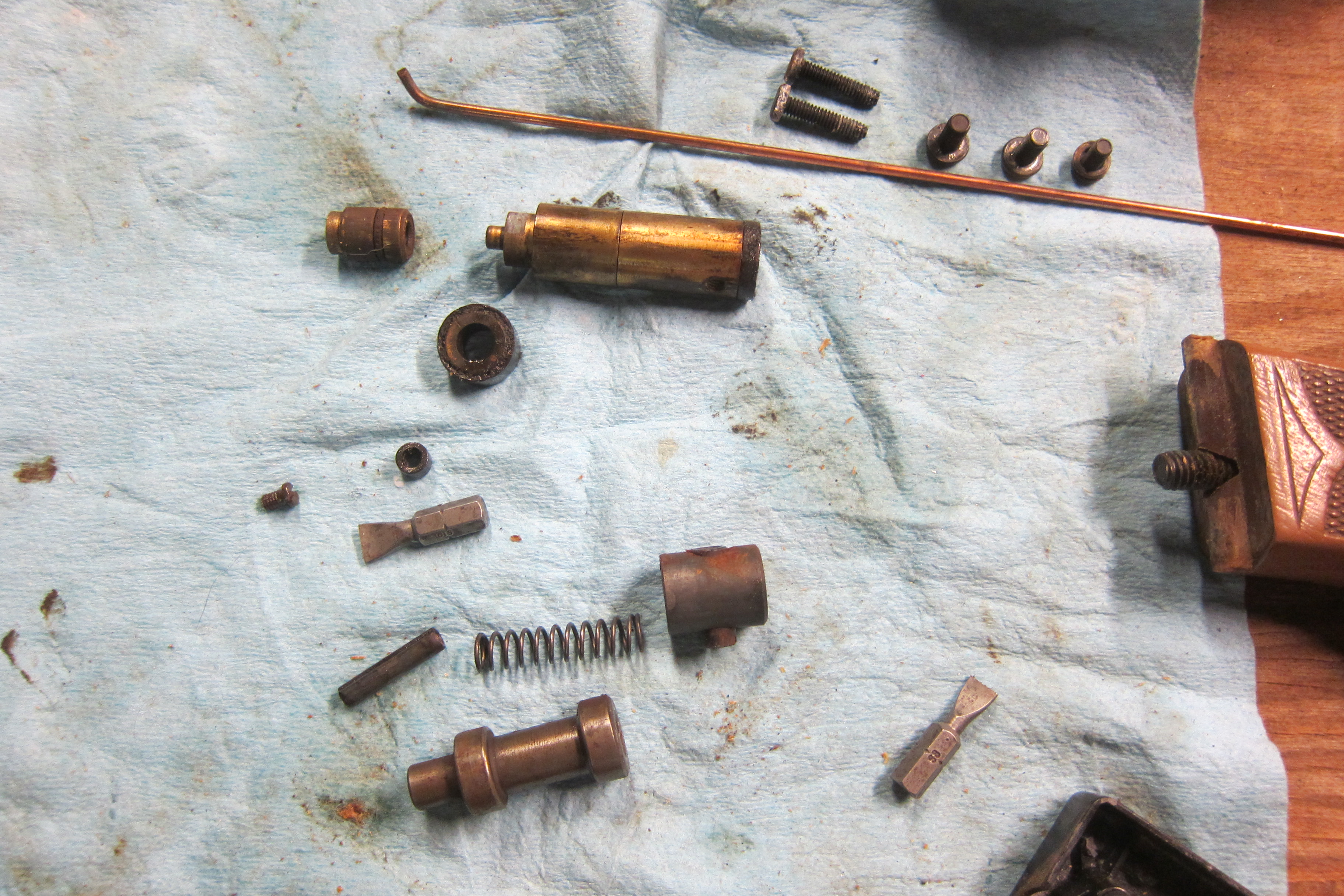

The internals will look like this.
And the valve will look something like this. Probably less crusty... (I only bought this one because it had never been disassembled and was $10.)

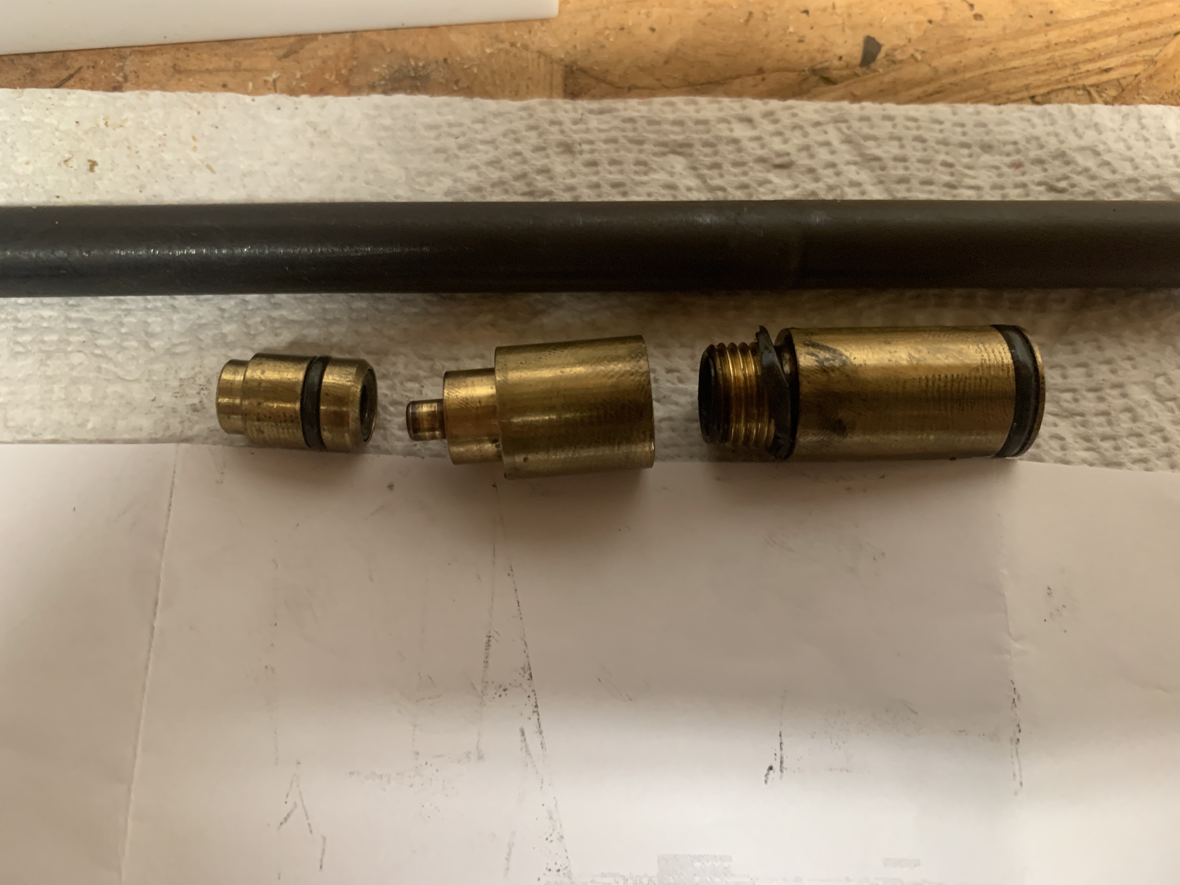

I tore apart a 1980 760 about a month ago to clean and reseal. It went okay but I did need to research along the way. Besides the usual tools you'll need a sturdy dowel and mallet to knock the brass air chamber out of the tube and a propane torch (or similar) to heat the air chamber to soften the Blue Loctite. Be ready to pad the teeth of two pairs of channel lock pliers to get the warm chamber apart. The pads are so you don't scratch the brass.
When you put the air chamber back in the tube, use the dowel to move the outlet port into the correct position. Keep pushing the new gasket in with your thumb as you switch poking the dowel in both ends to adjust the chamber. You'll feel it when the little gasket pops into place. It's a fine tune.
A basic tune kit for my model was the outlet gasket, two gaskets for the air chamber, a valve, and a pump cup. There was also a plastic barrel-shaped part (like beer barrel, not rifle) for in the air chamber, it goes between the spring and the valve. My model had a much smaller plastic part that mated to a similarly-shaped aluminum piece. I reused those two parts.

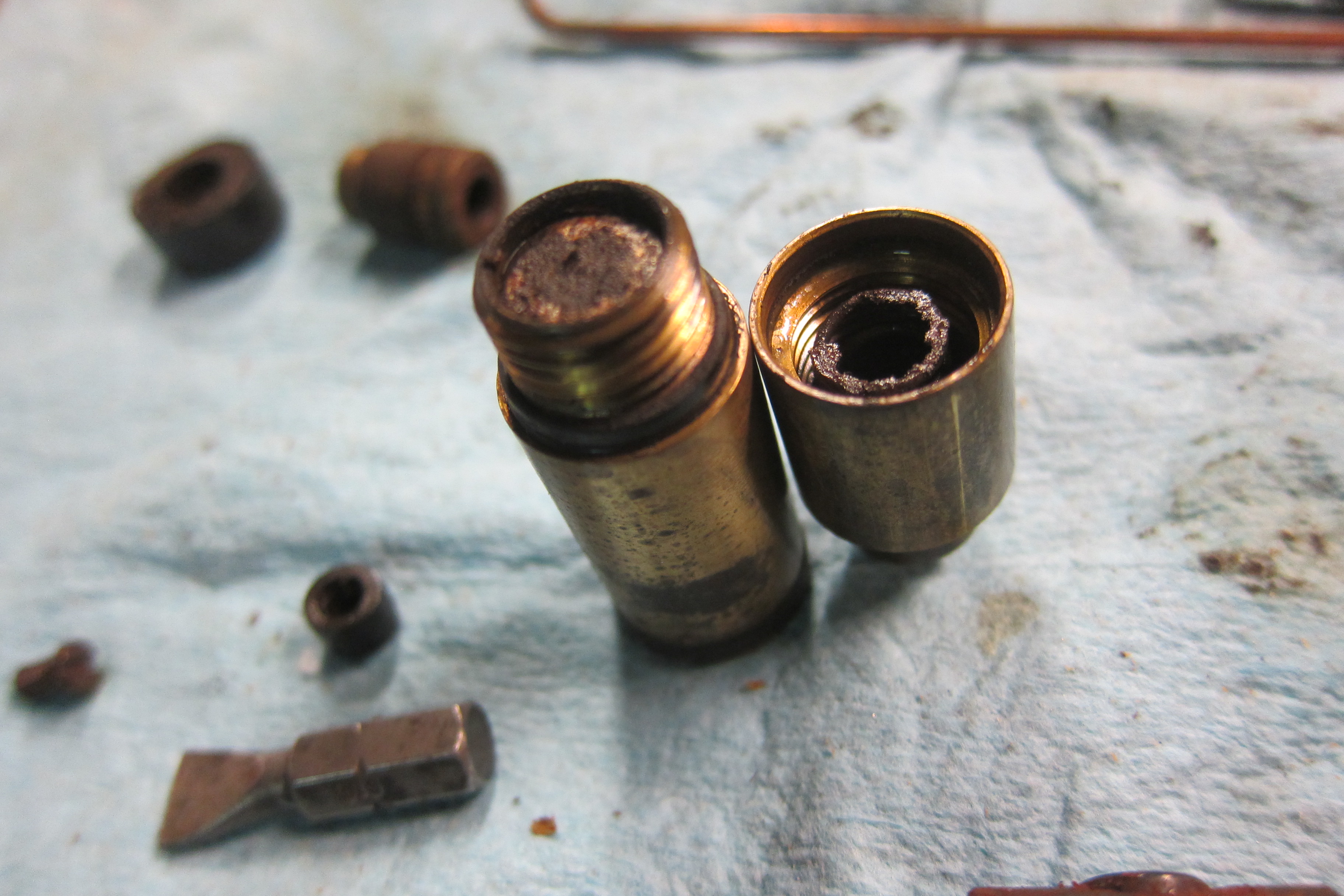

Hmmm, I found another article online that talked about how to pull that 4th seal out from inside the brass cap I do have. I did that and was able to get like 525fps, so I’m thinking I don’t need the piece I thought was missing. This gun is stamped 124, so Dec ‘74?
