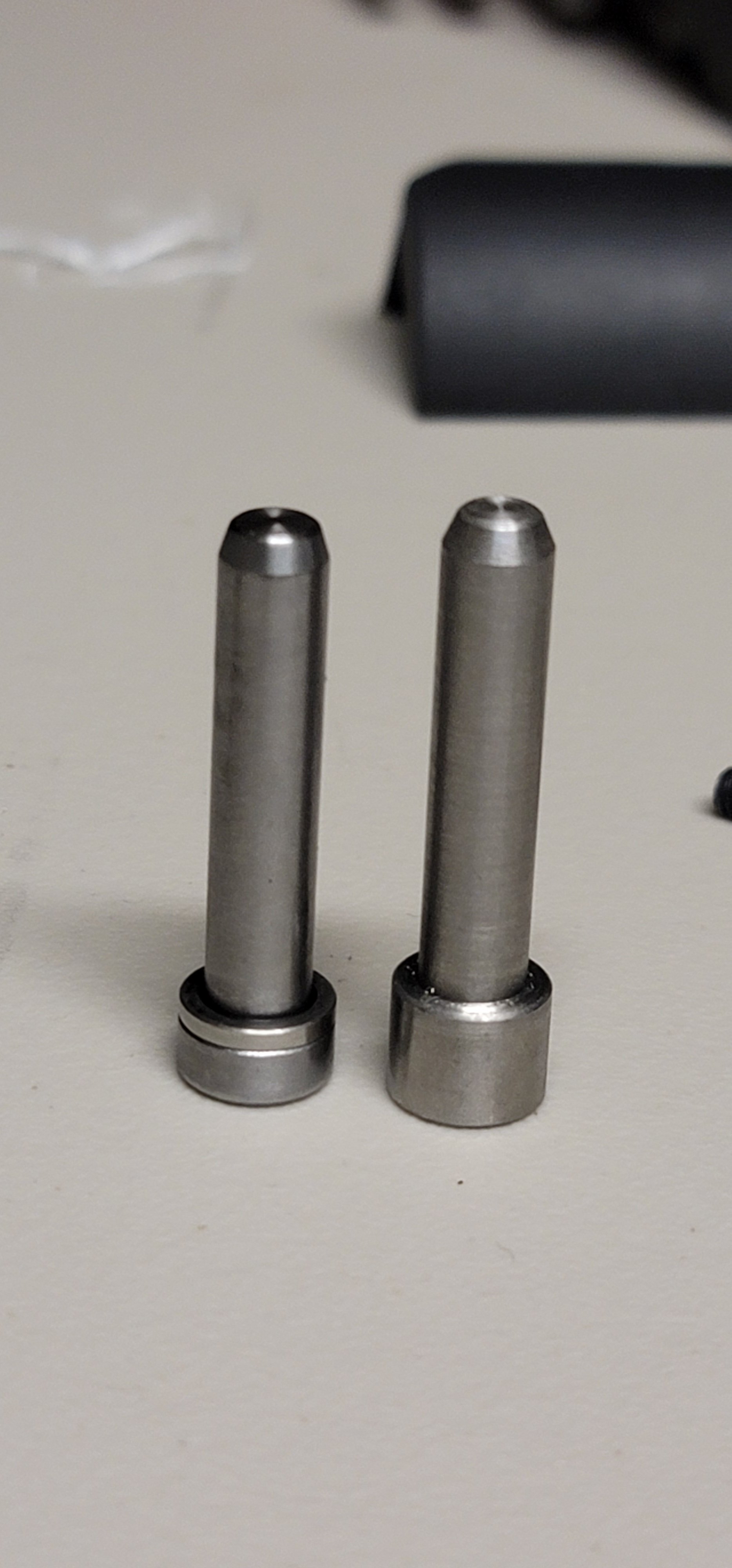

Now you can tweak your hammer spring if needed, but it's best to make sure your velocities always go up as you increase your hammer spring setting from 1 to 7, or you may have to readjust your 2nd regulator lower, or even use a heavier hammer weight. I had to add a heavier hammer weight to my Maverick VP .30cal to get the velocity that I wanted.
