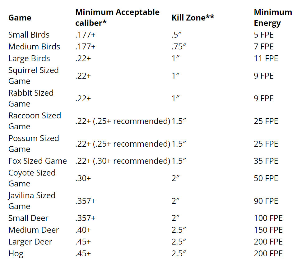

Airgun Depot outlined the minimum acceptable caliber, FPE & kill zones for various game nearly 8 years ago, but it doesn't include iguanas.
It would seem obvious that minimums increase with the size of the iguana and that shot placement is key.
My opinion is that a .22 would be the minimum for an average shooter to reliably dispatch an iguana.
I'm curious as to what some of the experienced iguana hunters would estimate the kill zones & minimum FPE would be.

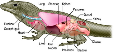

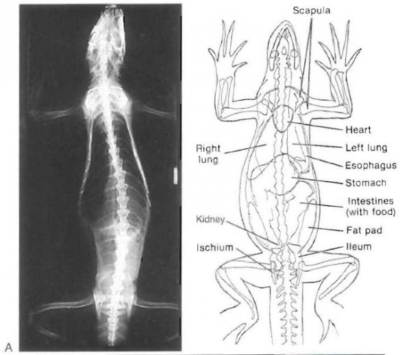

I had seen a post from @Ponsoldt2 that outlined the iguana vitals. Got me wondering what the estimated Kill Zone would be on an iguana.
So you're talking a dime (.75") on either of the 2 spots shown below?
Do you feel that zone size changes with the size of the iguana since with smaller game the ratio of the pellet size is larger ratio of the kill zone?
From : Airgun Depot Basic Hunting Guidelines
