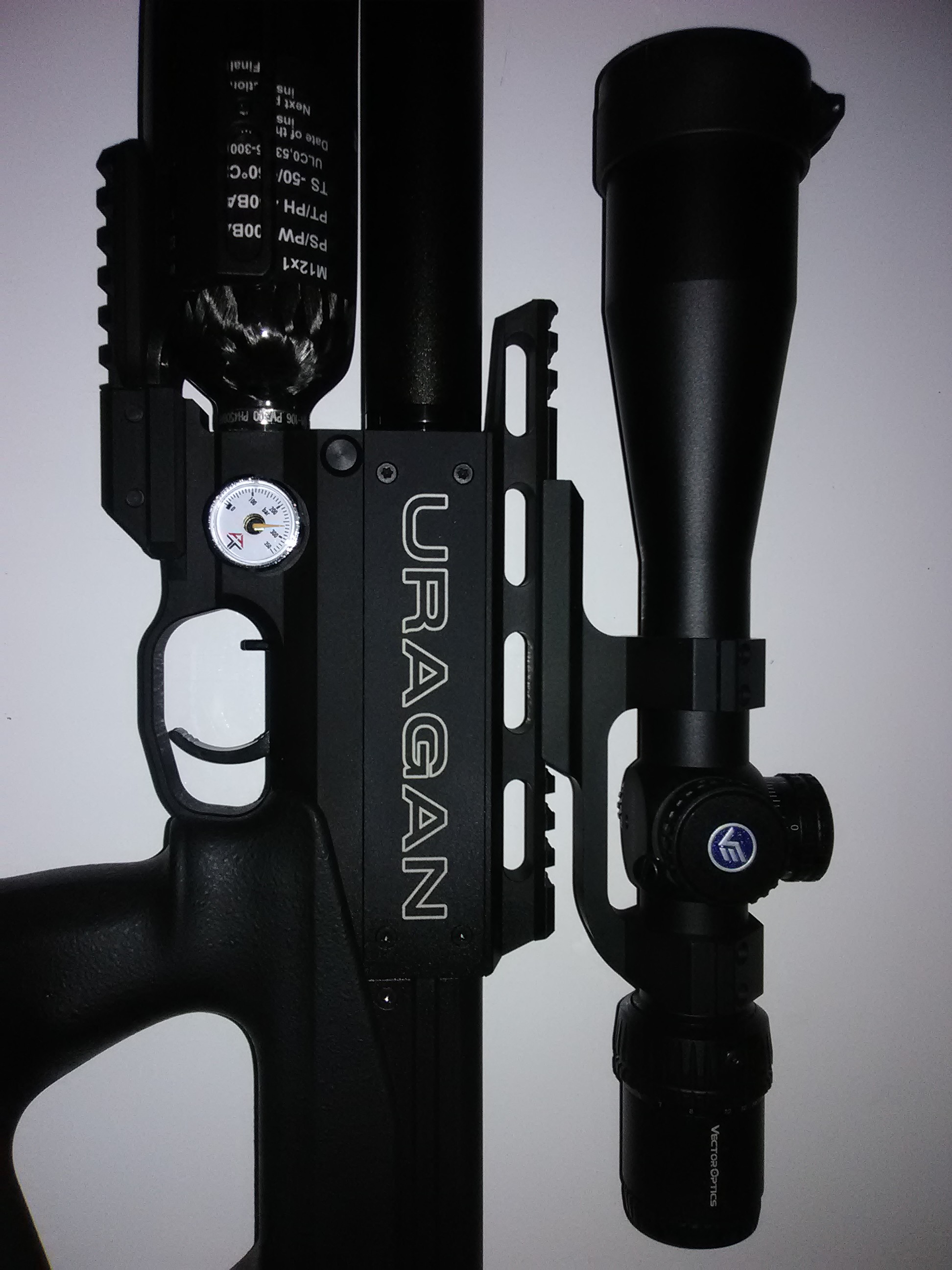

AGT Vulcan 3 or Uragan 2, .30 with 700mm barrel (Synthetic stock). WestHunter cantilever scope mount with Vector Veyron 6-24x44 FFP, Non-IR. Here's the scope set-up on my Uragan .25, same as my Uragan 2, just no pics. WM
