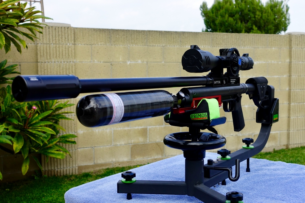

The regulators are here and they are shipping. Soon you will see reviews. I'll take the time with the gun and I'll use it on the channel... probably will do a first impressions video but a more in-depth one will be done after I have a tested the gun and get used to it so I can give a better opinion. I feel I'll have a lot to learn with this gun and for me this is another plus, do you want to tune the gun and be flexible to shot low speed or high speed? If that's what you are after... Raptor will be easier than Uragan. I loved my Taipan but I was feeling that there were things I wasn't able to achieve with it.
So I hope to have a gun that can offer the opportunity to tune and tweak without having to pay 2k for that.
I ordered a raptor mini as Dillon but mine was a .25 cal and Dillon ordered a .22
The .25 was only offered with one barrel a TJ that was designed for both pellets and slugs, I paid $150 extra for the .25 cal option.
I think in .22 you can choose a slug barrel and a pellet one and if I remember correctly Dillon also picked the TJ slug one for his .22
The total amount of my order was 1381.25 including shipping. Which by the way I found extremely expensive at almost $100.

I placed my order in September 21... don't ask Dillon... he is my hero for being so patient with his order. Originally JSAR was shipping the guns without the regulator that will be used on the final product with the promise that after the regulators arrived they will send them to those with the old regulator.
Dillon opted for waiting for the gun with the new regulator and was waiting I think for almost half a year...he can correct me if I'm wrong. Those Ninja Regulators took an eternity to arrive.
As I said before the Regulators are here now and guns ate shipping. I don't have confirmation that mine has been shipped yet but really hope it will soon.
