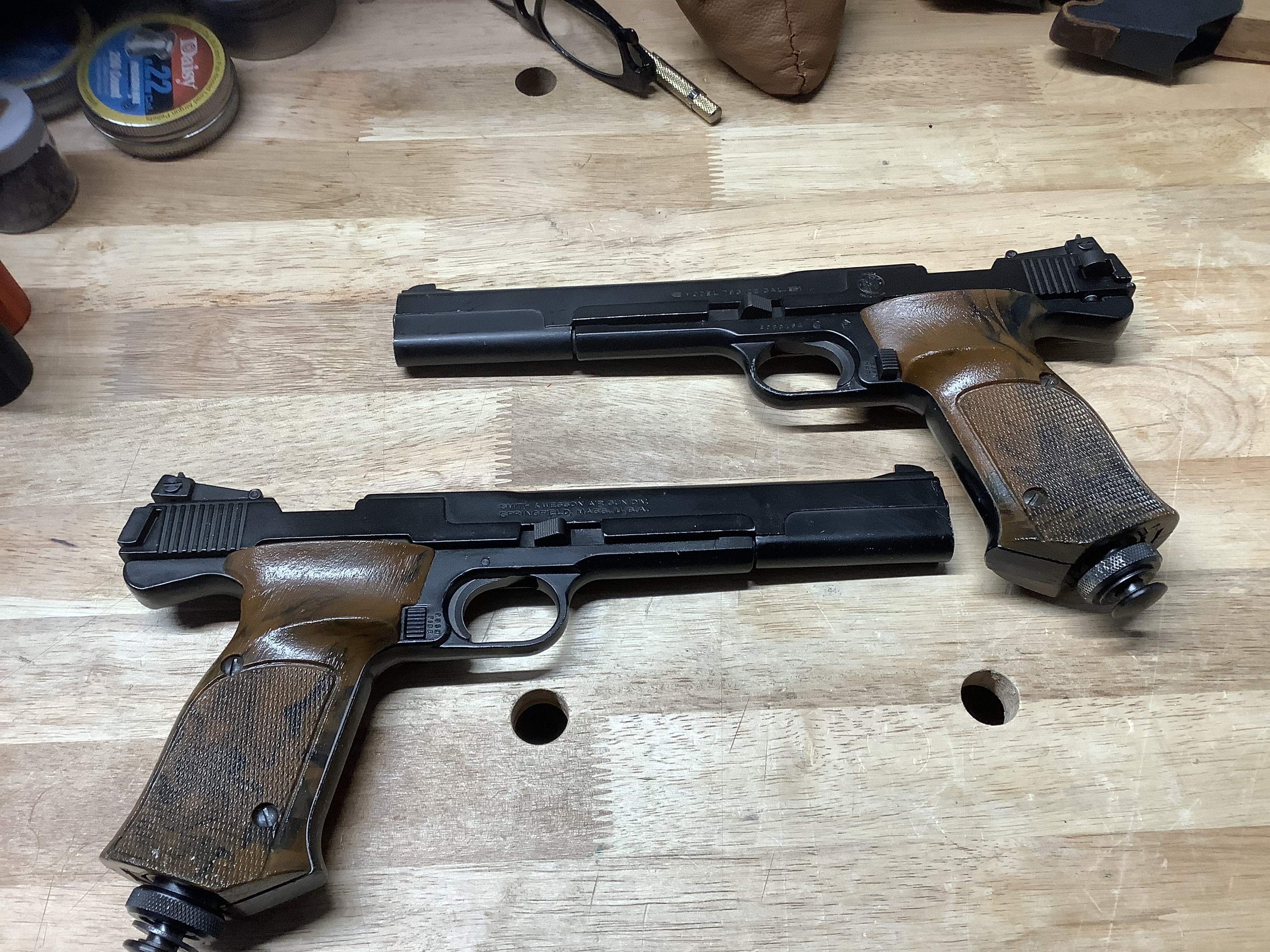

Out of ALL my pistols, co2, spring, pcp or ssp, the one that would keep is my S&W 78G.
Another good choice

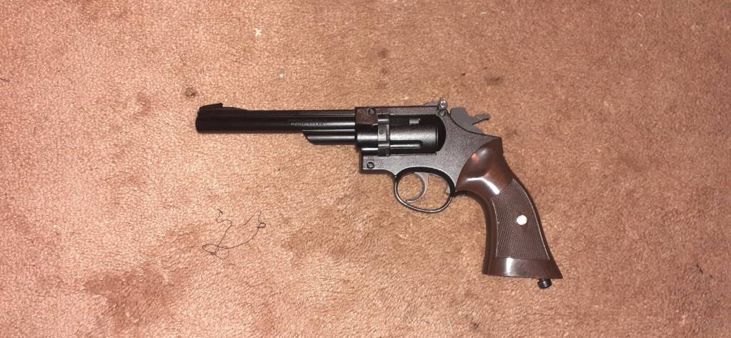

My pick would be a 38T .22 the reasons. It's a .22, very fun to shoot. Accurate single action, a great trigger not bad as a double action. The history behind the two models. It almost all metal construction. The gun is not complicated to repair. 5 easy mods for it. The revolver has the weight, the size, the correct grips, the adjustable sights, firing action and all the features in which the pistol it replicates.
Oh did I mention how much fun they are?View attachment 341365

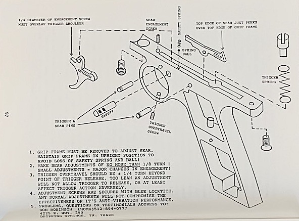

Any chance you could provide information on how to do the adjustable sear?
Sorry I haven't gotten to this sooner J, but I've been too sick to do anything but sleep since your post.
Anyone using this information to modify a trigger does so completely at their own risk, and cannot transfer responsibility for any shortage of common sense to me.
You're looking for the sear engagement screw (top) and trigger over-travel screw (bottom). I consider the over-travel screw almost a superfluous option; the magic lies in the sear engagement screw. Placement of either is critical.

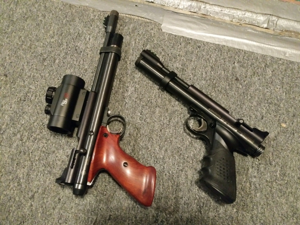

When i replied to this thread I only had one.
Well this last weekend was a legofest where several Crosman products shape shifted.
The 2240 has a very mixed up history, but this configuration seems best. As a pistol, I shoot this much better than my 1701P.
So the 1701 is now a carbine.
The barrel is from my 1300kt, the grip frame is 1701P.
So that makes it a 1741 I think.
Corcoran walnut grips.
