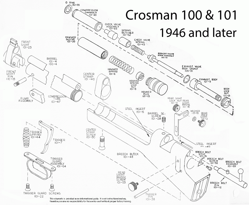

General Diagram of a 101 disregard years as basic components are the same as the older 101s, just newer ones have updated/improved parts:
Problem area is as follows:
Breech block (101-48) the interior female treads on this part are stripped so body lock nut (101-15) will not hold exhaust body (121-5) in place and comes out when up cock the gun (hammer assembly) parts: Hammer sleeve (101-39, Hammer Spring (101-8) Hammer Spring Lock (101-5, scres onto stem of exhaust body 121-5) and Hammer Plug (121-15). Due to stripped out breech block threads all of this comes out when cocking.
