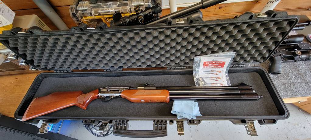

My .50 cal leaks air and I don't know how to fix it. The gun has the tripple barrel and the air leaks out the middle barrel at the end next to muzzle. I'm sure there is an O-ring there but I can't figure out how to take it apart. The spanner nut is tight but I can't get the center plug unscrewed.
It worked great about 6 months ago but today the air was empty. I cocked the gun as stated in manual but that's a joke.BTW....it is very difficult to cocked this gun in the high power setting.

Where the pen points is where it leaks. Seems like it should be an easy fix. Don't think more than a dozen rounds have gone down the barrel.
If it's leaking from the center tube the burst disk is leaking/let go. It's built similar to my Sumatra and all I did was use a metric Allen wrench to remove the cap over the burst disk. My middle tube end nut was so tight it ripped the nub that engages the hole. The large nut came off a lot easier. I ended up modding a spanner wrench that came with my hand pump by grinding off one of the 2 nubs.
