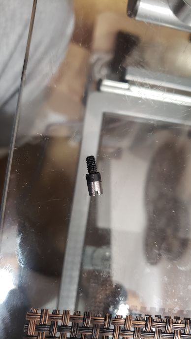

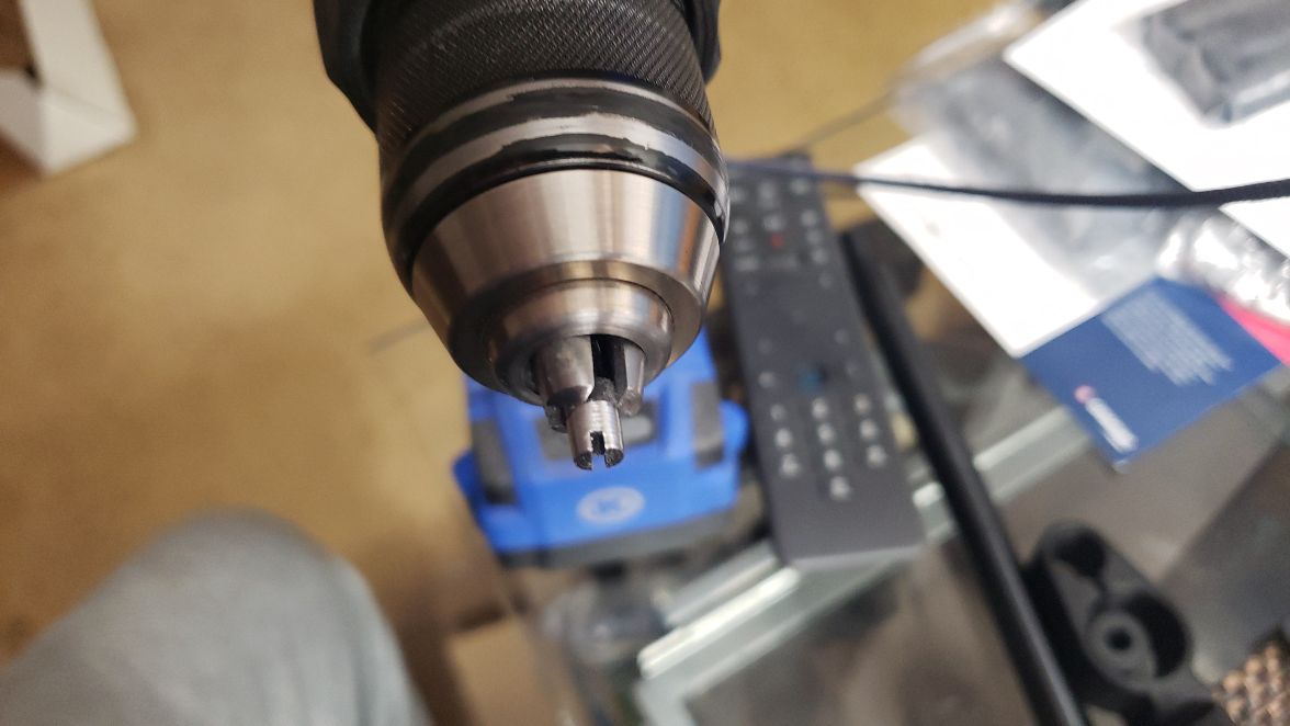

Can you post a photo of the part you had to turn down (reduce diameter?) ?
Is it the bolt or the bolt handle?
Once you remove the breech from the ICON on top of the hammer in the tube on the ICON you will see the lug bolt that the bolt pushes to move the hammer. The slot in the 1100Z breech is narrower than the ICON breech so you need to remove the lug bolt place in a drill (poor mans lathe) and hold a file against it to reduce the circumference so it fits the 1100Z breech. Not hard to do look at the images of the bolt and you will see. If you need more info let me know.

Did you message them for the non warranty return parts ? When they responded to me they asked if I was aware they were no warranty off returned rifles and I said yes. They then will check the returned rifles and send me an invoice to pay. I am thinking of doing a .25 caliber ICON if I can find all the needed parts.
I bet the beeman 1359 barrel would drop right in. The bolt may be an issue, and you could possibly sleeve it up to 25.
