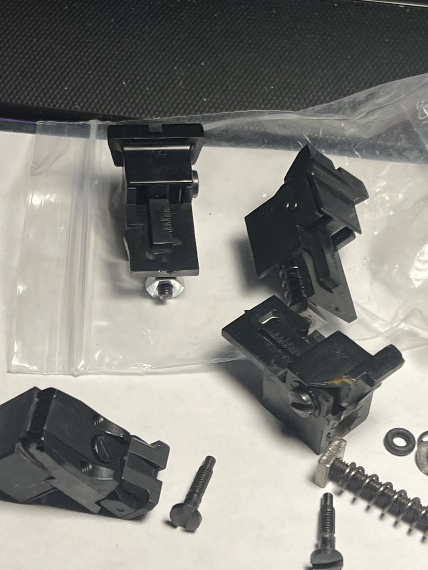

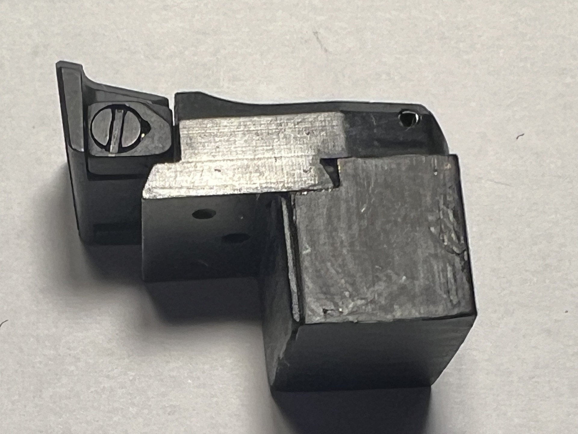

look here for some ideas about a rear sight.
so, if the sight is broken at the bottom just clean up and epoxy together and how the hell that could happen is very interesting
i will tell you reality of the sights
that--had-- parts available to fix the sight but the upper part of the sight can not be taken apart it goes together but doesn't come apart because the washer they use
i have made sights that are made from and Ruger pistol sight and a 1/2 x 5/8 pillar
you will see in the picture that what broke off is a plastic spring component of the base
you see the sight that i made up clam shells hold it in place and sight stuff
i have taken these apart and it is a royal PITA and without the clip being available because you will have to cut it off you are screwed and i bought a box of star washers and never found one JUST RIGHT

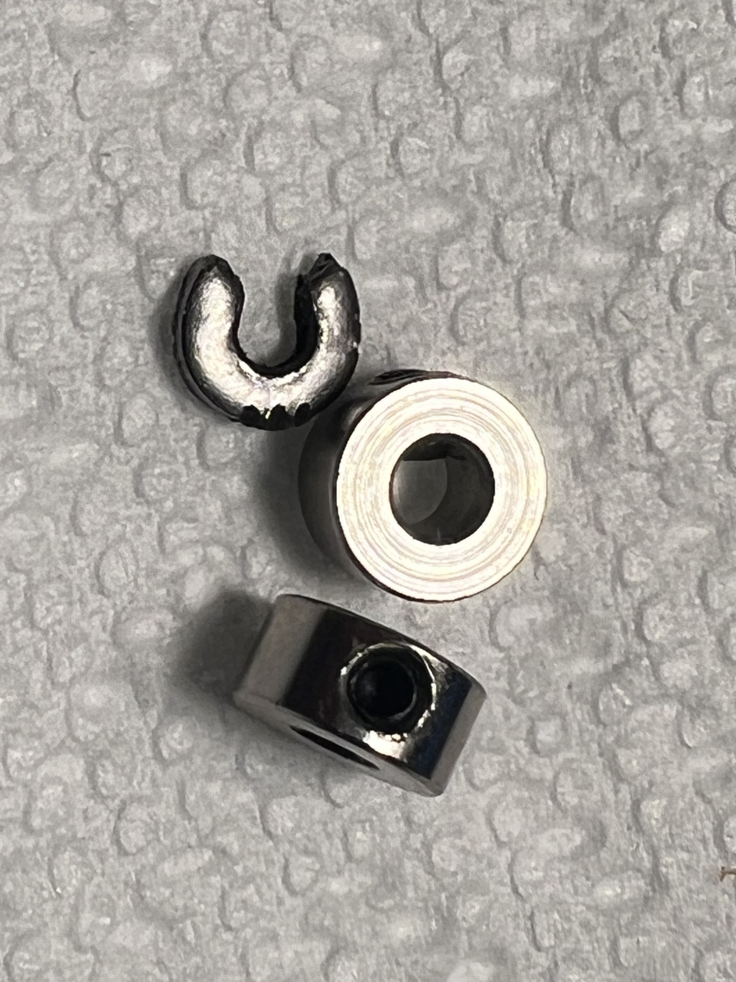

now a picture of the collar works great it was bought on ebay and the ID is 3.03 mm

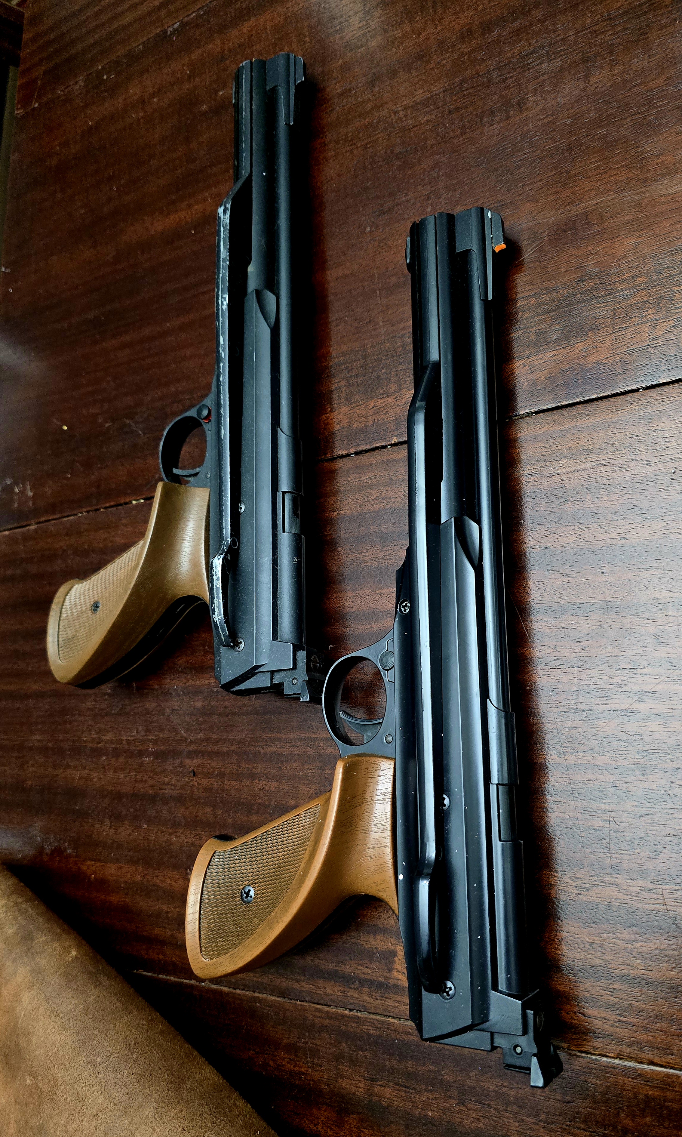

My old 747 and the recently gifted, beautiful 717.

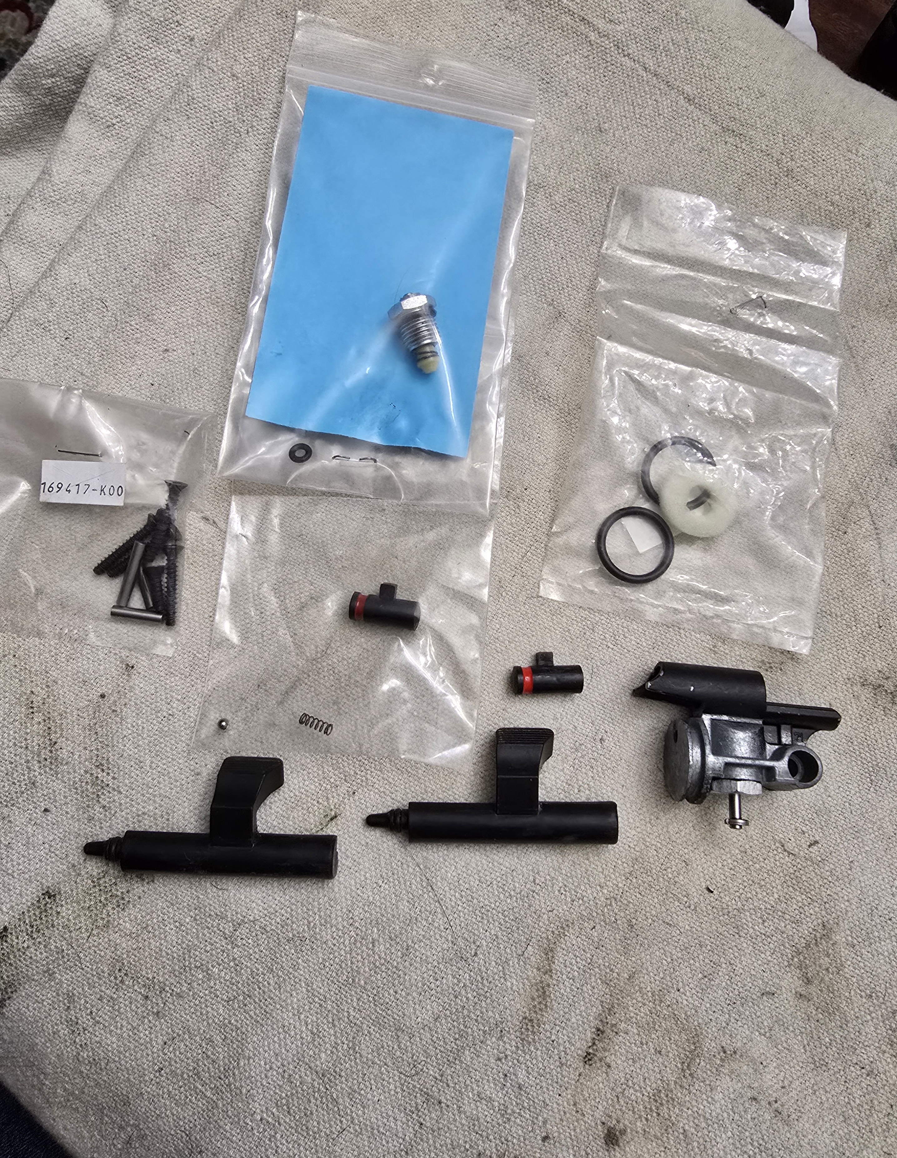

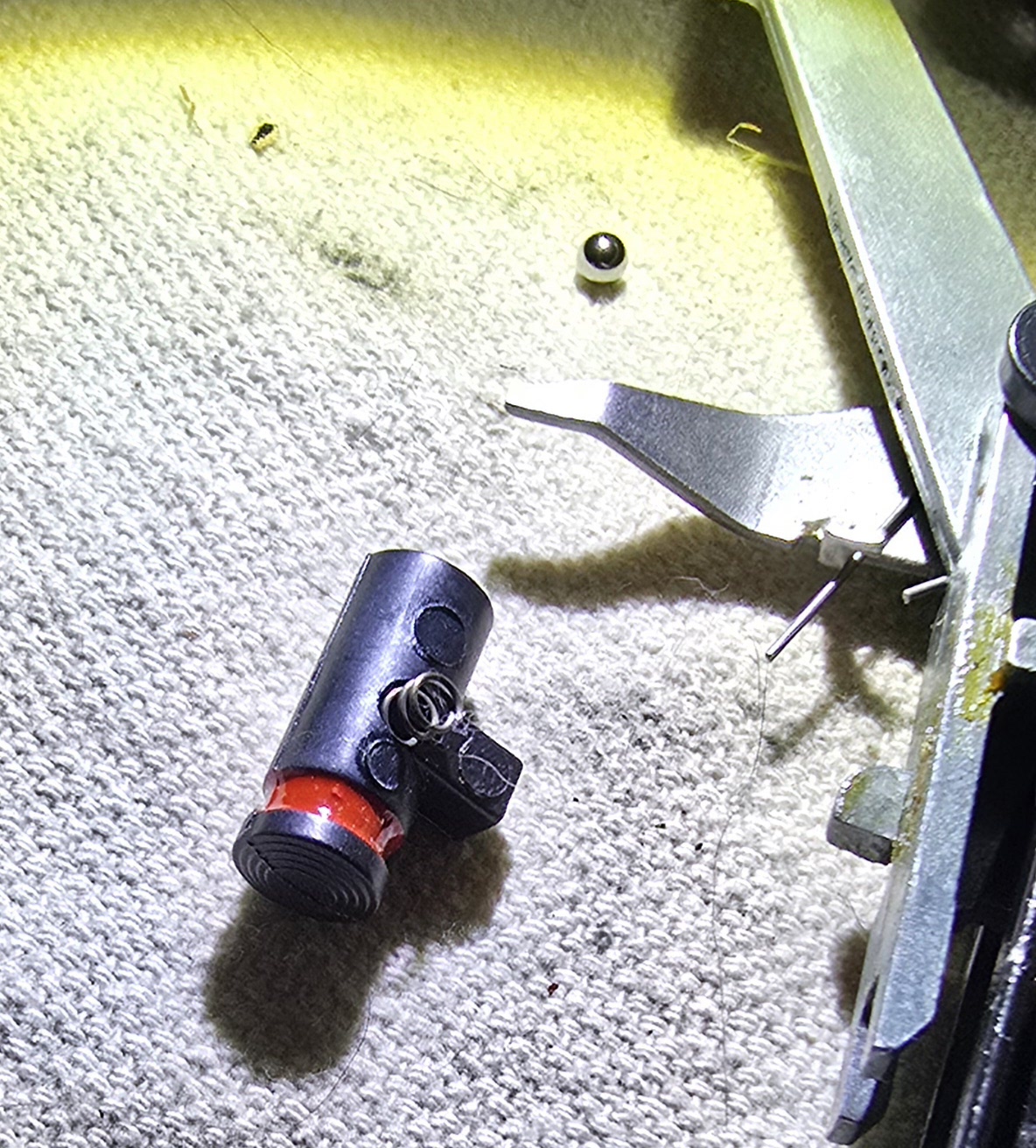

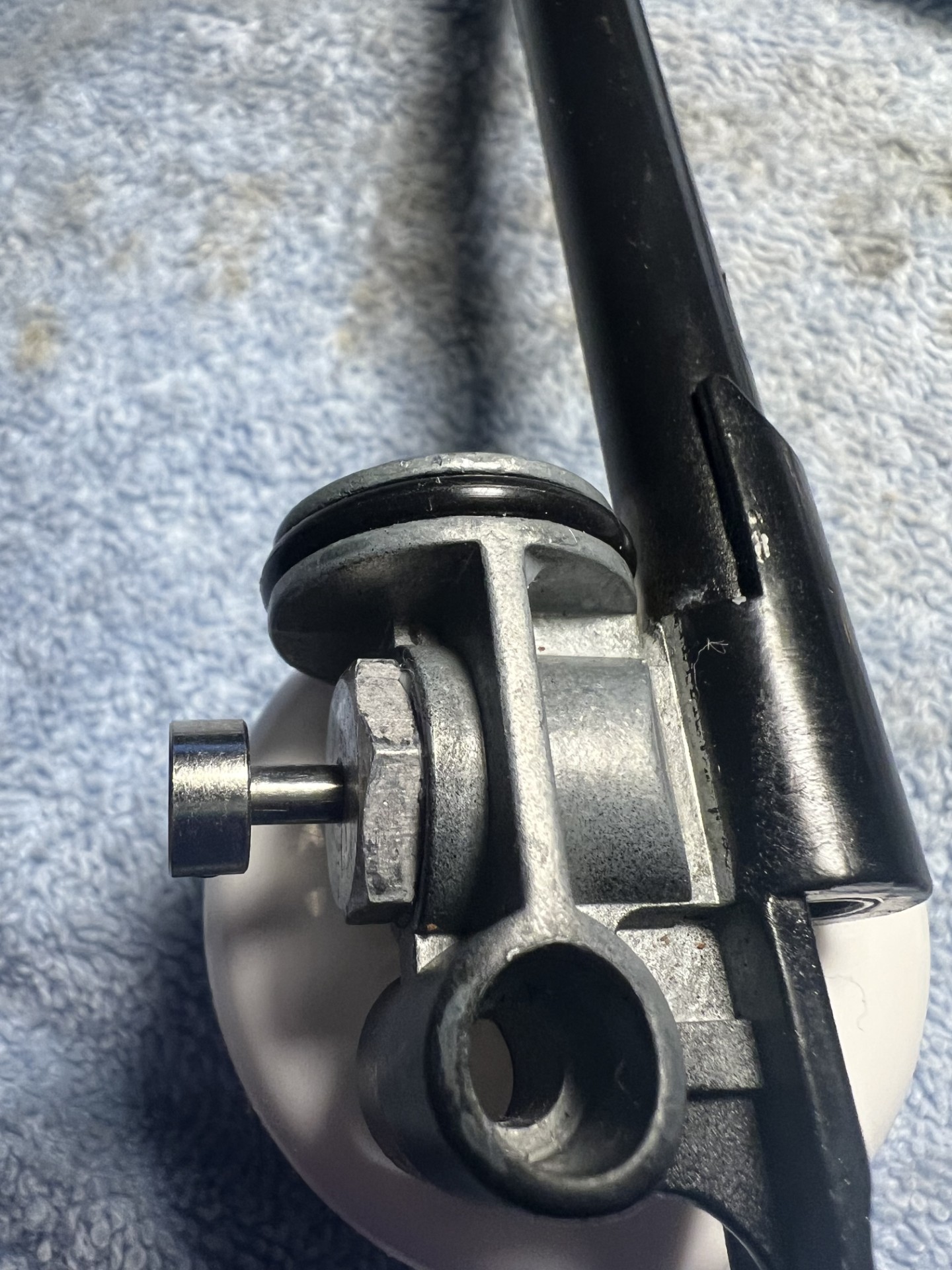

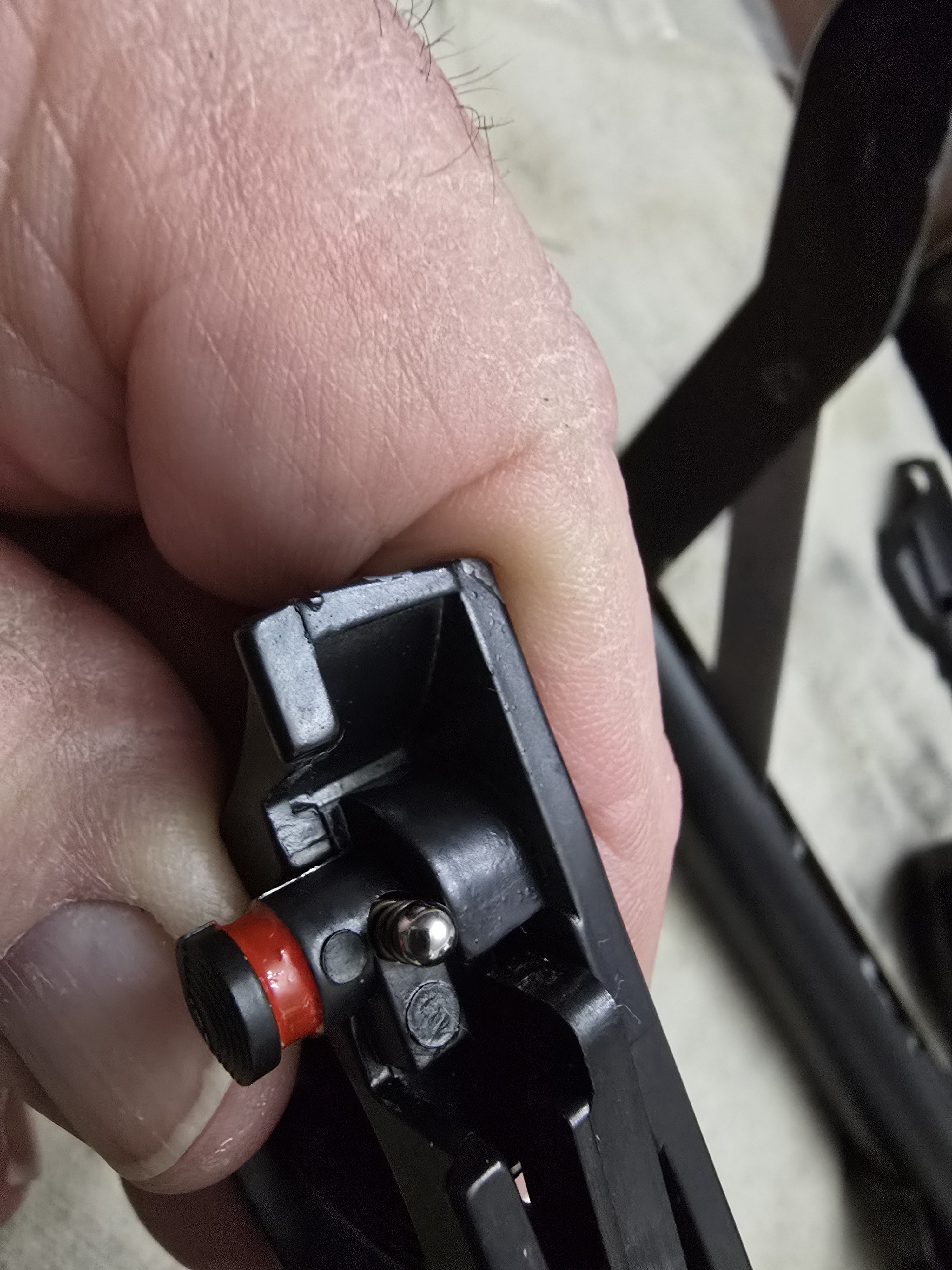

BTW I took a pictures and videos, while I was into my 717 if you're interested.
I thought that I had a trigger problem opening the valve, so I disassembled it and inspected the trigger which looked fine.
The gun came with these parts, so I changed the valve for a new one that was still in the bag. The new one was the same as the one in that was on the gun when I got it. I also repaired the safety.
