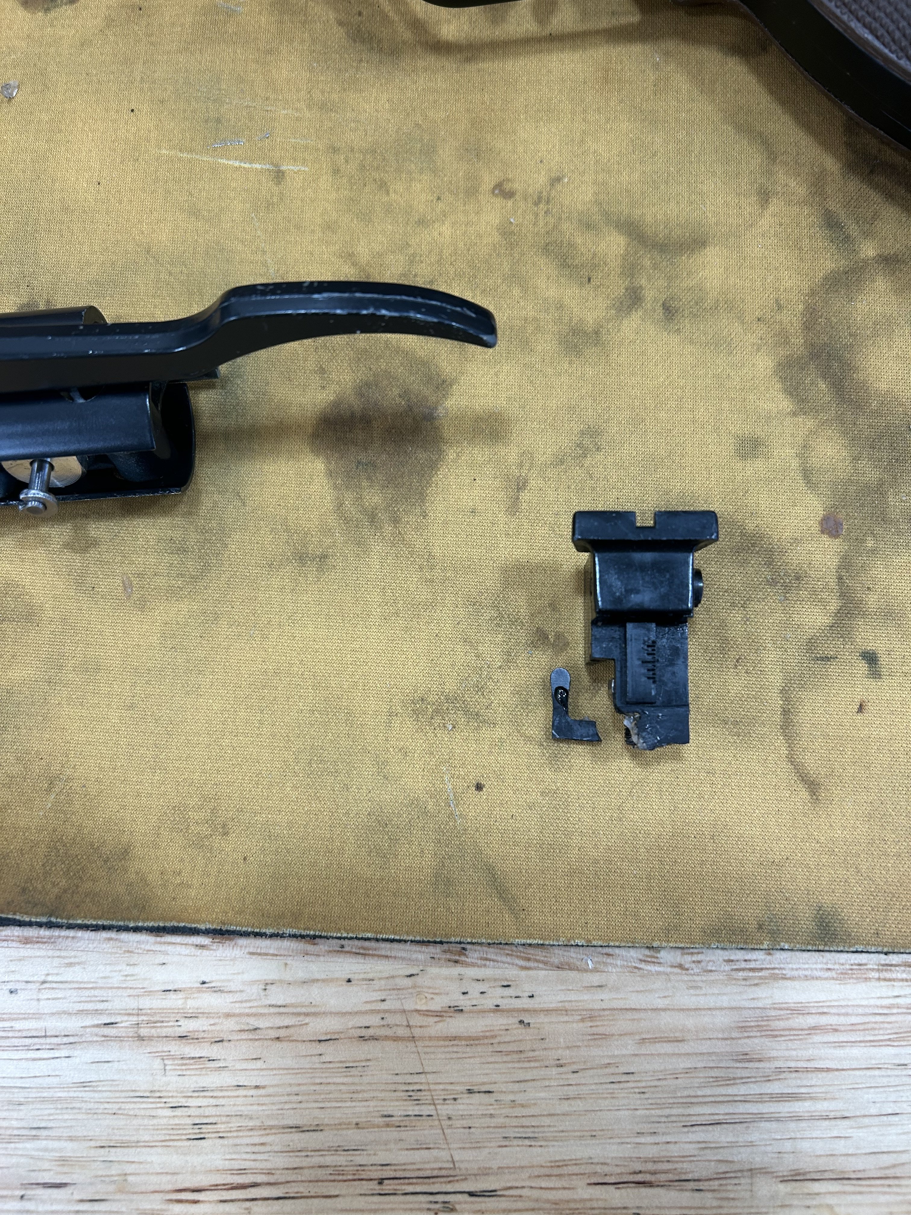

More worrisome is a little piece of plastic that looks like it broke off the rear sight....there is a tab that makes a right angle heading back up the rear sight base.

Parts for the sights are no longer available, I have seen where some folks are 3d printing an adapter to use some kind or pistol sight, like used on some of the Crosman CO2 pistols with adjustable sights.
the good news is the 717 is easy to work on and what you see is the oil wiper that has fallen apart
the rear sight are no longer available i would need a picture to help to advise

please pardon the glue residue....i tried and failed to repair it....this is the rear sight unit

I cleaned the parts and at first i tried some cyanoacrylate glue...which didn't work so i then tried E6000 glue....which unfortunately also failed.
I will try to call the Daisy company as well...maybe they have spare ports?
update: just called Daisy and they no longer carry parts for that model.
