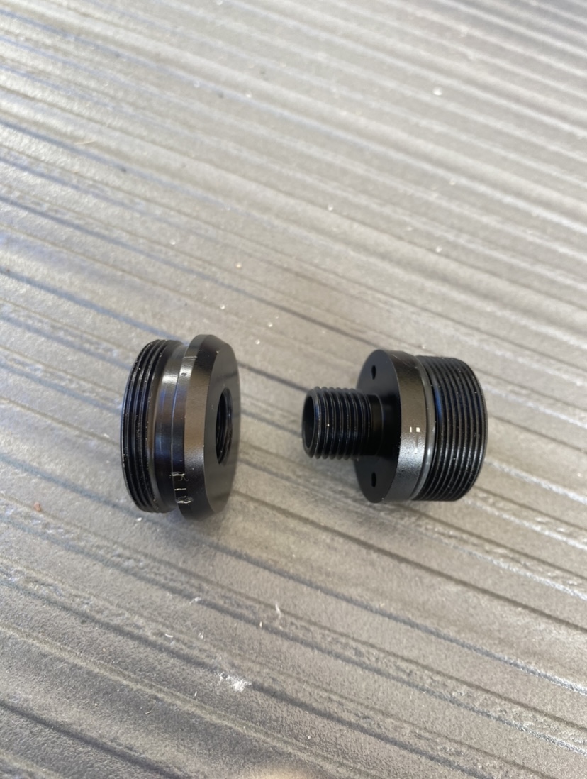

Try to wrap something around the part before clamping down on the part with a vice-grip.
I have a piece of a timing belt that I use and man, that thing has been to hell and back and still works like a charm. It grips well without leaving a mark, but piece of rubber or a piece of leather or even a thick cloth will do.

I used a thick rag between the end caps and the vice grip before clamping both but as you can see in the pic, it was useless because no matter how much effort I tried to make they were always marked…🤷‍♂️🙄
