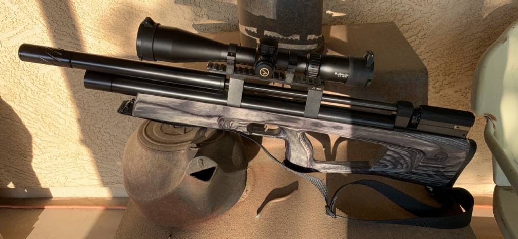

I have a 177 Regal Huntsman, it wears a Huggett Beletta moderator (120 mm). I also have a 22 Taipan Standard. I read how quite the Taipan was but it was not quite enough for me compared to the Huntsman with the Beletta. I bought the Huggett Atom (89mm) to use on my Taipan. I also have a 177 Wolverine with a 0DB moderator on it. The Taipan with the Atom is the quietest. In my opinion for what its worth the Atom is the best looking moderator I have seen on Any Taipan. I don't like the can look on the end myself.
edited because I can not spell

  1. that is correct at my house and my ears. The Taipan is also the most accurate of the three. But there are days that I shoot the Wolverine and Huntsman better because the rifle configuration is more forgiving than the Bullpup. But I grab the Taipan more to shoot because of the compactness. It wins as my favorite for all around shooting, pesting and playing.
    edit auto correct changed testing to besting.

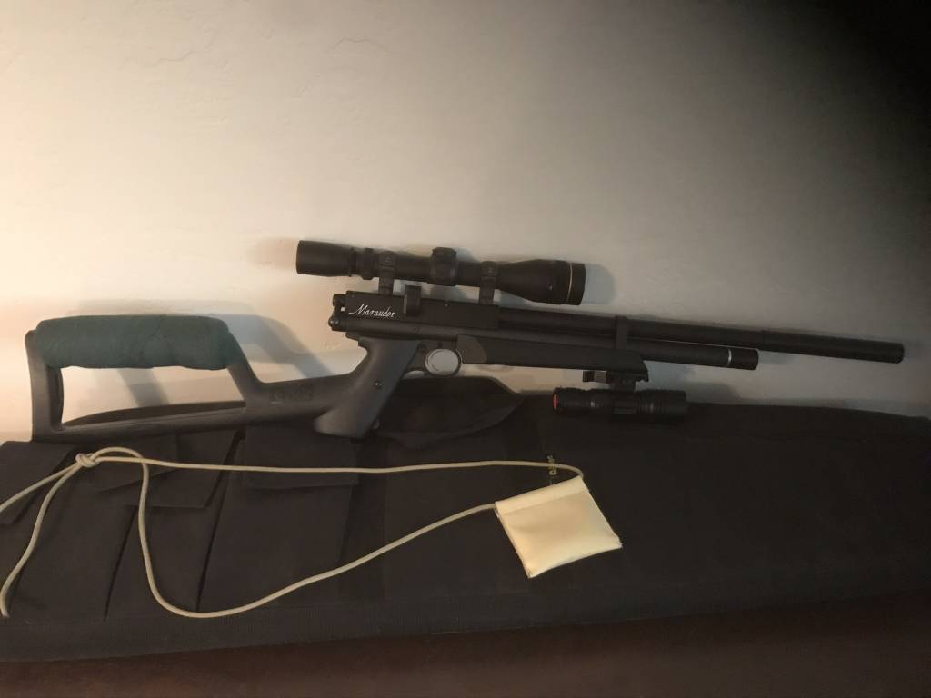

Wow such advice,all good to know......But,what do you like in Air gun?
There are a lot of bull pub answers,is that something your interested in?Do you think you'll like style?
I have a P rod carbine,Prod are all .22 cal.....I love it,also have it in pistol form,again I love it.Plenty of mods out there to quiet in even more.
For me I do not like Bull pups...much rather have a old style rifle.
Get the Huntsmen.......with the a Huggett .
And another thing.....why not just quiet down your already have Marauder...you already have it and if you like it Keep it and learn from it
Too many enableers,too much confusion...You got to think about this....you ready to spend $1500+ on a something you may not like.
Get the Prod for now.....Sorry,I see you want to drop a raccoon at 50yds,ok keep your Marauder and use it .
Maybe the question should be ,what is the best way to quiet my Marauder.
