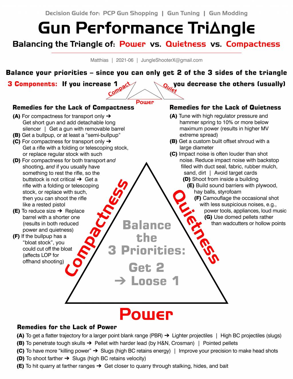

Thank you. I think I have selected those parameters throughout the thread, though I can gather it all in one place below:
Caliber: 22 cal is adequate for my needs.
Platform: I do not care whether bullpup or rifle because I am not concerned with what I hear; I am concerned about what someone 10-20yds away hears. I have read that bullpup mechanisms are more complicated and thus carry greater risk of failure. Is this true?
Power: Just want to reliably drop up to a raccoon at 50yds.
Accuracy: Sure, 5 shot group <0.5" at 50yds in good weather is very acceptable
Length: I can deal with anything that has an overall length of up to a 22 m-rod (43"; 20" barrel) but not a 22 m-rod+sumo (49.25"); a taipan vet long + sumo is fine (31.5"+6.25"; 21.6" barrel), as is a DRXL (36.5"; 17" barrel). I guess a long barrel bullpup would be the way to go.

Simple question, I think. I recently dove into PCPs and bought what I thought would be among the quietest airguns for suburban backyard pesting: a .22 Marauder semi-automatic at 900fps. It was louder than I had expected from online videos. I did not notice any difference in the noise level with a DonnyFL Sumo. Turns out, the semi-automatic mechanism dooms it to be louder than the bolt action Marauder.
I'm thinking of taking a step up from the more entry level Marauder line to a Daystate Huntsman. Question is, will a Daystate Huntsman Regal XL be noticeably quieter than my tuned SAW? Or would a DRXL+Airstream or DRXL+Sumo?
Thank you, in advance.
edit: Put another way, are there any other options out there (with or without a moderator) that get much quieter than a 22 bolt action mrod?
All the options here are good, but out of all the AG'S I use, Taipan, Kral, Mrod, to name a few, the absolute quietest is Airforce TalonP with DonnyFL. This compact carbine set up at 60 fpe with OAL 39" it's absolutely silent until impact of pellet strike.
For clandestine urban pesting easy to dial back the power to reduce the sound of pellet strike.
Really like the fact that I can break it down and pack into backpack, especially when having to travel through areas where treehugger non hunting types are hiking or fishing in are around, but can easily be deployed for targets of opportunity.
