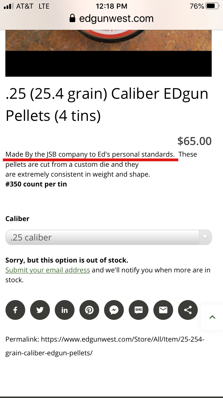

I did notice this on Edguns website. Read into this as much as you like.
