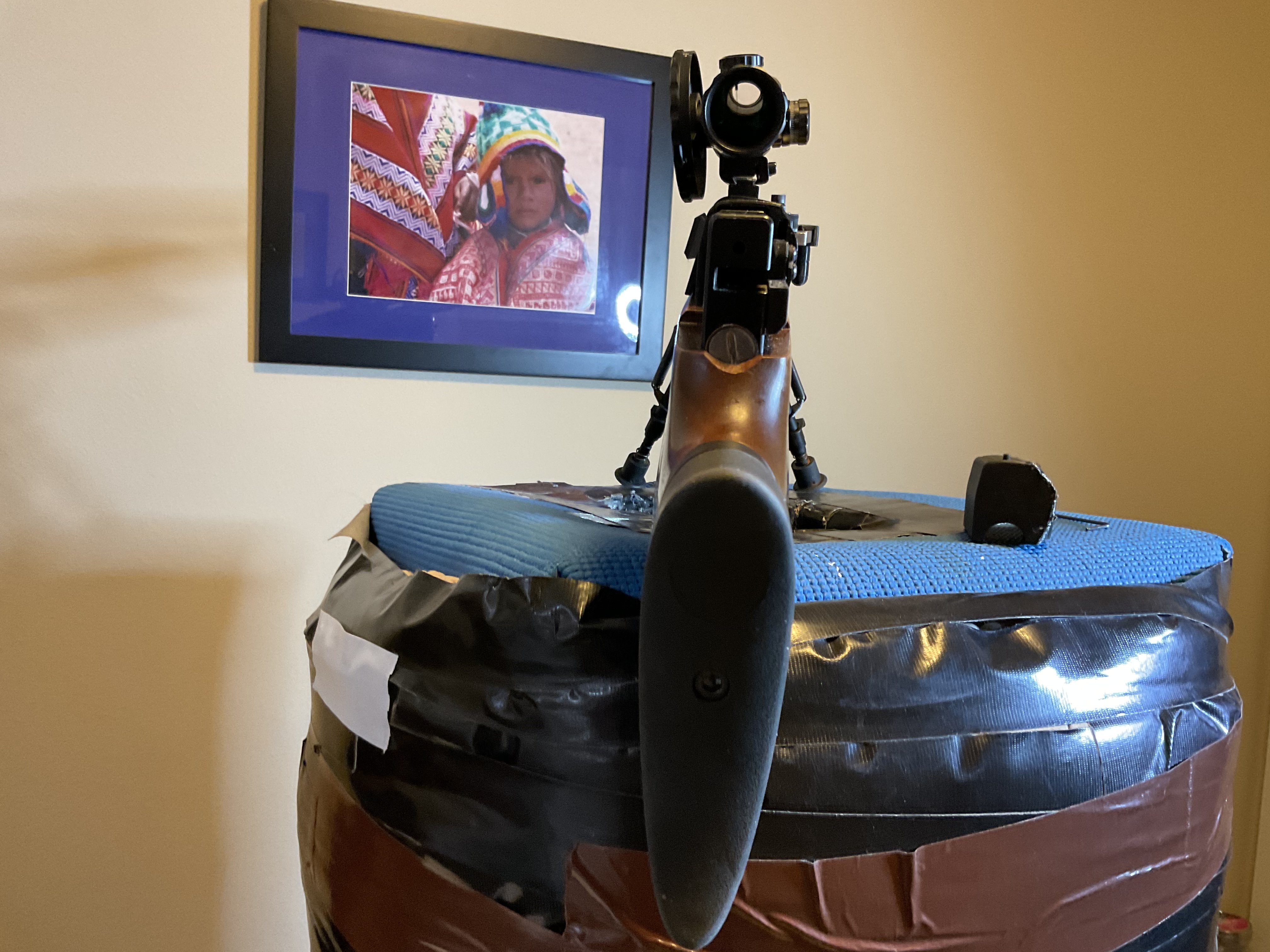

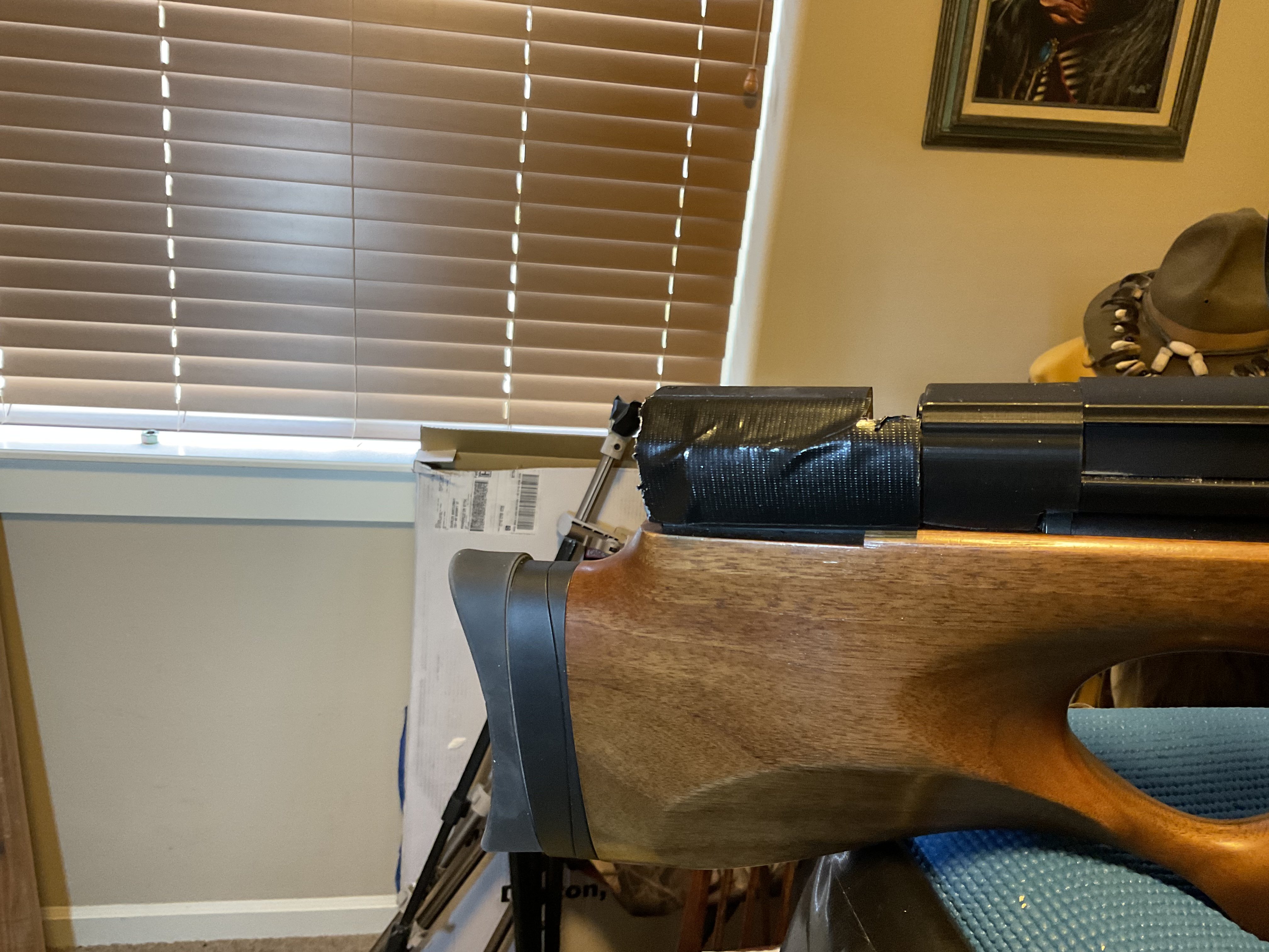

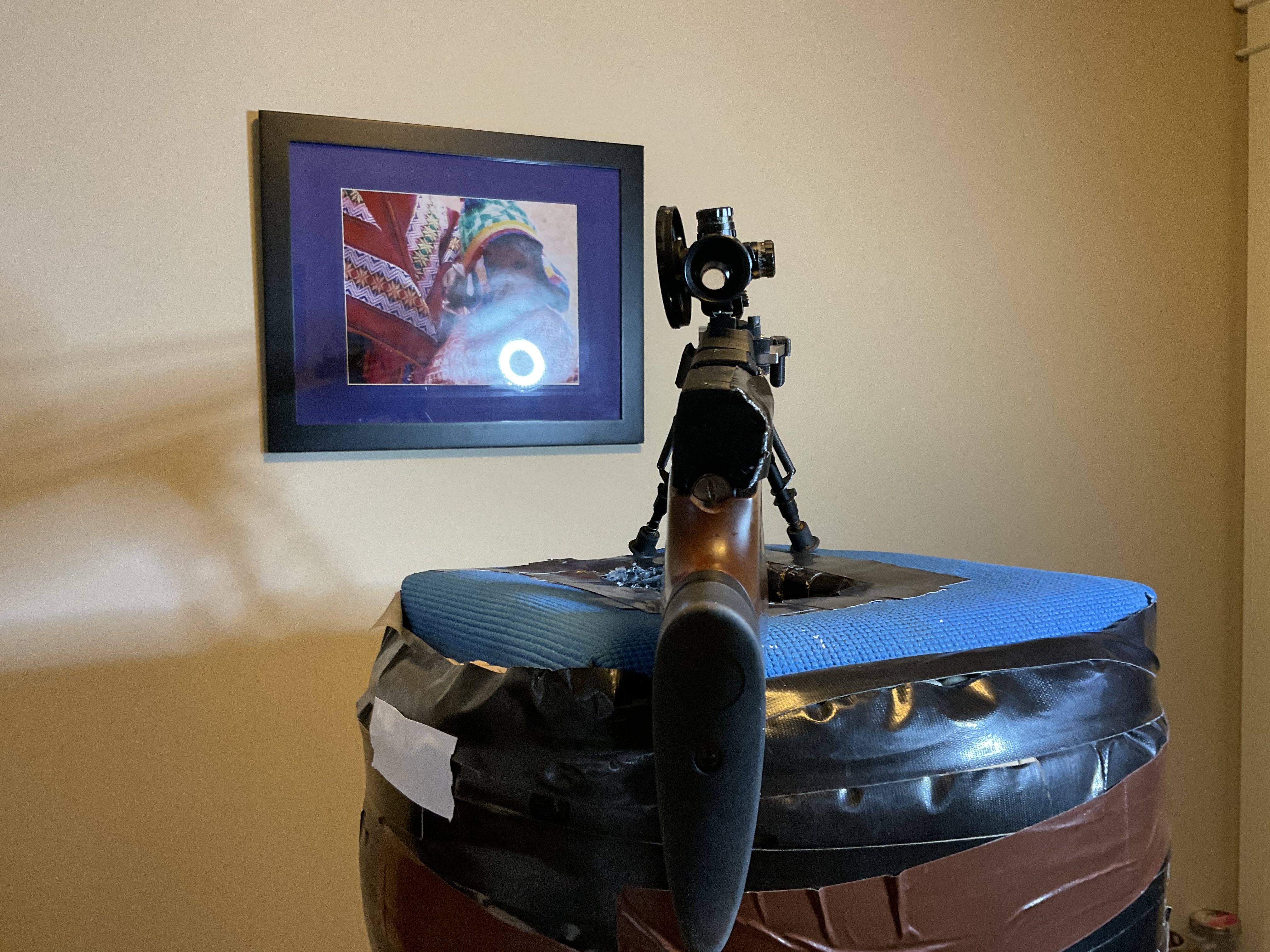

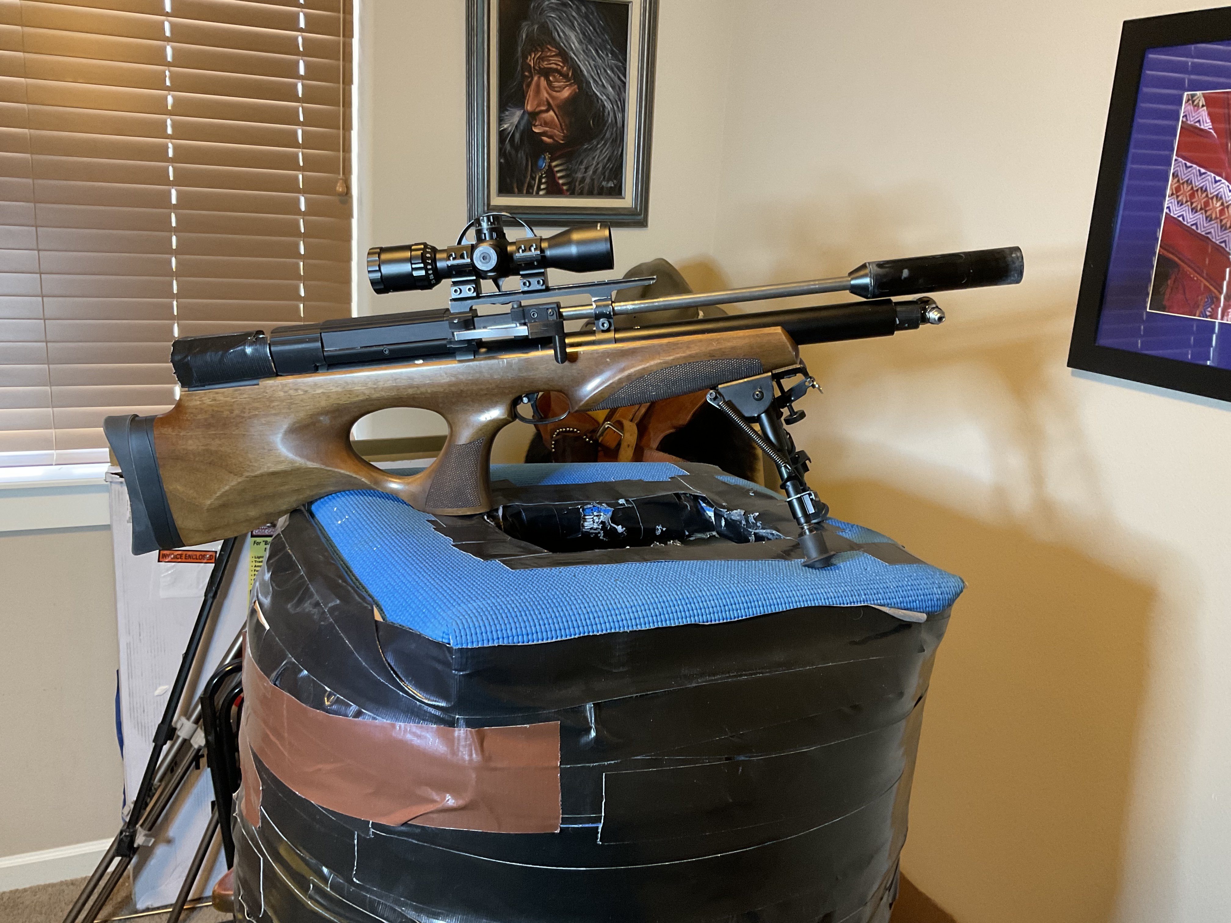

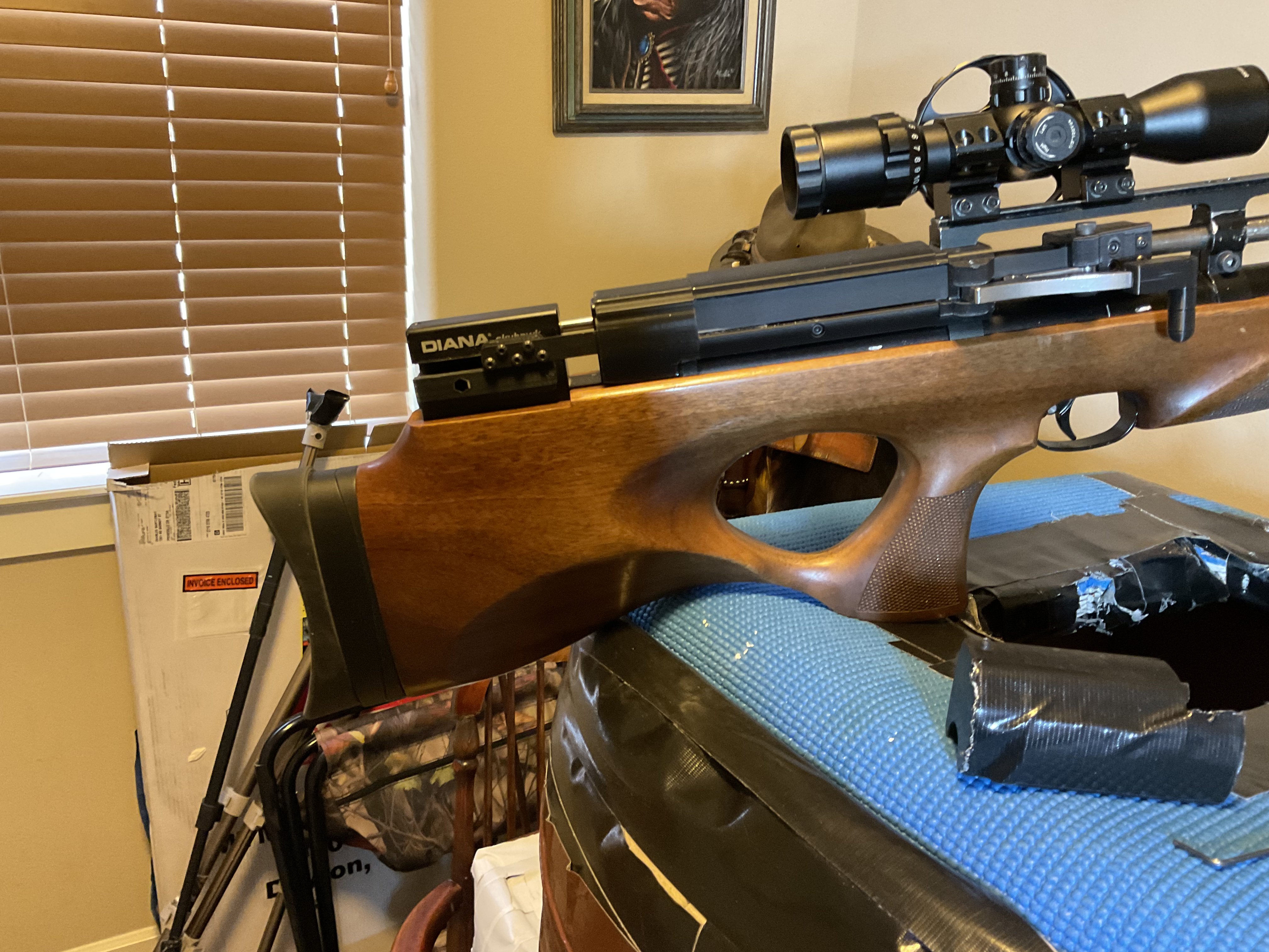

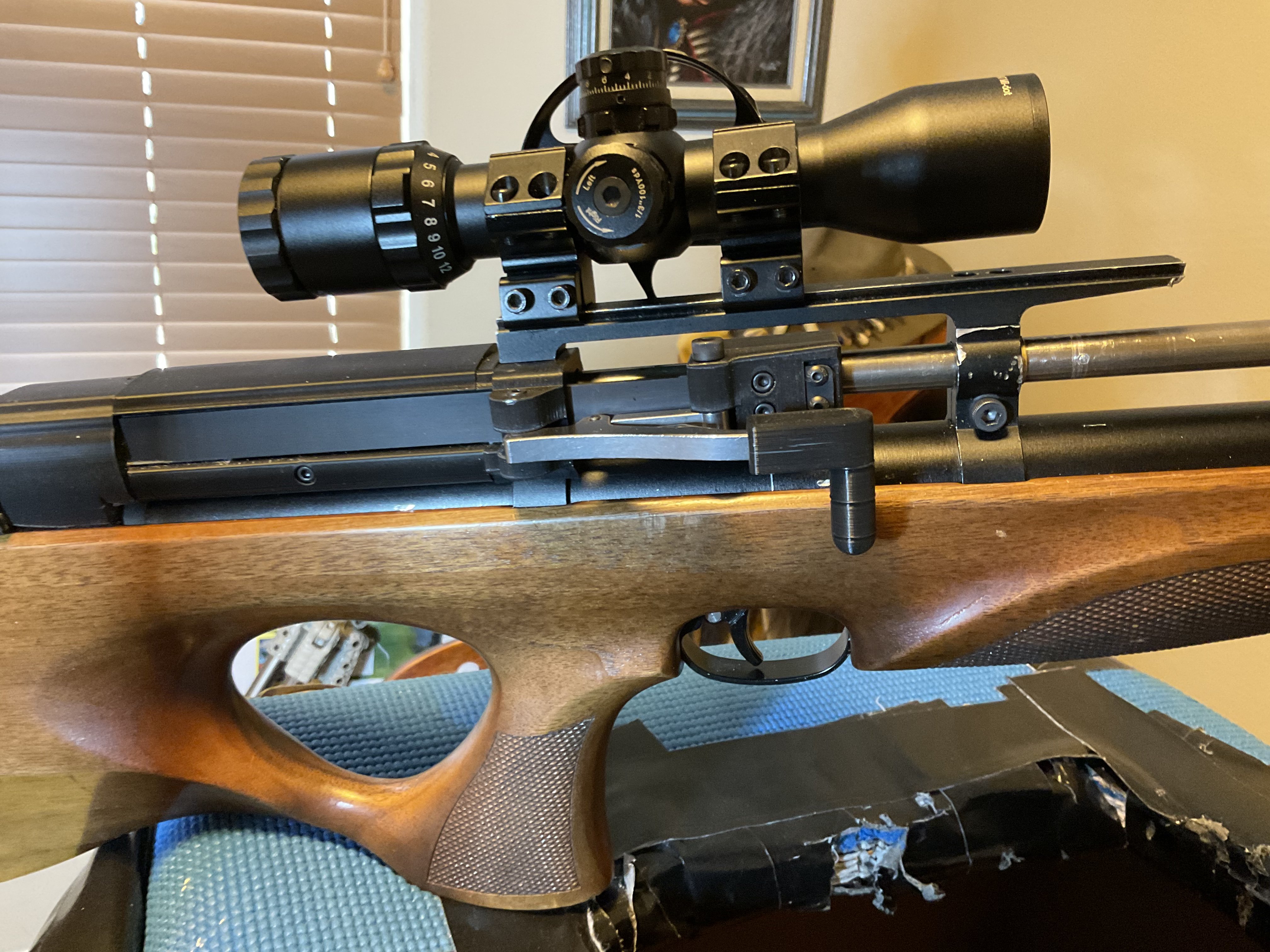

The lever installed so far.
It is very difficult for me to read and see pictures with my vision failing, from a dying optic nerve, and I made a mistake in the installation. I did most of the instal in bed as I have been bed ridden the last month, but healing up now.
The misstep was putting the cheek piece back on, that came back to haunt me in the end. While trying to instal the last part, the cover for the rear of the receiver, I ham-fistedly, (maybe not a real word) broke part #7. The part was well made, my attempt to instal it was all wrong
I have purchased a replacement part and taped the pieces back together, then ordered acetone to glue the pieces together. John Bowman answered quickly.
It works without the #7 piece, perhaps better as now my face is lower on the receiver without it. I may need higher scope rings with that piece because I shoot wrong handed now, not having a eye on that side anymore. I may leave it off as I do not have a beard to perhaps catch in it.
Having said all this, shooting the Skyhawk from the shoulder with a mid mounted lever is incredible, this thing works very well.
