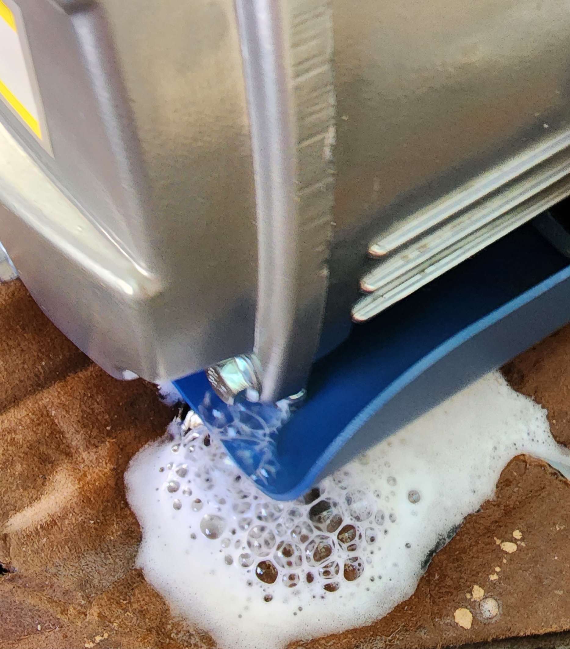

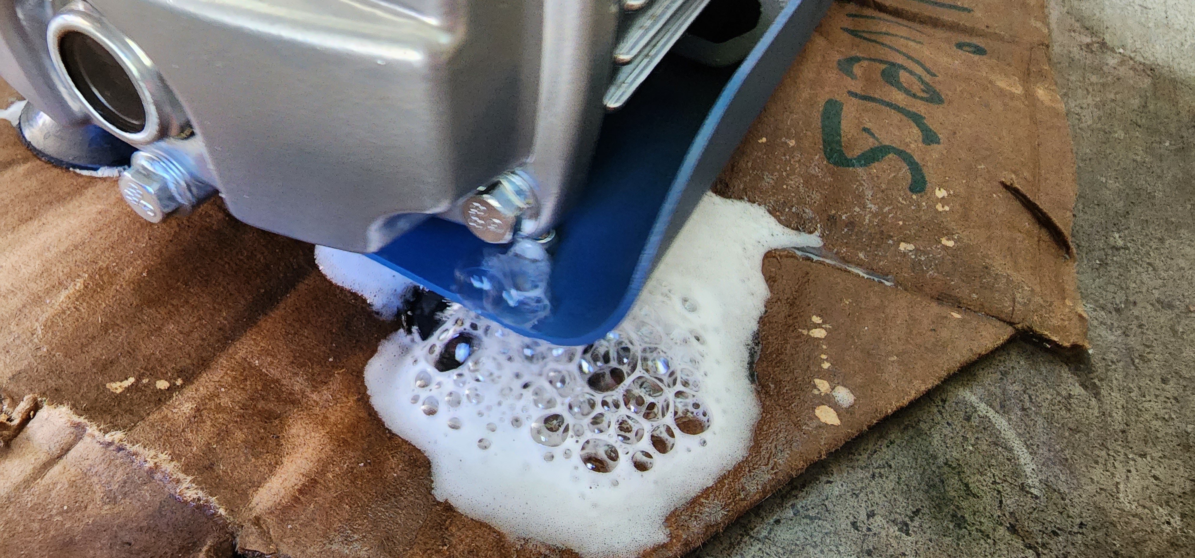

PROBLEM.. Air bubbles under crankcase.. Can't find the source..

Ok start over. The concrete floor is a puddle of water and who knows what too. Clean everything up and put the unit on a Clean Dry floor or better yet place on (2) 2x4's so it's off the DRY ground. Video bubbles are coming up through the cardboard or padding that is sitting in a water/solution soaked environment.
thank you.. that was my first thought when the bubbles were tiny.. the return hose came out of the bucket a couple times until I pinned it down..
I love that it is so simple.. that was the maiden voyage ... thank you
i think the fan blowing is making the water look more plentiful then it actually was..
