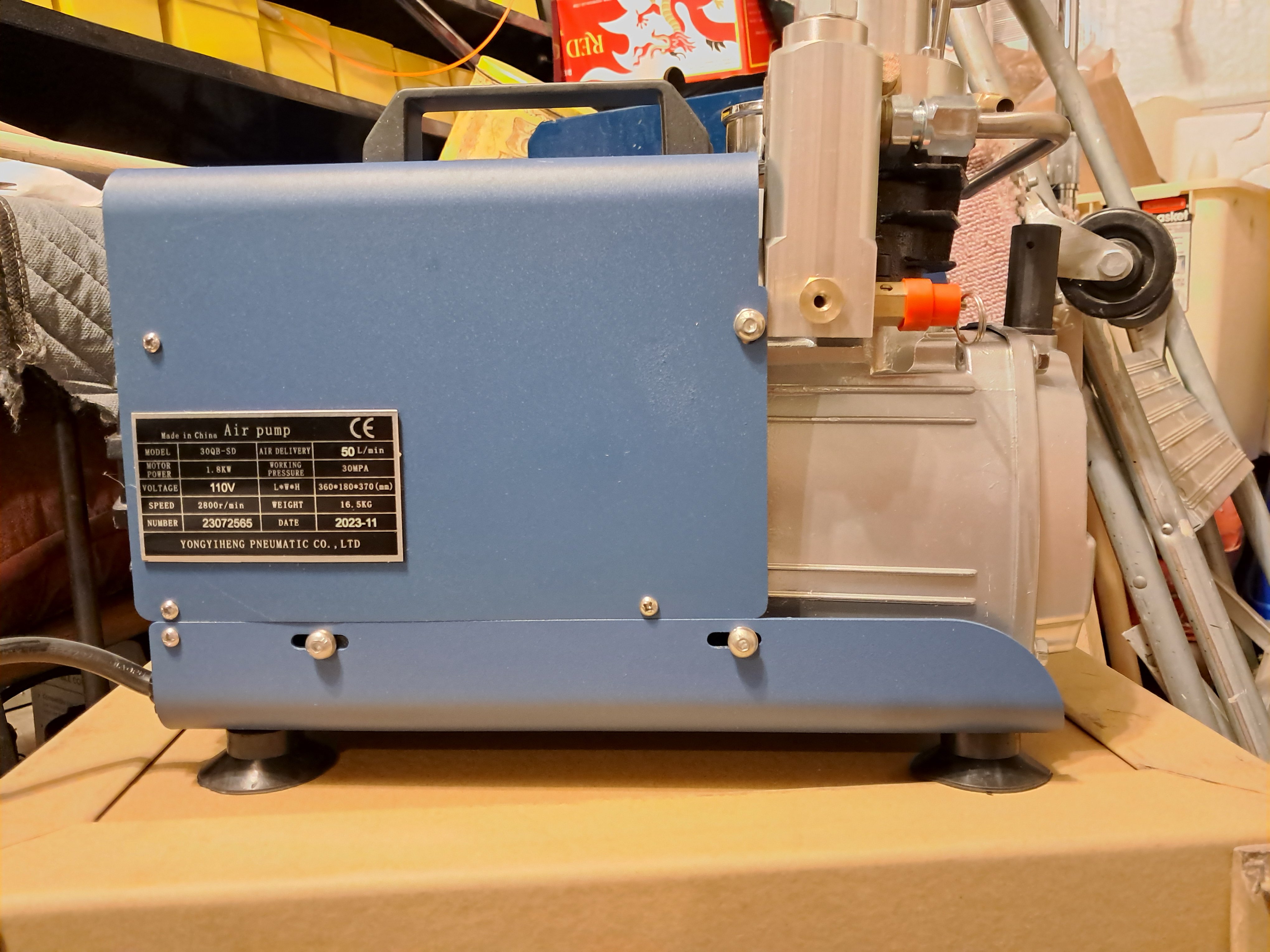

So I finally dropped some coin on a new Yong Heng unit from Amazon, the one w/o the auto cut-off feature, and a 1.8 kilo watt motor. It looks just like the other two, with the exception of the oil fill cap - it is not the breather type oil cap, just a basic oil fill cap.

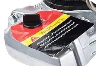

Pull the breather off an old one before running your YH! The case pressure will force oil past the piston rings and destroy your compressor.
Hard to say, I would think they would all have breathers. Never seen one without. These compressors should not be run hot, need very good lube. And should be run in short 10-15 min intervals dependant on temp. I typically do not run mine much past 230bar. Just doesn't sound happy and temps go up rapidly. I've repaired mine a few times but have been using the same one 6yrs filling a 9 litre tank mostly. Seem to have less issues as time goes on and I learn how to run it better.
Check out the the oil cap in the pic - this is the one I ordered -
