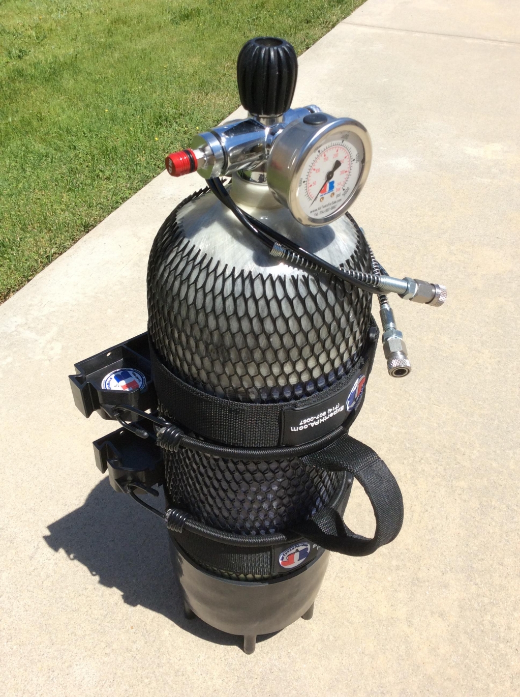

all 3 brands are good. comes down to valving system and length of hose. 1 air venturi , approx 18" hose pyramid air and can be put on affirm monthly payments. 2 omega which is carried by airguns of arizona has a 36" hose attachment these 2 run about $700 i believe. and then there is 3 - great white. expert HPA carries this tank - it comes with best valving system which includes 2nd gage to display tank pressure. a control release flow to prevent over pressurizing you guns cylinder- Great for pistols especially with their tiny tanks, and a package of protective netting , plastic stands for stability on it's side and a boot for the bottom to stabilize tank when upright. cost? $900. the air venturi and omega tanks need the harness and stand extra and airhog supplies this for $75 no netting or bottom boot.

I highly recommend the Great White noted above. The slow fill valve aids safety, even though it isn't absolutely necessary if one is careful. The protection/carry system is excellent but that can also be done in cheaper ways. The second gauge showing tank pressure is nice-you always know what pressure is in the tank. Cheaper is possible. All relative.
I too recommend Joe Brancatto’s Great White with full package. Slow fill with 36” hose, second gauge for inside tank pressure is what all tanks should have and body armor with feet that you can stand or lay flat.

When you're dealing with HPA, it's always a concern. Don't cheap out. There's a reason why there's a DOT certification and air tanks have to pass stringent test. In regards to Joe B's customer service, I've never had to use it. Never really heard anything bad though. The second gauge comes in handy otherwise, you would have to connect a dead head to check the internal pressure. Everytime you do that, you waste air from bleeding the line if that's a concern to you.

Joe B. makes sure the customer is satisfied. The second gauge for the inside pressure lets you know at all times the remaining pressure in the tank...otherwise like others said you have to use a dead head plug to check the pressure....makes it much quicker and simpler to know ones pressures. The slow fill is safer for the most part.
