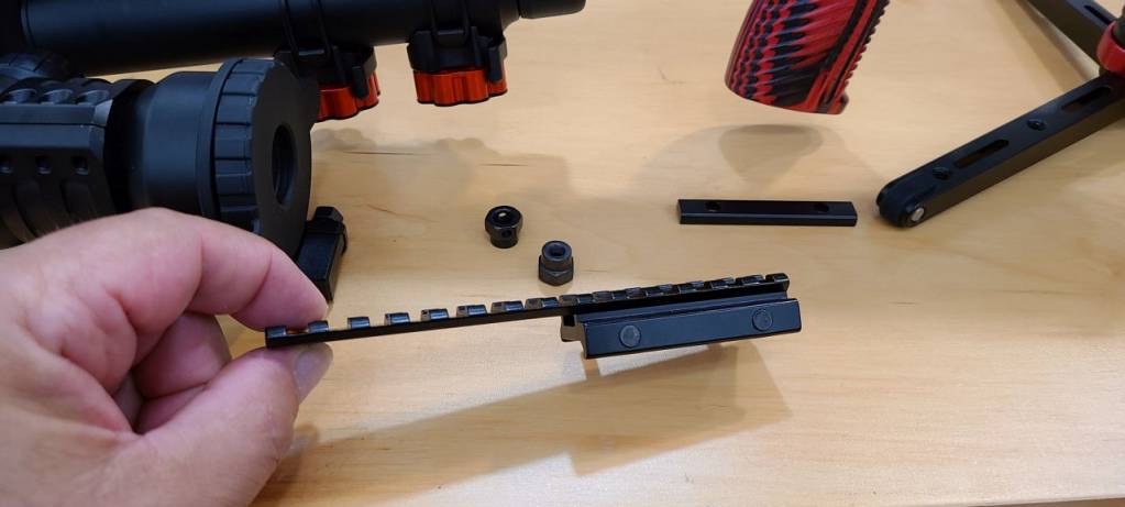

Scope mount or raiser mount and picatinny-Nato rail extension, would be some keywords what comes to my mind....

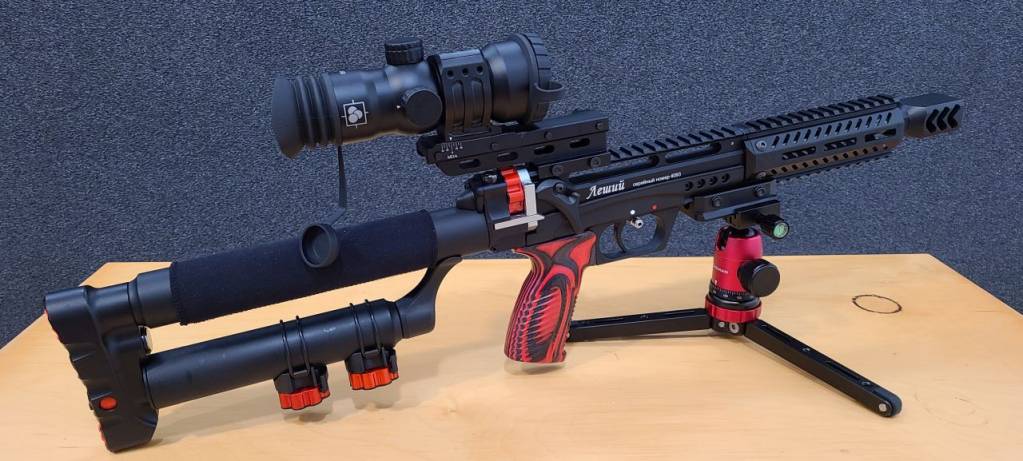

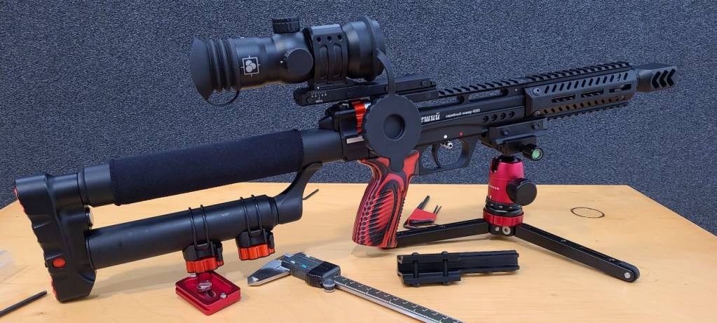

I want to raise up the scope for about 12-15 mm and bring it back to my eyes maybe about 45-50 mm.
This 14x50 scope was an internet purchase from EU, the ring is dedicated to the scope tube, and the glass is worth every penny. The L2 arrived only yesterday.
This shall be my setup for training for timed silhouettes.
How would you do?
I have found several options @ amazon, I ordered couple different heights to learn what will be the comfortable fit
looks high, https://www.amazon.ca/gp/product/B00BG22T5A/ref=ox_sc_act_title_3?smid=A27QV1FHRXMID5&psc=1
again something similar but a lower height https://www.amazon.ca/gp/product/B07MNRRJPK/ref=ppx_yo_dt_b_asin_title_o00_s00?ie=UTF8&psc=1
The most problems I am seeing which side they mount the screw and the nut on opposite side = cannot come where the stock is folding
For the 2 picatinny rail extensions you linked and just by counting the open picatinny slots towards where the rear of your scope mount would be mounted, you should be fine with the stock not interfering when folded.

I've got used to big power scopes, on my Impact I have the Falcon X50 mounted. At 50 meters I am using x25 and at 100 meters dialing it in all the way to the ring I don't want to see anything around the ring on the paper. This why I chose this IO 14x50, and it is a single power = prime lens, way better then any zoom in the price range.
What I don't like adding raise supports, more connecting parts, each to be just for a hair out of specs and I am ending up with a scope out of barrel alignment. Will see, my parts arriving after the weekend.
I think the immersive mounts have a little wiggle room but tightening them while aligned could be a challenge. Lucky you can awing the stock out of the way to lock down after holding scope in proper alignment.
