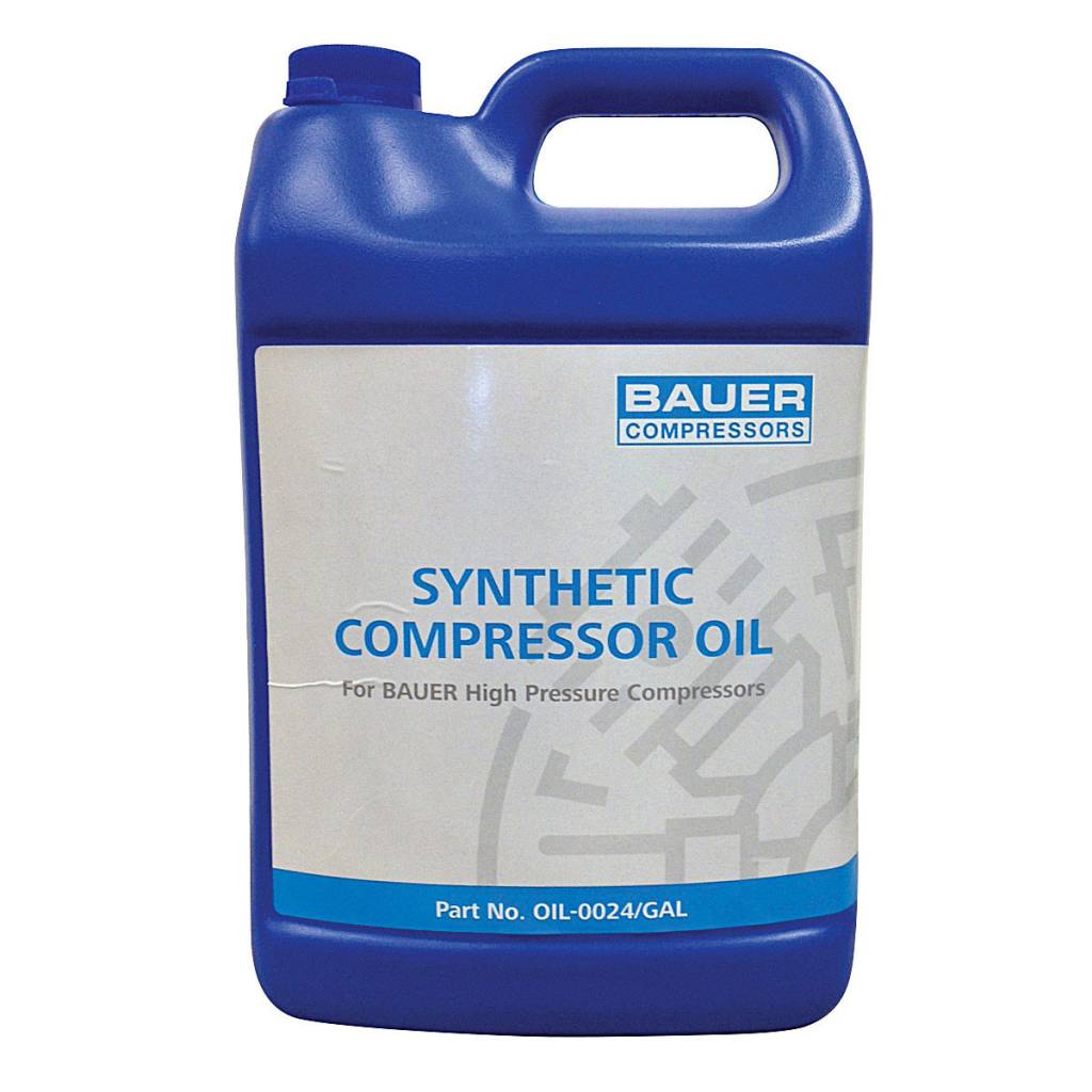

Bauer HPA compressor oil has the correct properties. When used in its compressors, does not usually allow detonation from its blow-by, as do most all quality continuous duty HPA compressor oils. Low pressure air compressor oils do not have or need this quality.

Thanks, that was interesting and helpful. Any additional comments regarding use of synthetic vs. non-synthetic air compressor oils, as it relates to blow-by detonation? Also, I see the Bauer is synthetic, do you know of any additives that allow this brand to have the "correct properties" for HP air compressors versus other synthetic A/C lubricants? Thanks,
