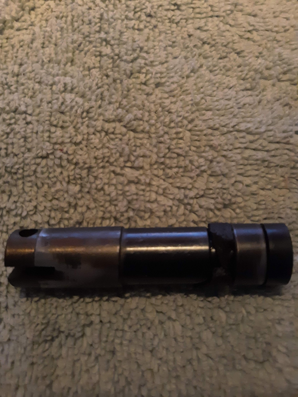

I need help with 1978 crosman 760 seal replacement.
A AKAjim Member May 6, 2020 2 0 MO May 7, 2020 Add bookmark #2 May 7, 2020 Add bookmark #2 I can find the replacement pump cup but the the other part that is torn in the picture in the wide groove does not show up in my searches for parts.Does anyone have a source for that? Upvote 0
biohazardman Member Jul 3, 2019 5,451 303 Herriman, UT United States May 7, 2020 Add bookmark #3 May 7, 2020 Add bookmark #3 It is just an oiling ring made from felt. This is all I could find. https://www.ebay.com/itm/10-Crosman-Old-760-100-101-102-104-140-1400-Felts-Part-101-031/174118909073?hash=item288a4bb491:g:hSgAAOSwgd1beJgK https://www.ebay.com/itm/Crosman-760-761-Complete-Seal-Kit-With-Pump-Cup-and-Felt/174264777727?hash=item2892fd7bff:g:2QYAAOSw7IFddOgI Upvote 0
