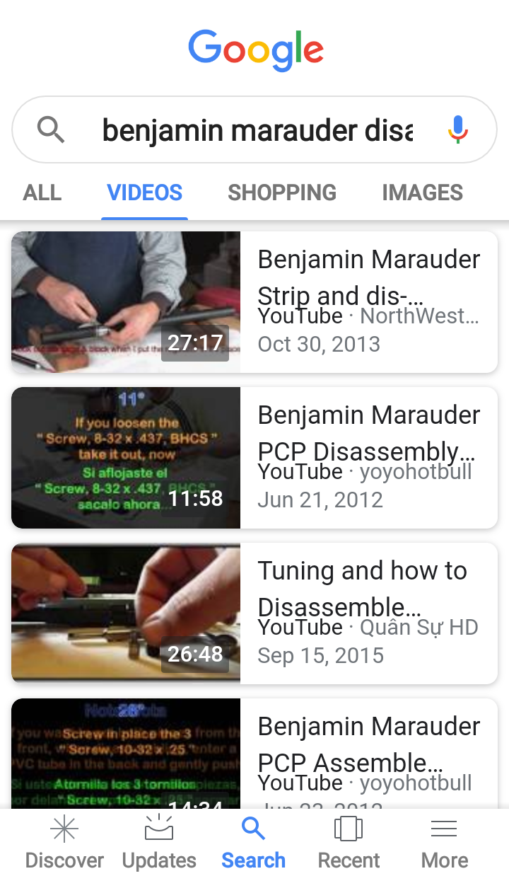

If you check out my U Tube Channel, Field Target Tech, I show a disassembly video, and a reassembly video. There is also a separate video for only a regulator install, you might want to pass by that one, or at least watch that one last. There are a few others on u tube as well. The biggest hurdle that you will have, will be figuring out what screws go where. If you have a problem with this, take a picture of all the screws, separate all the different kinds. Take a picture, and send it to me in a PM. I'll be able to tell you exactly where they go, and you'll be on your way to reassembly success.

Follow the videos. hour tops to get it back together, if all the screws and parts are there. I'd offer to come over and help, but you are in Georgia, I'm in Utah. Kinda far for an evening drive.
