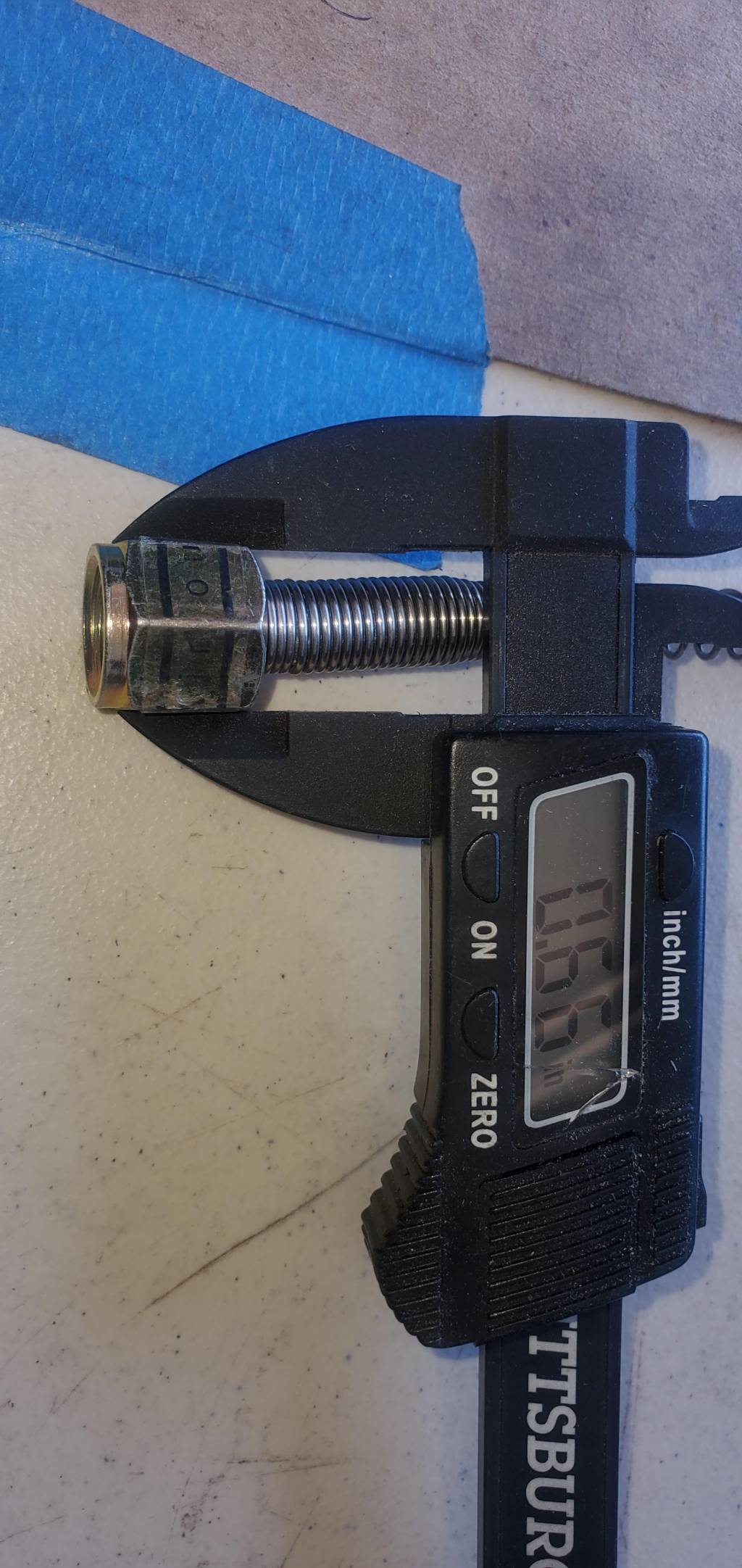

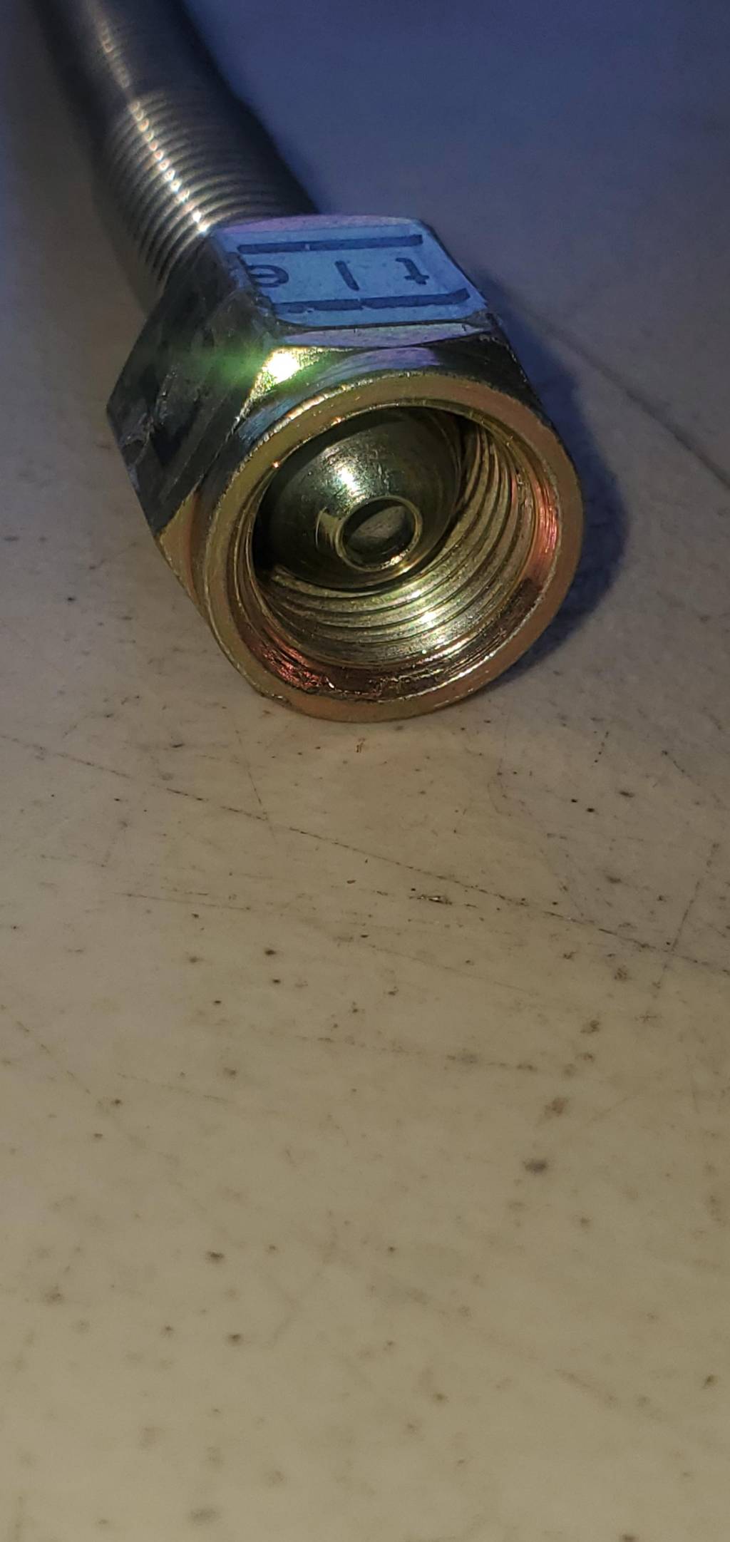

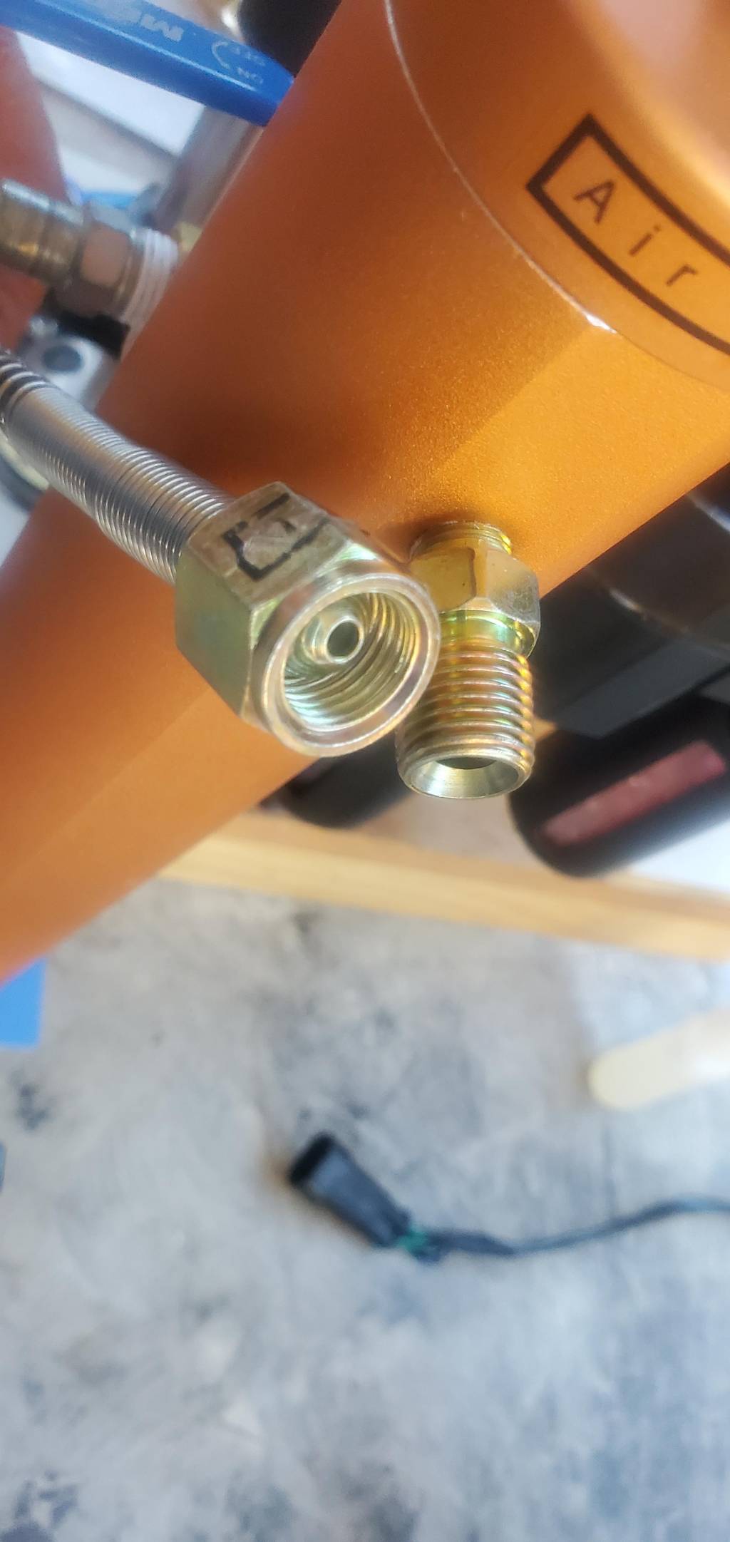

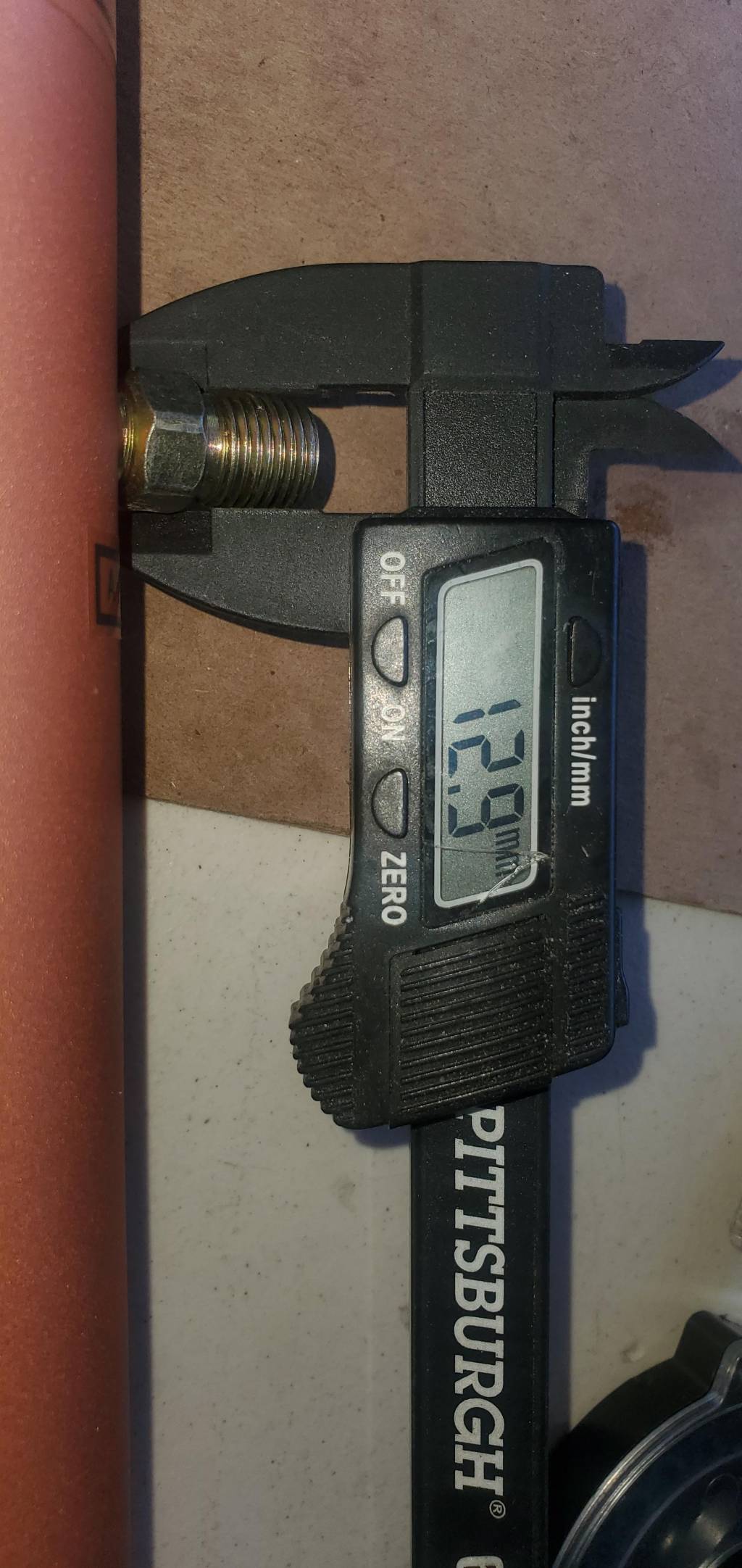

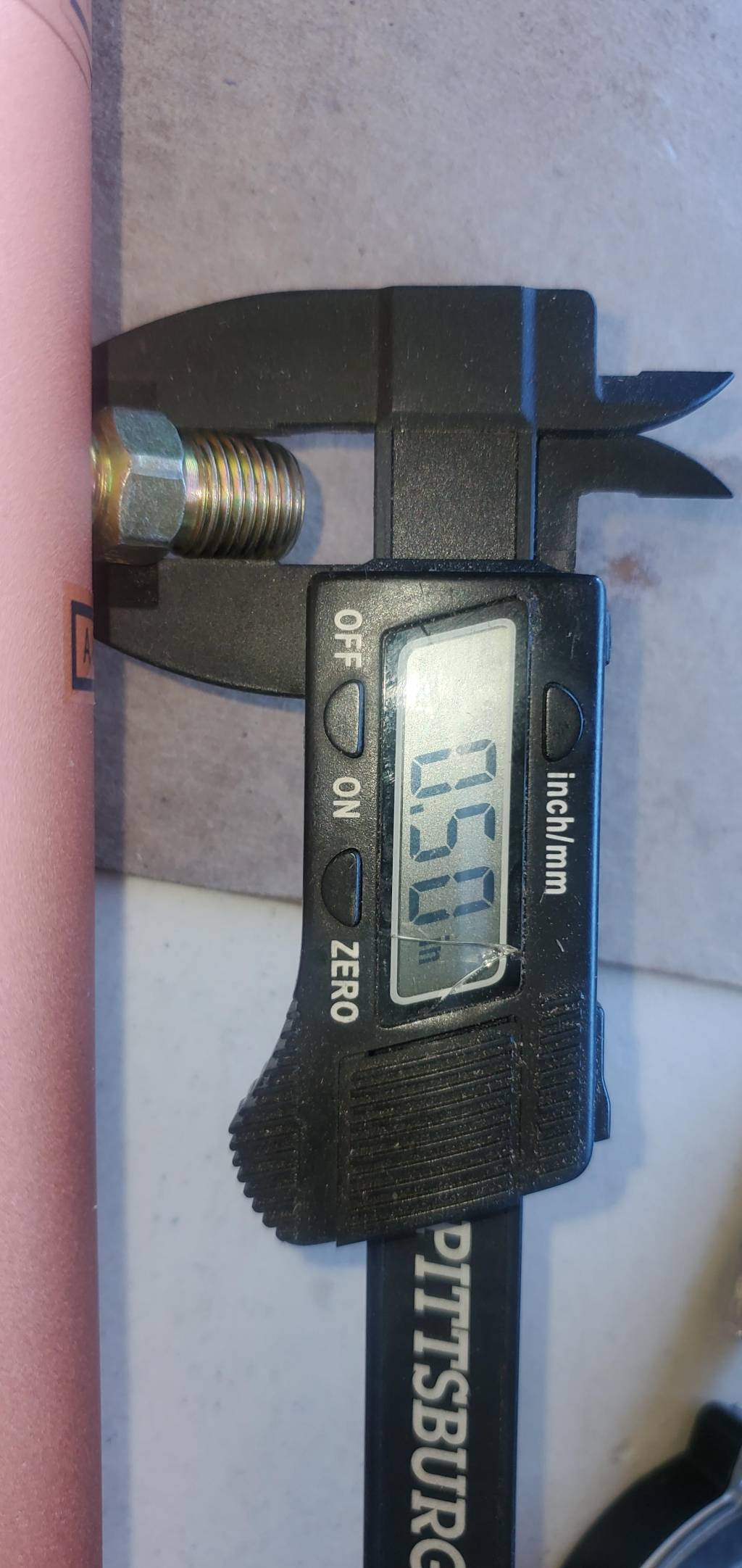

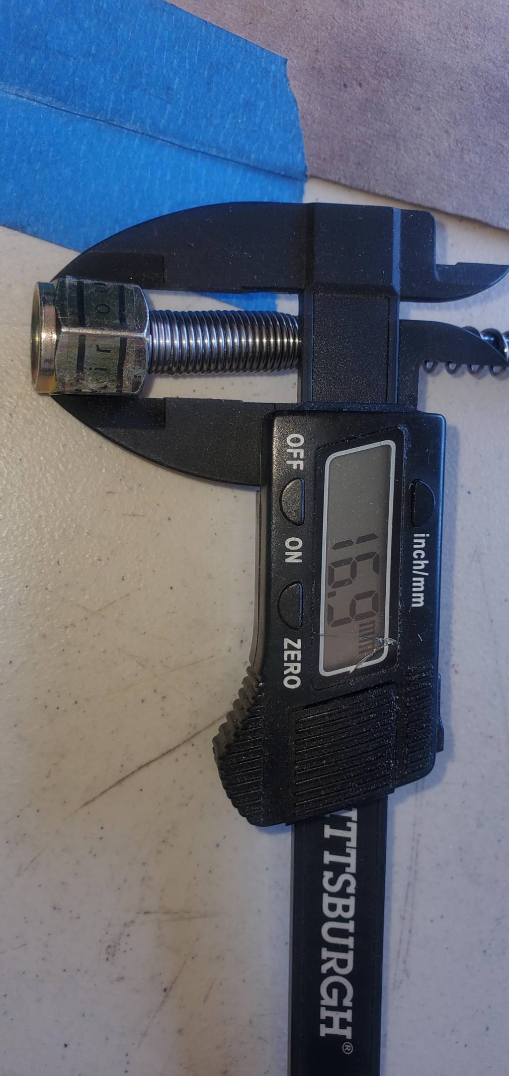

What type of fittings (names) am I looking for? This is what I have.
What thread do i have and need.

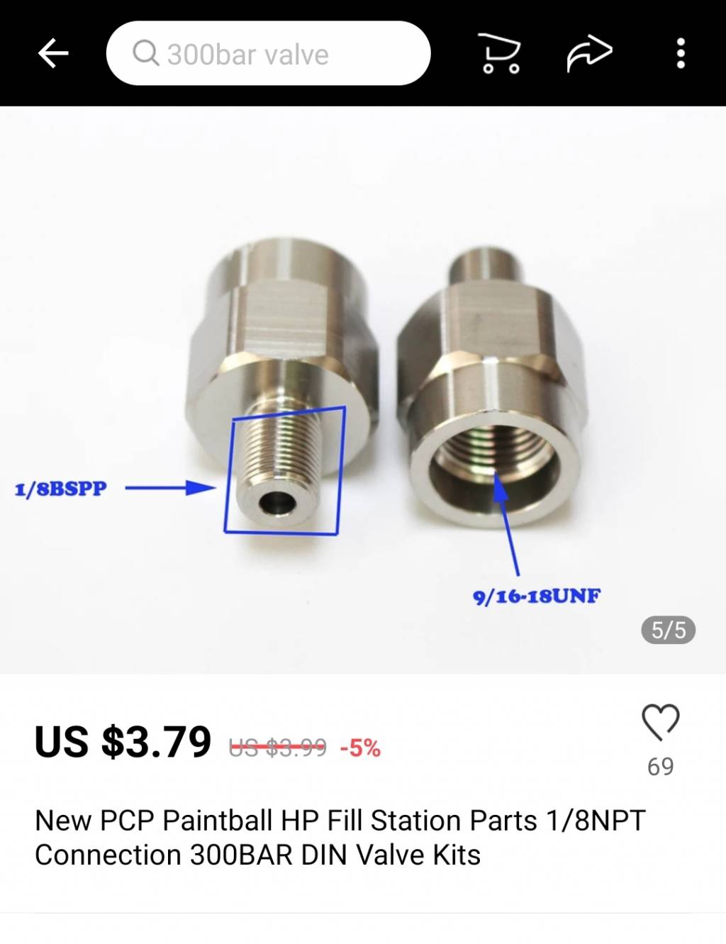

I've been watching some YouTube videos by Topa Manufacturing Company, in China, that makes all kinds of PCP pumps, fittings, filters, hoses, etc. They mention that a catalog is available, in your shoes, I'd try to get one. I think quality is good and prices reasonable. Easy to contact, information shown on videos. Only thing is they might only sell to dealers, not directly to consumers. Worth a try, I'd think.

i dont know what thread size you have so odentifying those is like pretty necessary to know what adapters you need .. most male fosters are sold with a removeable check valve .. a bleeder rated at 6k psi and 1/4" npt threads im sure can be located easilu enough on ebay etc ..getting fancy with hpa fittings can be a bear to get sealed well .. use big tools .. ive found loctite 545 is useful on threads that dont seal on a donut or oring but it takes awhile to fully cure and hold up for hpa use .. about a week ...
Thanks and yes identify the fittings is a major ordeal. I do not come from a background of pipe fitting. And with these items coming from outside of US it put out there even more possible types of fittings. The fittings I am looking at first appear to be JIC but not. Or AN but that is also not the case

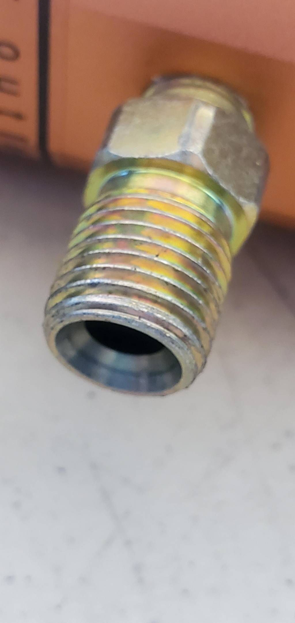

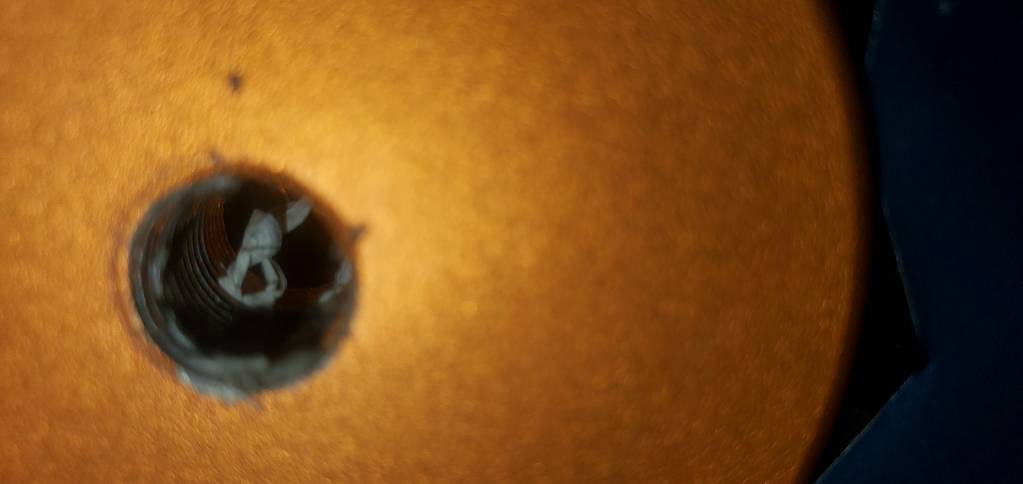

I figured that I would have to remove at least one of the fittings. I did not want to as I did not want to have to clean out the threads of any sealer if used. The good thing is Ifound out the threads going into the unit appear to be 1/8 npt. It is tapered so not bpt or bsp parallel or the others... Yaa! But i will need to clean the threads out 😡
