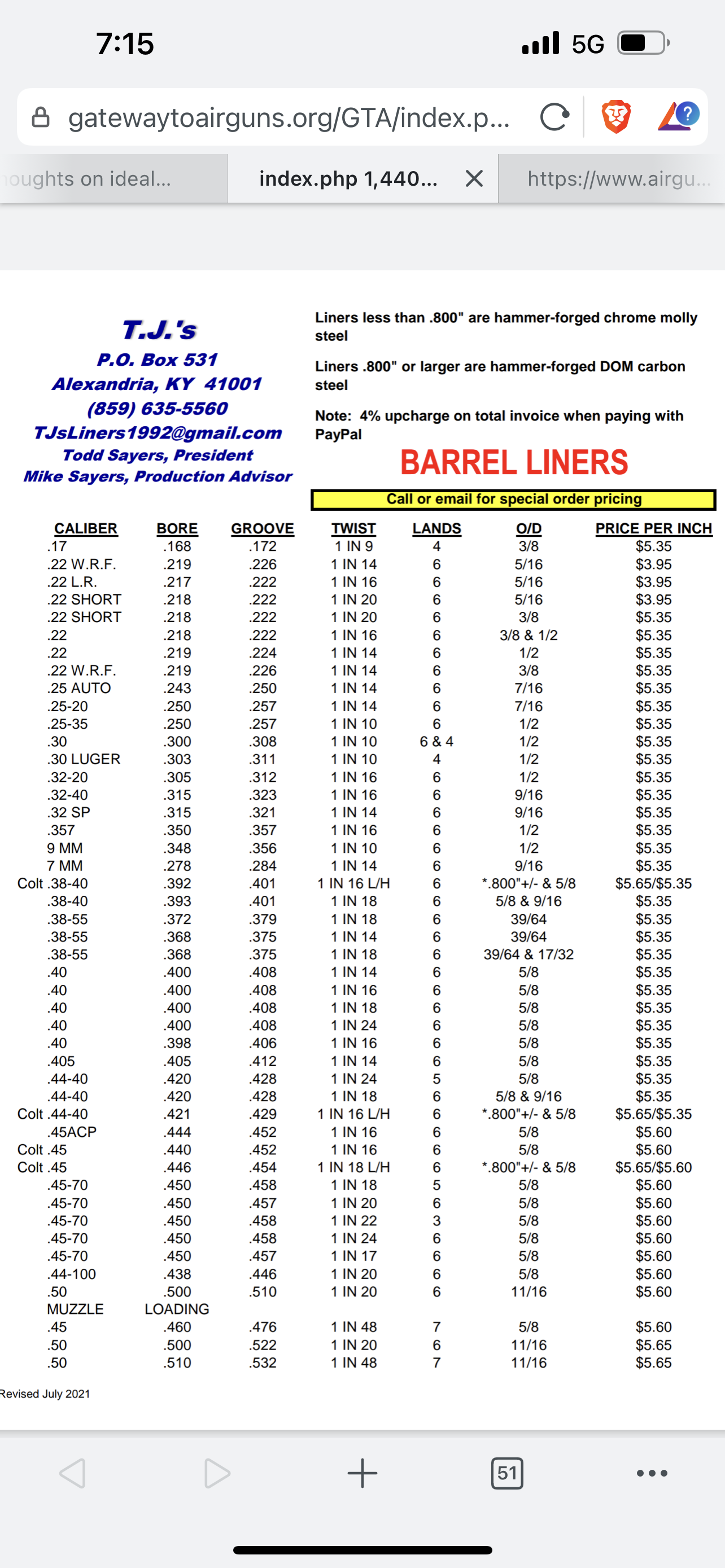

I need a 25 auto TJ barrel in 9/16 diameter not sure if it’s made
I want to rebarrel my Kral Bighorn 25 caliber with a 28 inch .250 groove diameters barrel.
The problem is TJ lists that barrel with at 7/16 diameter and my Bighorns’ barrel is .591 /15mm diameter, but more importantly the barrel stub is .501 inch.
I have reached out to TJ via Emil to see if they make it in either 1/2 inch or 9/16.
Has anyone had a 9/16 TJ 25 auto barrel made?

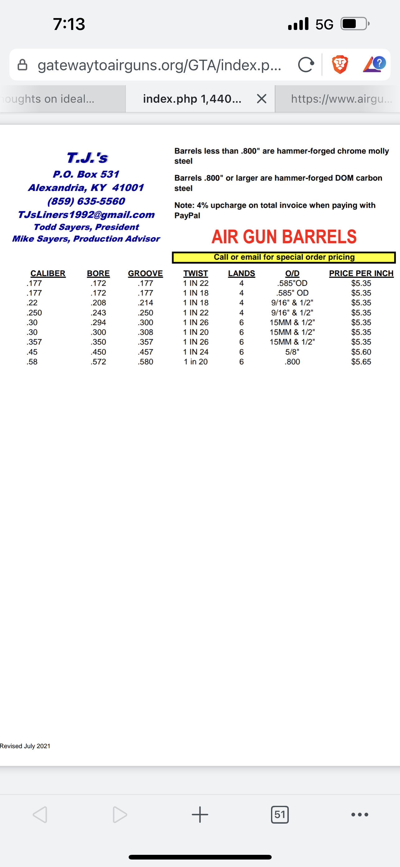

I see he has a 1:22 barrel on 9/16
I’ve made a couple of barrels using TJ liners. Look for DOM tubing with a 7/16” i.d. and an appropriate o.d.. You might need to sand down the liner a small amount to get a reliable slip fit into the DOM tubing. Then use Loctite 641 to bond the liner in place. You’ll only get one chance to slip it into the DOM quickly before it sets. Finish machining like any other barrel.

It seems that TJ does make 9/16 25 caliber barrels per Trash’s post, question is whether they will make one with a 14 twist for me.

Apparently it’s pretty common to make combos outside of what’s listed in the chart, as I (and many others) have a 1:14 257 barrel. In any case keep us updated. I’d own a bighorn myself if they were left hand friendly. What is the max length slug for your magazine?
The key piece of info is the above posted price list only represents TJ's standard airgun liner price list there is an larger/separate price list for powder burner liners. For example, our 1:14 .257 liners are from the powder burner price list, they are marketed as 25-20 liners.
That yellow banner stating to email or call for special order pricing, does that mean they can make a 9/16 .250 1/14 twist? So far I have called and emailed but no return communication yet.
RC
