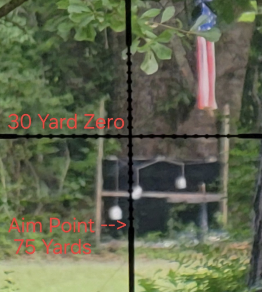

Yes, the main challenge of long range (75-yards) shooting with the HW30 .20 cal, is dealing with the trajectory. When zeroed for 30 yards it is about thirty inches low at 75. My scope doesn't have that kind of range. So to get it done I used the scopes bottom mil dot. Then did some testing to dial in my elevation using the scopes zoom. I found that at about 4.5 X the bottom mil dots was zeroed for elevation.
Then my next challenge was overcoming scope cant. You get a real clear understanding of the importance of cant when you look up at the X and know that pellet is going to fall from there all the way down to your aim point.

I was wondering where you had zeroed the gun, LOL. Since I plan to use the stock open sights, I'll be shooting at much closer distances anyway.
Shooting the 20 cal HW30 at 75-yards is like lobbing mud balls, so I wasn't going to bother mounting correcting negative moa rings, but I can still shoot at 75 by using the bottom mildot at a zoom of 4.5 X.
I don't know the adjustability range of the iron sights?
This is a view through the HW30s scope taken with a phone showing the difference in 30 and 75 yards.

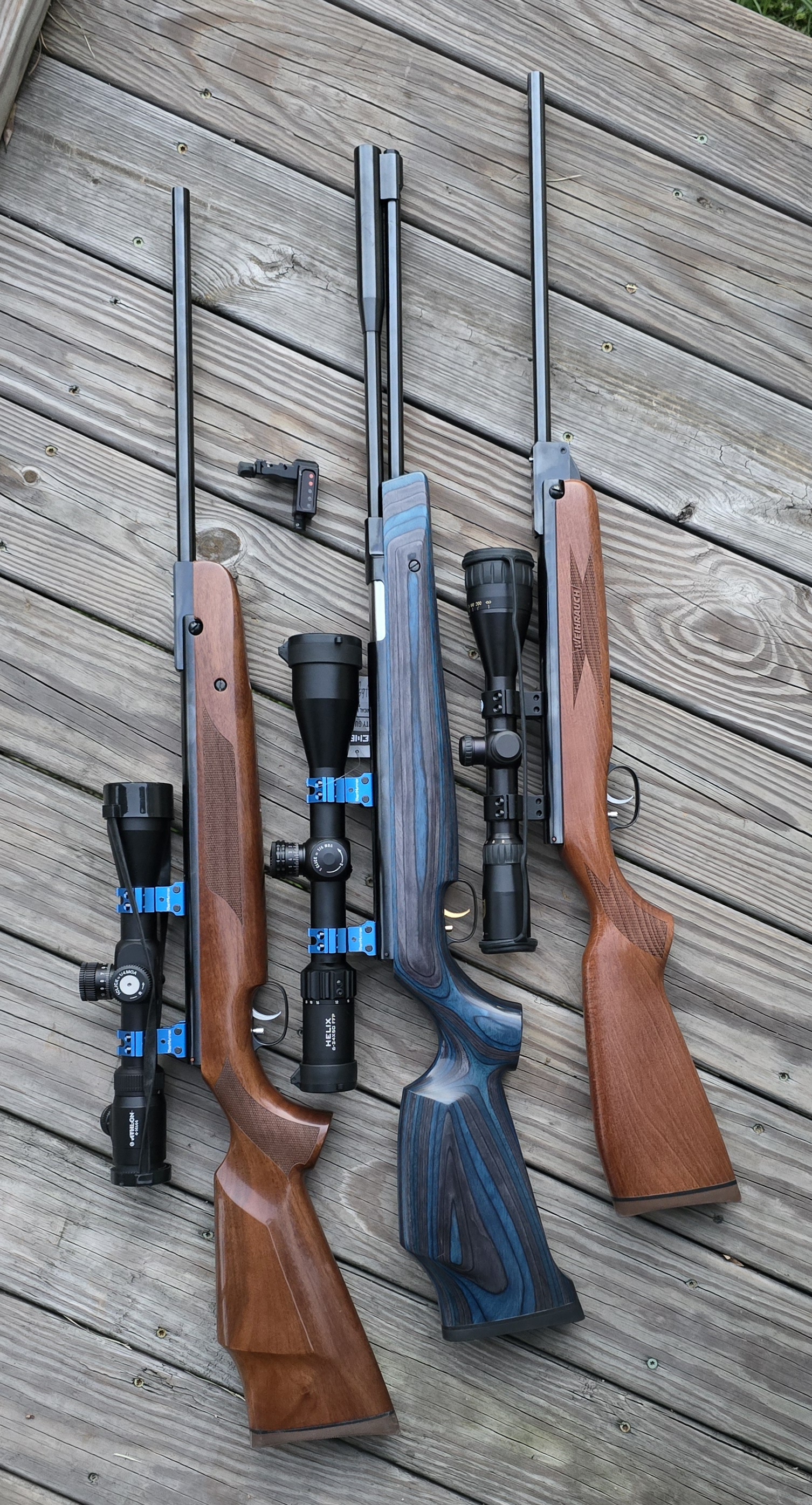

Whatever marksmanship I developed largely came from my youth with a Sheridan. So, I have procured a number of .20 over the years. These are HW97s, HW30, HW95s and an extra barrel for my HW90s.
Compared to .177 and .22, all of these have been less pellet picky and by and large, easier to achieve fine accuracy. We don't have many pellets to choose from, but all seem to work very well in each of these rifles over a surprising range of muzzle velocity.
