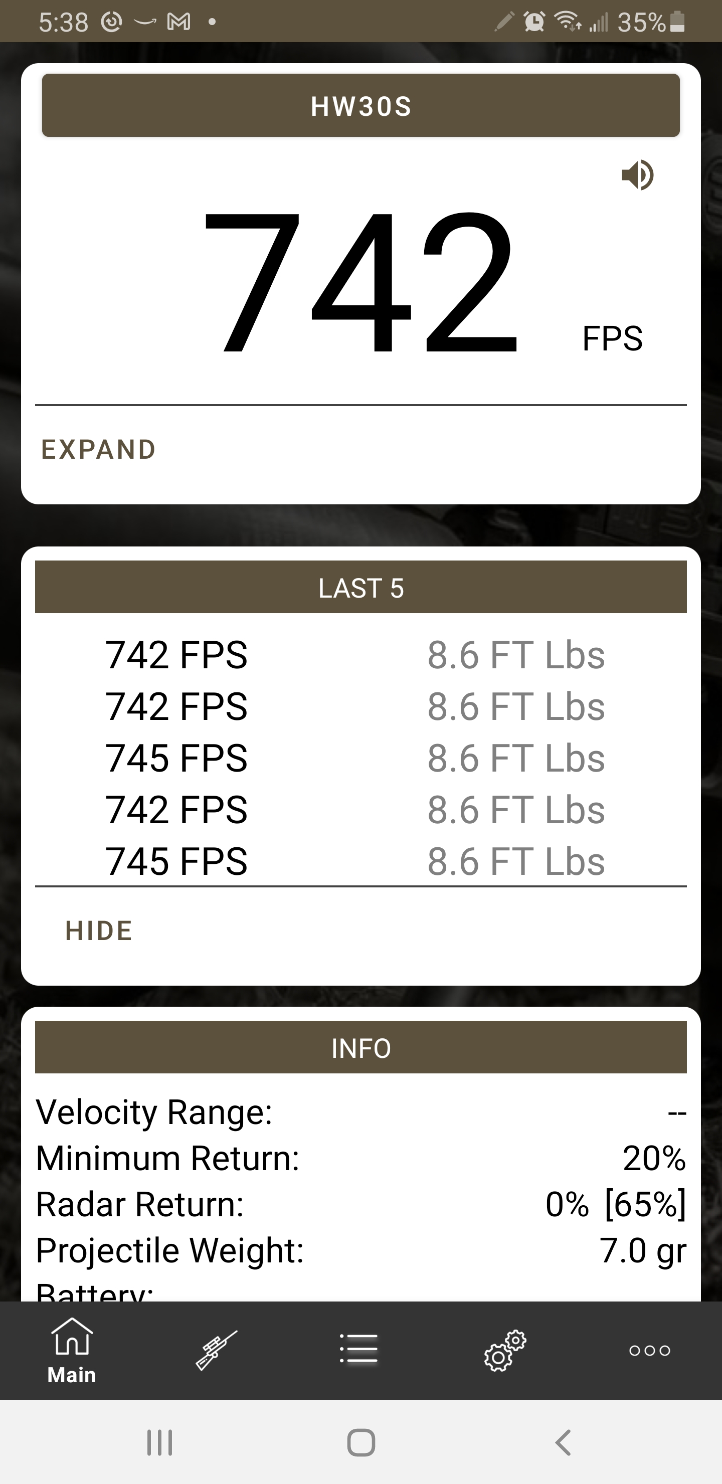

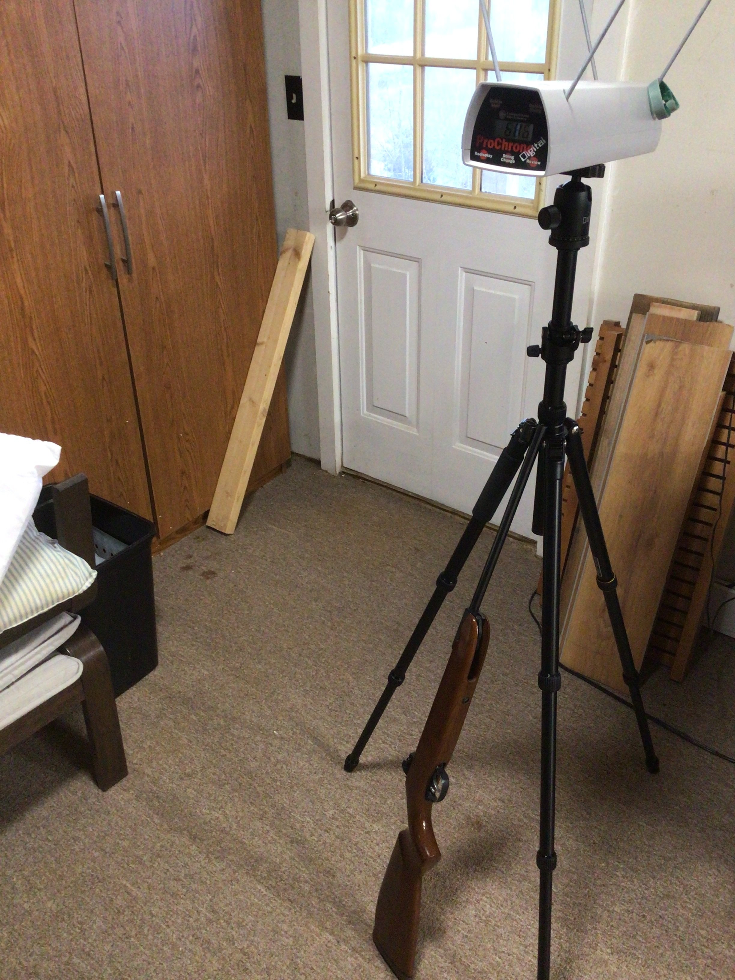

Between crumby weather, holiday activities and my kids coming to visit I haven't shot my HW30s in a while. Today I took my peep sighted 30 out and found it loaded and cocked. For how long? I'm not sure. I'd guess at least two weeks. Fired off the loaded shot and a few more. It felt fine. I set up the chrono to make sure. Nope.
This gun was last shooting 7.33s around 715 fps. Today ten shots averaged 686 fps. That's almost 30 fps. When people tell you leaving a springer cocked doesn't do anything, all I'll say it's it depends on the gun and for how long. It's embarrassing to say but this is the second time I've done this to the same gun. Last time it was over a three day weekend and the results were about the same.
I keep extra springs on hand. Now I have to decide if I want to change it out. I like them over 700fps.

Thanks all. I tried leaving the last one alone hoping it would come back. It did a little but not near enough. I'll see what happens with this one. It'll be like a controlled experiment in stupidity. 🙁
Luckily springs are cheap and I can swap one in under ten minutes. I just hate having to fix things that were only f'd up by my own stupidity.
