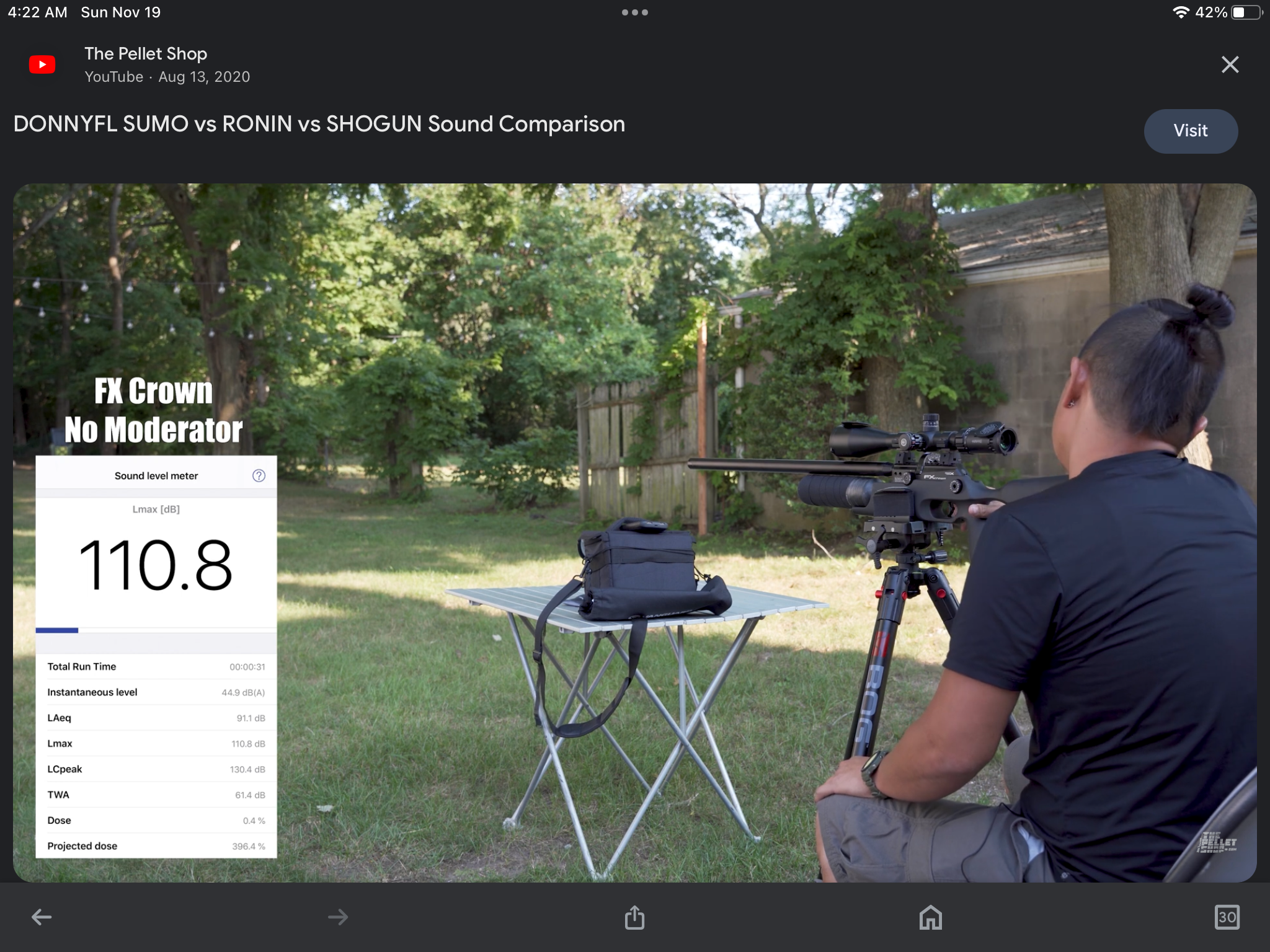

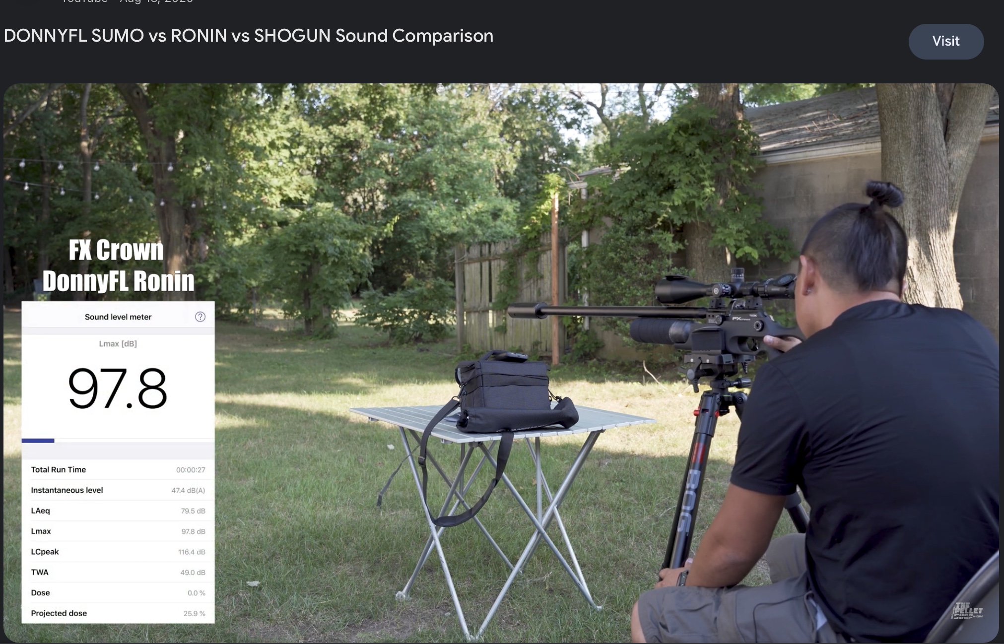

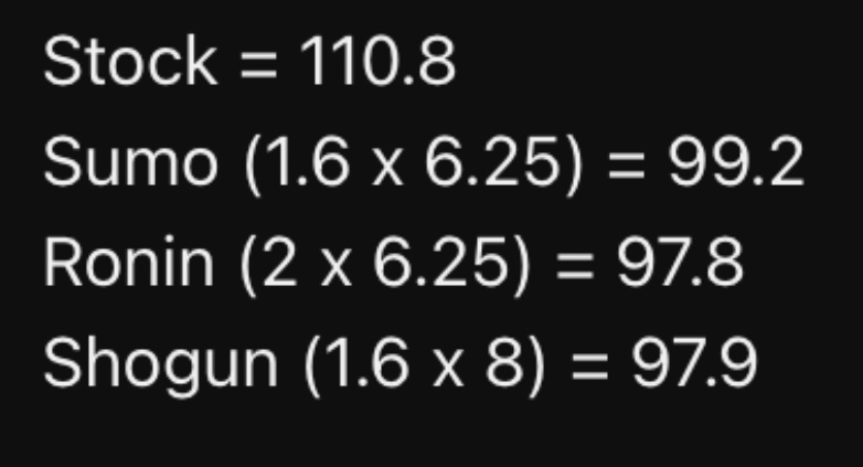

According to this independent test done with a FX crown the DonnyFL Ronin and Shogun outperform the Sumo. I wrote the size difference between them. I will like to know if the impulse air 1350 can outperform any of this DonnyFL moderators and if he does with how many baffles. I also like the impulse air model 1200 because its smaller in length and diameter vs the DonnyFL Sumo, shogun and ronin but not sure if he can outperform any of them. The size of the smaller 1200 is 4.7” in length, 1.2” in diameter and only weight 3.3 oz. But I will not hesitate to buy his bigger brother the 1350 if he quiet down my airgun the most. The 1350 dimensions are 5.125” length, 1.375” in diameter and weight 4.52 oz. This is the info I am looking for, also I would like to use a different moderator on my new Avenge-X classic in .25 caliber to not confuse one with the other since I plan to use the same scope I am currently using in my other Avenge-X classic .22. It’s a Arken SH-4 second gen FFP 4-16x50 with Arkens acope rings that I already have brand new still in the box waiting to be installed as soon I receive the new airgun. Thanks
