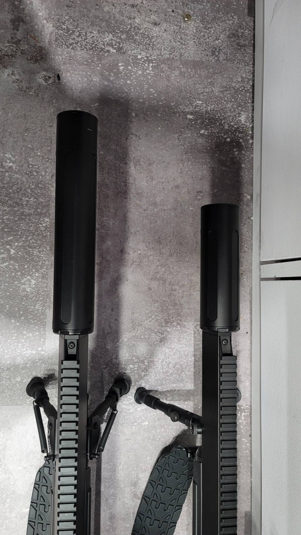

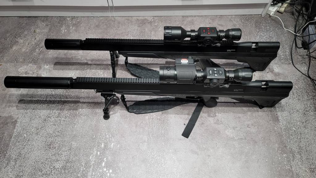

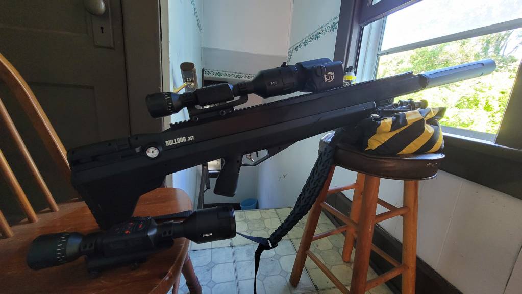

The Predator Polymags are one of my most accurate rounds out of the Bulldog! I shoot them around 930fps and I have the Pitbull Power Spring installed in both of my Bulldogs. I have barrel supports in both Bulldogs, and that really keeps the groups tight. I also have the DonnyFL Emperor and Ronin for my Bulldogs. The Emperor is the quietest, but it's front heavy and long, so I mostly use this only when I'm shooting from the bench.

Donny FL emperor plus extender and a regulator in mine got it super quiet. The noise is now mechanical and the slug hitting. Nothing you can do about either of those.
The down side is it made it really long.
The pitbull moderator tucks the baffling on the underside instead of extending the barrel. It seems to work well in the vids I watched. Down side is this limits reservoir mods if you plan on doing any.
