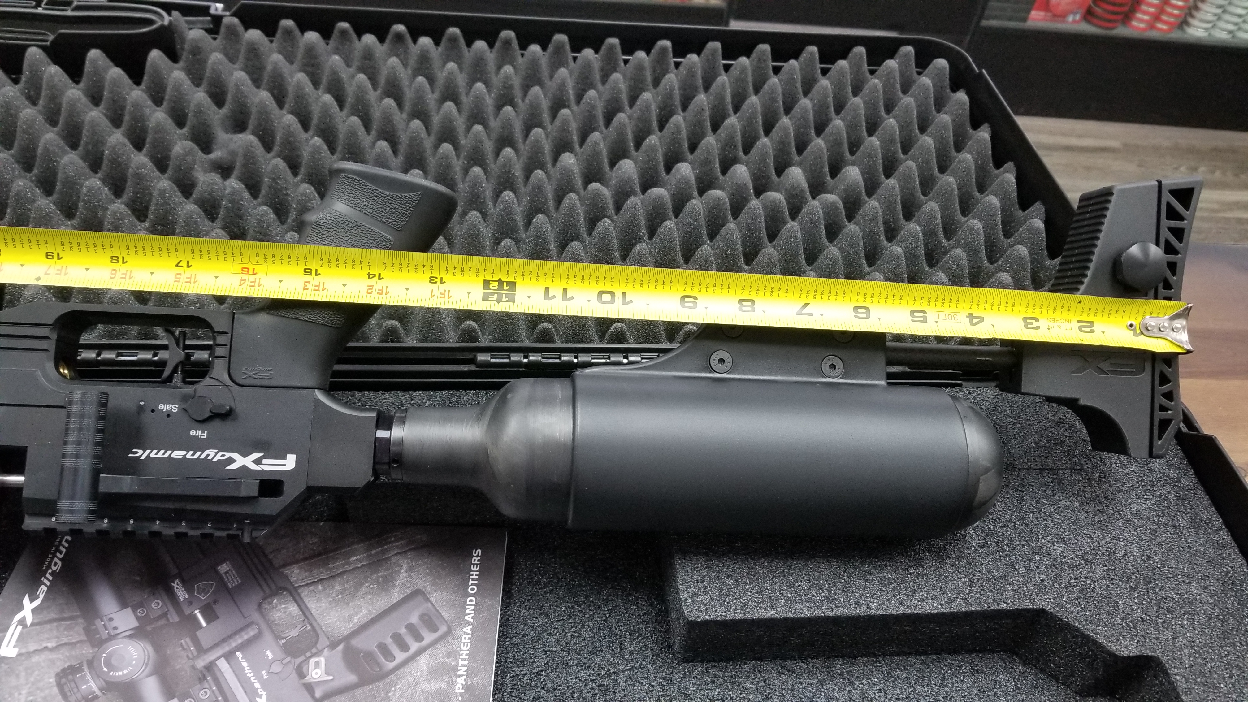

I had questions about length of pull and the Dynamic. Alamo Air Guns of San Antonio sent me this picture. The length of pull is adjustable on the Dynamic.
