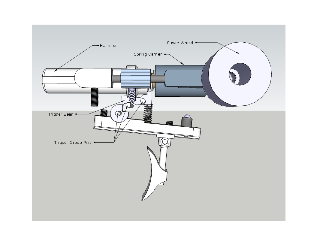

AirBuks just put out a video for FX (on their YouTube Channel) that shows how to disassemble all of the DRS models. It shows the "match grade" trigger group from the Pro. That trigger group has been available for a while - I think it was on the Boss. I bought one to play with and figure out how it was different. I decided not to use it on my Crowns as I liked my GRS stocks and didn't want to modify them.
But the key point is it is really easy to swap the trigger groups. Remove the "match grade" group by undoing the two cap screws holding it to the block. You will see a small lever protruding from the bock. Remove the grub screw covering the most forward (and lowest) trigger pin, then remove the pin. The lever will fall out. Place the regular trigger group in the slot and put the pin through the trigger wheel of this group. Replace grub screw. Adjust to taste.

For reference. here is a view of a 3D model of the Dynamic action (which uses basically the same trigger group)

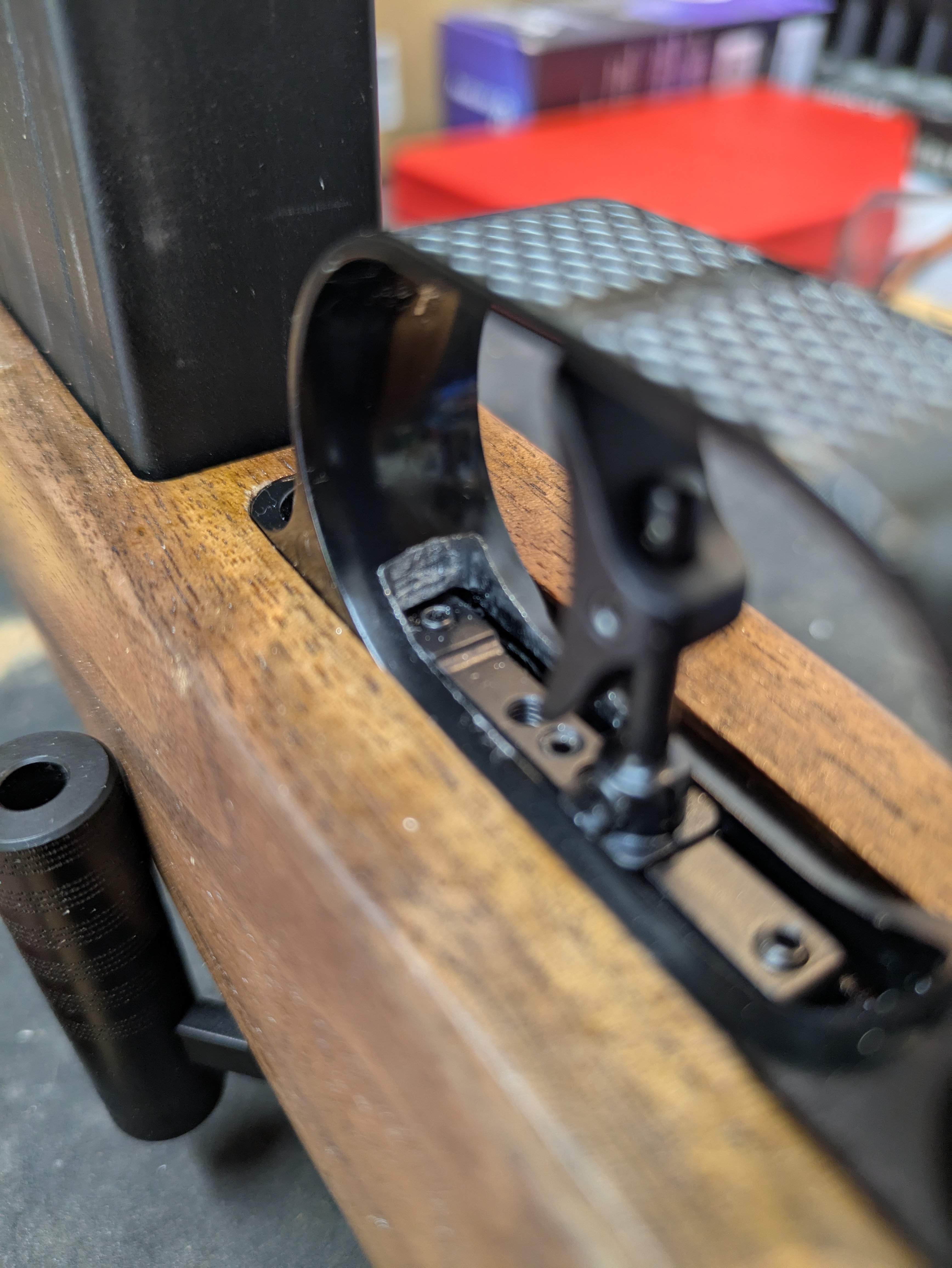

Started by ordering an action and the saber tactical chassis. The SB chassis would not fit, it bound the trigger when installed. UA installed it that way, shipped it to me with the safety stuck on fire, and the trigger not even moving at all. The only compensation for that fiasco was free return shipping. Woohoo.
SO called UA and swapped it for the delta force chassis. OMG this thing is heavier than philosophy class. I could not, for my use case of shooting out back and an occasional field jaunt, lug that thing around.
So I found that FORM from the UK made some beautiful walnut stocks with cheek and LoP adjustments...ordered one of those. Finally get the trigger guard with it, and go to put it all together, and find out that it doesn't fit. Apparently the DRS PRO and the DRS CLASSIC have different trigger groups, and they are not compatible across stocks. The PRO is intended ONLY for chassis style - despite only fitting 2 of the 3 chassis available.
So back to UA, and ordered a standard trigger group, which they claim FX says you can swap, but they never have. I probably should have looked at videos of removing the trigger assembly before ordering that, because now there is no way I am excited about taking all those tiny pieces apart lol.
So, now, 6 month in on ownership, and I still have a gun I cannot shoot. I am ready to stop throwing good money after bad - I just wanted a slug ready FX gun, it just looks like this adventure is down a rabbit hole full of poo.

Well, thank something for lazy Sundays!
After getting a little inspiration from SOME of the comments (thank you, constructive people), I applied sufficient interludes of cursing, sweating, filing, and grinding with the dremel, to create some ugly monstrosity that allows my existing trigger to fit. Started by filing back the entire section, before a few fitting tests showed I just needed a little shelf cut out for the trigger piece to move it.
This may be disappointing to those looking to shuffle through the loot pile, but it looks like I will have a functioning gun after all.
