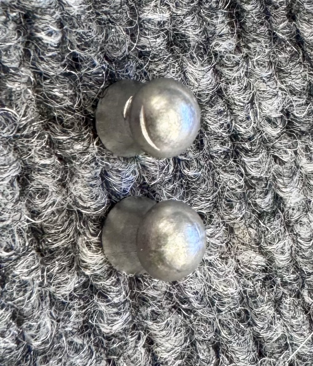

Here's what a pellet looks like after I try to chamber it. Note the crescent shaped cut on the top pellet. I'm assuming this comes from the rear end of the barrel.
