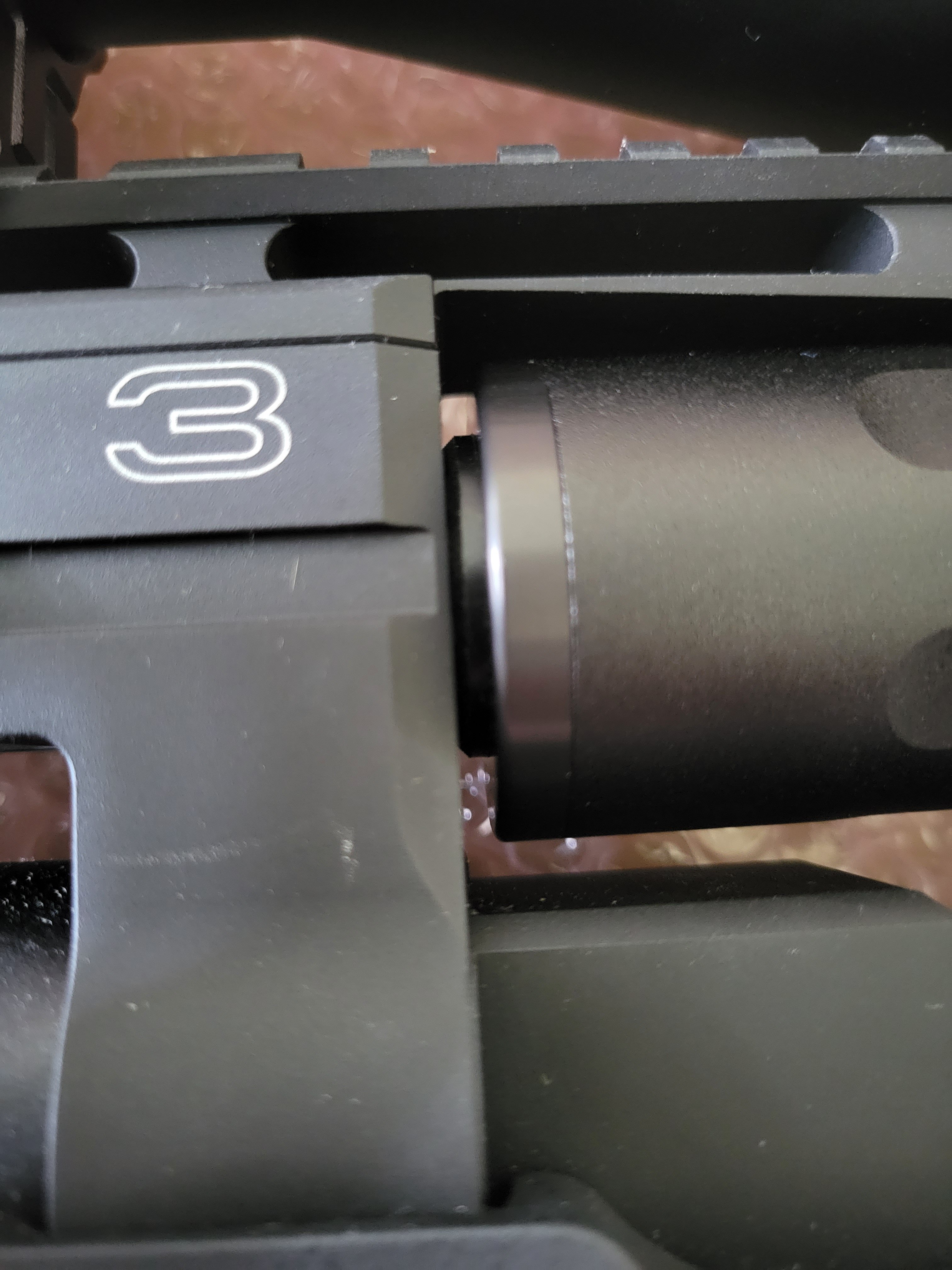

My .177 uragan standard likes NSA .. 15gr at 950fps, n griffin cup base 16 a bit better .if I have not tension the barrel of my 4 AGT. I would have sold them all .. I only shoot slugs from the 177 n 22 the .25 vulcan 3 500mm n the uragan standard. 30 could shoot both pellets n slugs. Only because the barrels are tensioned.. with a pice of hard plastic .. there is nothing safe up to 140y with that uragan 177 shooting slugs. Is simply Goin down..
