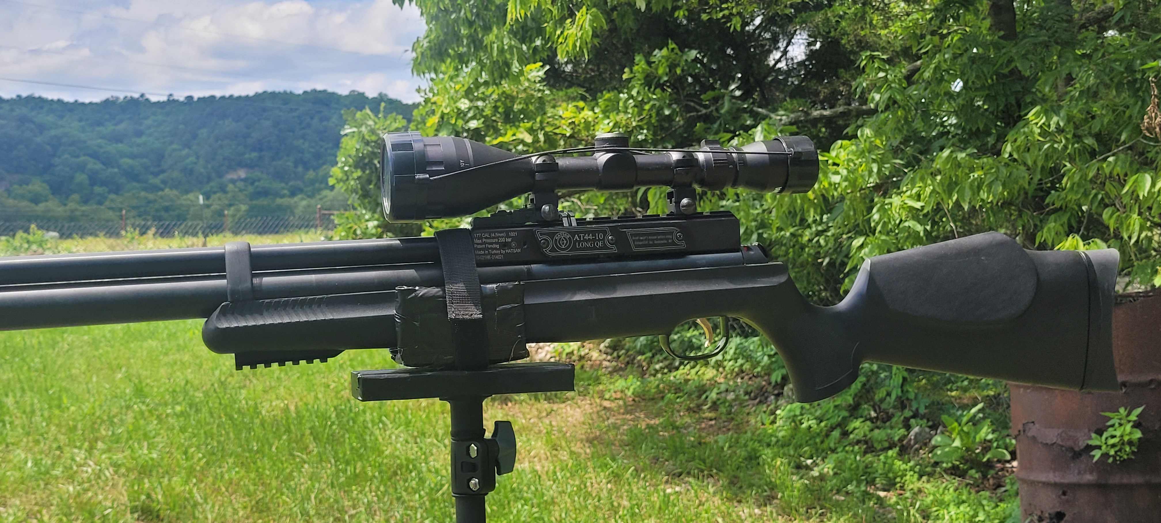

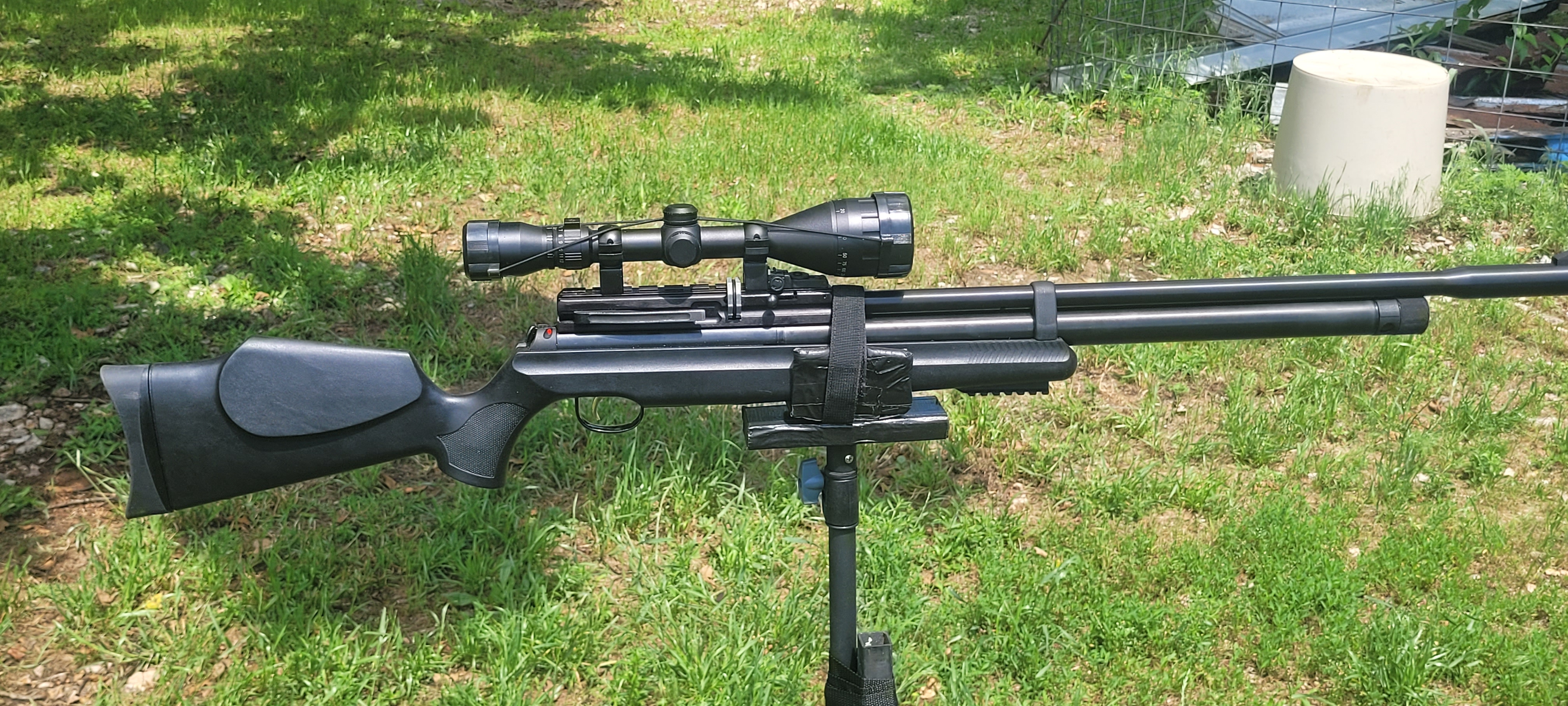

I have achieved harmonic balance for what I need and what I desire out of my Hatsan at44-10S qe long .177 I am sure that others will see these numbers and will consider them average at best. Any way here's what I am pleased with. I have a hatsan regulator set at 100bar. I'm using JSBM 13.43 at 950fps (27fpe) and getting 50 usable shots from 200bar to 100bar.

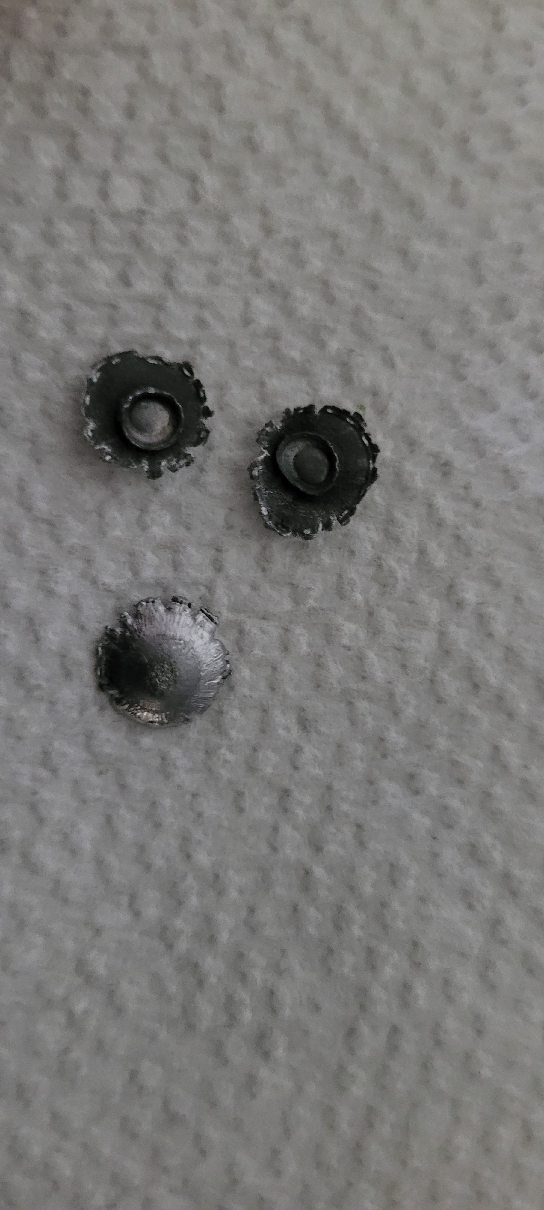

It just feels.....right. I don't know how else to explain it. It is super quiet. Seems like it isn't wasting air per shot. The shots are coming out with a super flat trajectory. I was able to find some of the shots afterwards and they looked great. You can see that the impact is almost dead center when looking at the skirt. These were shots from 50yds and I love the way these guys expand. That's definitely good when trying to be humane to the receiver of the lead-lazer.
