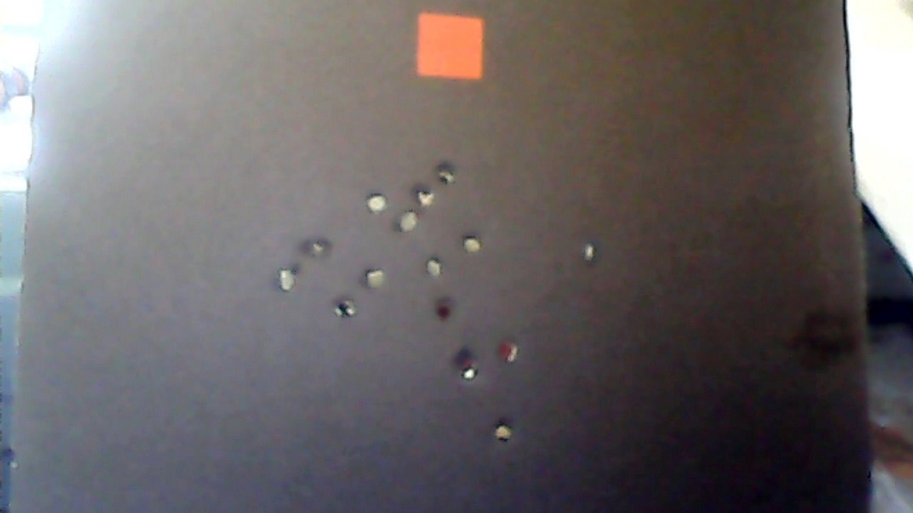

I DID remove barrel and cleaned it before i pushed pellets throu those marks are the rifling marks, here is a pic of grouping after cleaning at 50 yards NO moderator still spiraling, aim point is orange square, 3 1/2 inch 1- 16 shot mag
+1 work your way backwards. Double and triple check everything from a possible loose pellet probe, loose barrel liner, loose barrel at the receiver, etc. If everything checks out try indexing the pellet liner (remove and turn 180deg) use the same aiming point at your target and try another shot string without changing any reg or hammer settings. If your pattern moves then you can probably nail it down to a liner issue. Another step I’d strongly suggest is reaching out to FX (FX USA if you’re in the States). Let them know what’s going on and see if a tech can chat with you about what’s going on with your rifle.

How did you clean your barrel? If you used a pull through was it a super tight pull? What did you see on the patches when you pulled it through. I know when I clean the liner on my Impact 22 slug liner I use a Patchworm that's so tight I prefer to wear gloves when pulling on the cord but the results are spectacular. Usually some lead flakes but after a couple of more pull through's I'm done. This is after I polished the barrel, should have seen it before the polishing. Just making sure when you say clean you really mean clean.

What I see and read here sounds like clipping of pellets in the shroud. An easy check is to look into the exit hole for the pellet in the shroud and see if you can see marks of clipping. In most cases these are visible with grey striped marks inside the exit hole when it's clipping.

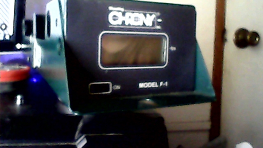

What chrono were you using to measure this? I've seen some extreme spreads but this sounds like a wrong measurement to me?! Even with a broken regulator I haven't seen these spreads in velocity.

model f-1 and not clipping the shroud
