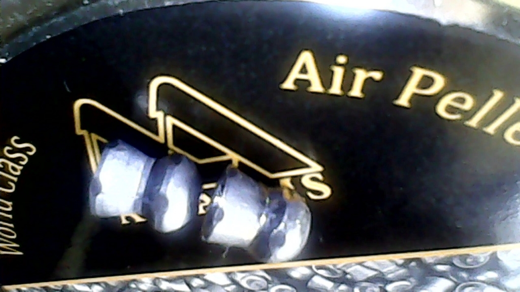

just pushed these two pellets throu barrel after cleaning again
it was shooting great a month ago i was shooting golf balls at 50 yards with no problem
Stop. Everyone, please stop, please stop just for a second here. ^This is really REALLY important to diagnosing this issue.
So lets work backwards for a moment here. We know the gun was working, and something changed. Playing guess and check is like playing the lottery, someone may win but you don't know in advance who got it right. Lets stop for a moment and approach this systematically.
Start from the beginning: your gun was shooting great, what changed? How did it change? And what have you changed since then? Your goal should be to get your gun back to its last known working configuration and go from there. Ideally we'll do this, not by randomly guessing causes and checking them, but by systematically troubleshooting; eliminating possible causes by system rather than one at a time. The primary breakdown I use for PCPs is air supply system, hammer/valve system, and barrel system. If you can eliminate two of those, the problem is going to be a LOT easier to solve.
So here is what I'd recommend. Lets start with what you changed from the last known working configuration. Also double checking your chrono might be a good idea, because if you're slinging the JSB 25.4g pellets at over 1,000fps with some shots, that'd be ~60 foot pounds which is a lot from a 380mm barrel and almost twice the factory specified 36 foot pounds.
And that is it? Did you clean it before you put it away? Have you cleaned it since? Seemingly insignificant details like this matter because mechanical systems, largely, don't change from sitting idle. Lead could oxidize sitting in your barrel, an o-ring could give out, so on and so forth but these are all pretty eclectic and unusual things to lean on.
I guess failing all else, the thing I'd start with is the barrel assembly. If you can lean on another FX owner somewhere, I believe the Impact and Crown and Dreamline all take the same thimbles etc so if you can just quick swap an entire barrel assembly that'd be a really easy way to rule that whole system out.
Regarding air supply, FXs are blessed with gauges so you can keep an eye on that but also ensure the path is clear, no lubricant or lead or the transfer port adjuster anything is obstructing the flow path.
That is where I'd start personally.
