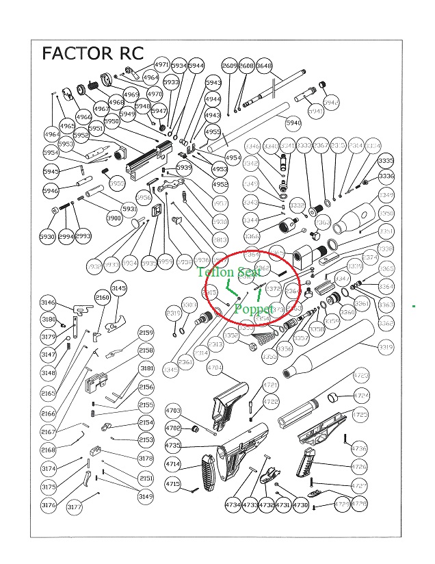

Hatsan factor rc, mine leaks where the pellet goes into the barrel. Its loud when u have the bolt open. Pls help
sounds like a bad poppet seat, your gun may have come with a spare Nylon poppet seal and O-rings, not hard to do, just make sure to degas the gun first and use Silicone oil or Silicone grease to lube the O-rings before assembly, here's a Exploded view of the gun
note the red circle around the poppet valve and the green lines point to the poppet and the Nylon seal... Copy and save.
