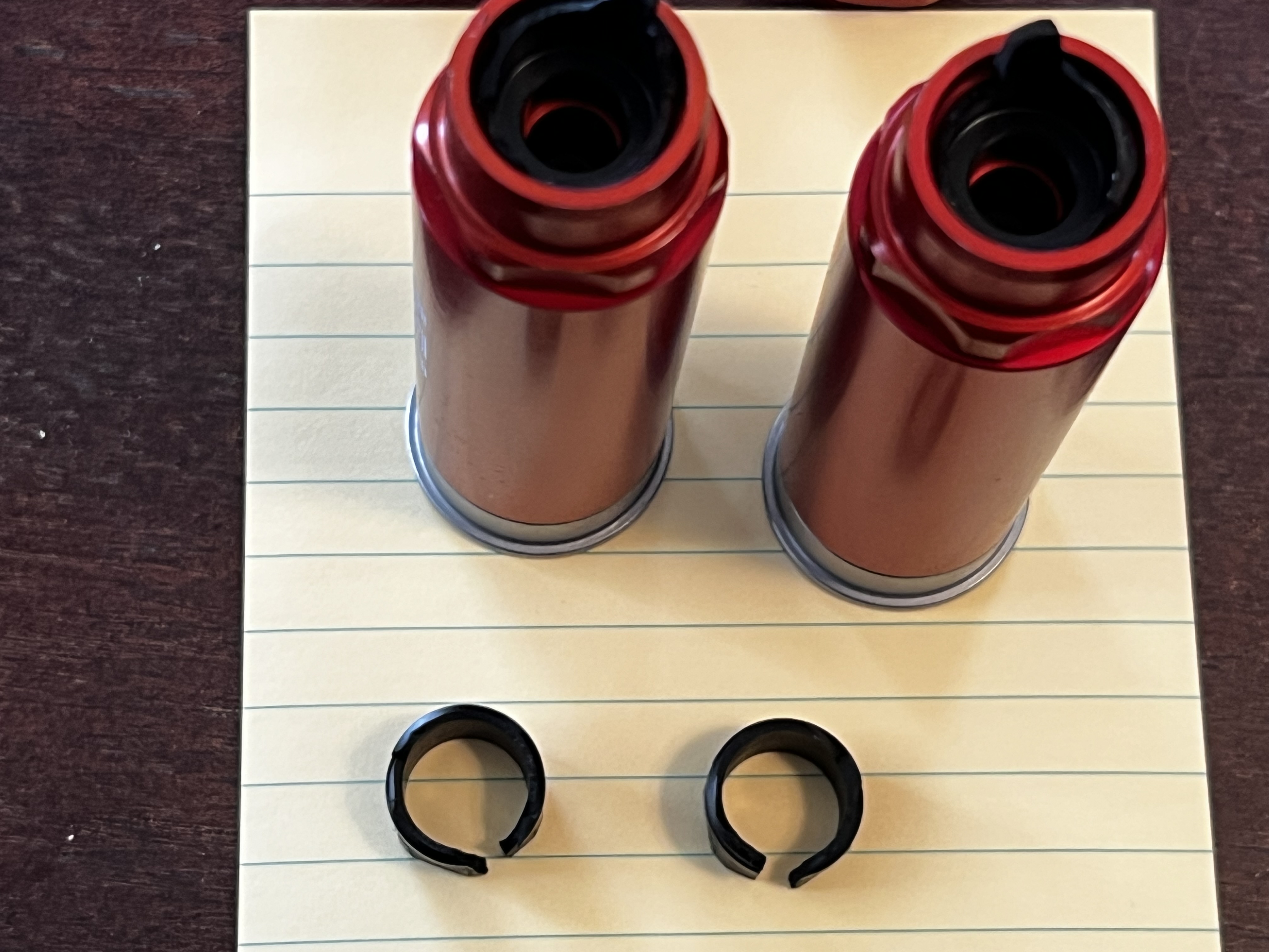

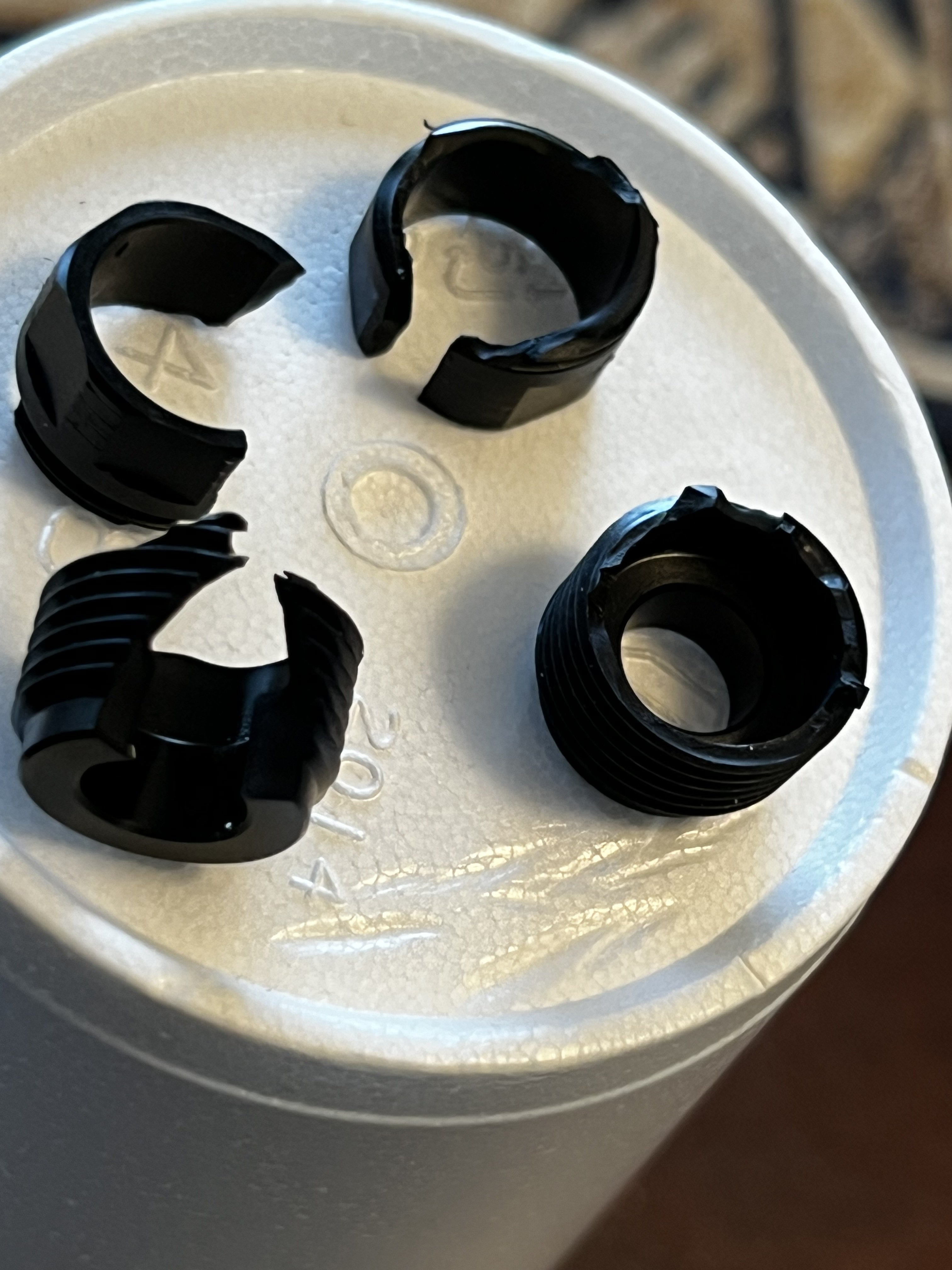

But the first time I fired it, it blew up the bullet holders in my hand. I fired two rounds, and both bullet holders were shattered to pieces. Please see pics. I noticed there is also no machined groove for venting across the bottom of the shells that were sent. Although I can’t be sure if that’s critical.
Anyway, all four plastic bullet holders were absolutely shredded after only one shot each. I’m $1000 deep into this new gun that explodes under fire in my hand.

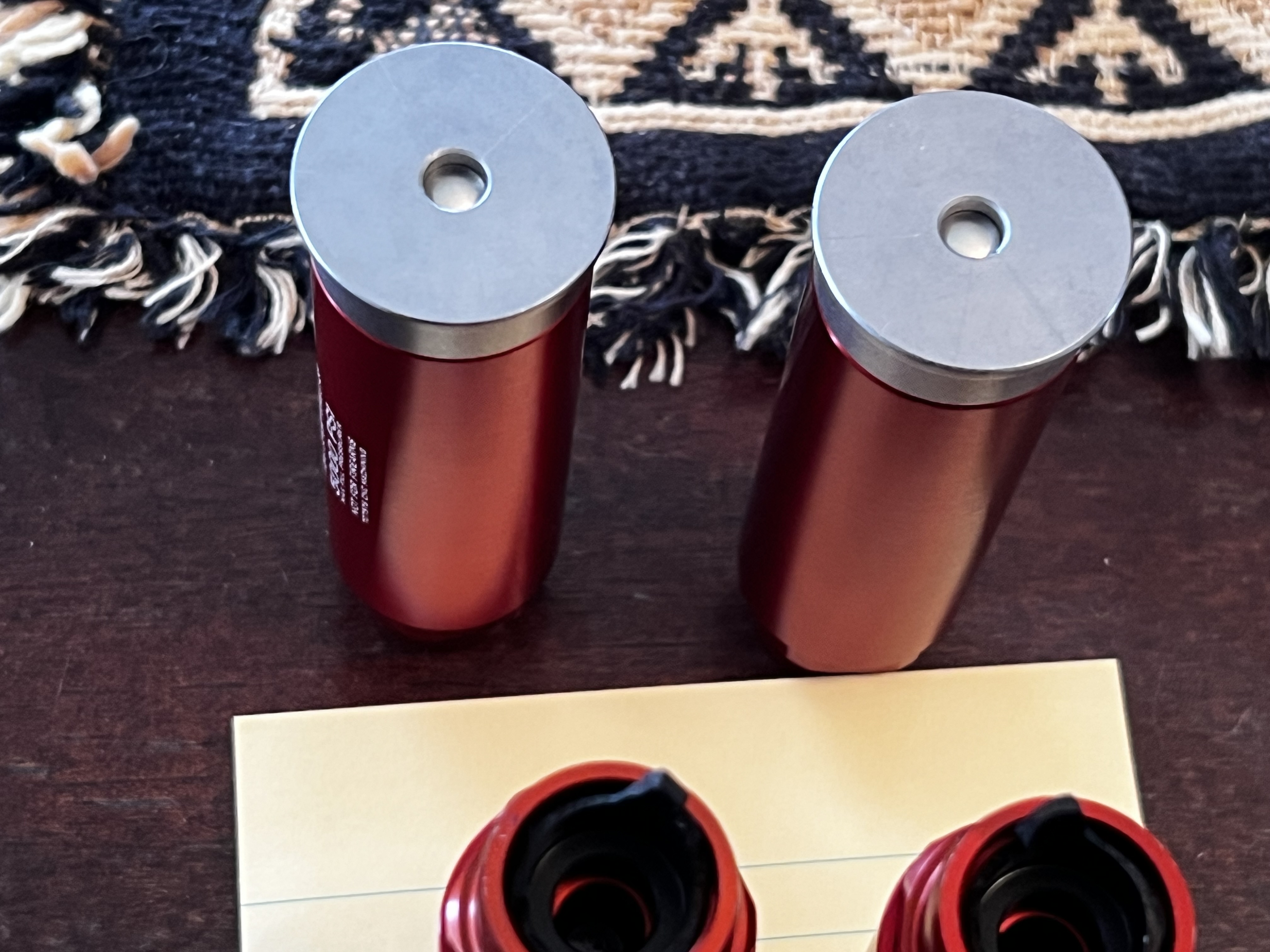

4,500 psi, yes. Those plastic slug holders were seated firmly for both shots as well.
The (Texoma) slug was a proper fit in the plastic holders too.
And that designed pressure blew the **** out of the (afik) STOCK bullet holder in a single shot... four times in a row.
Turned 4 bullet holders into shrapnel... until I ran outta bullet holders.

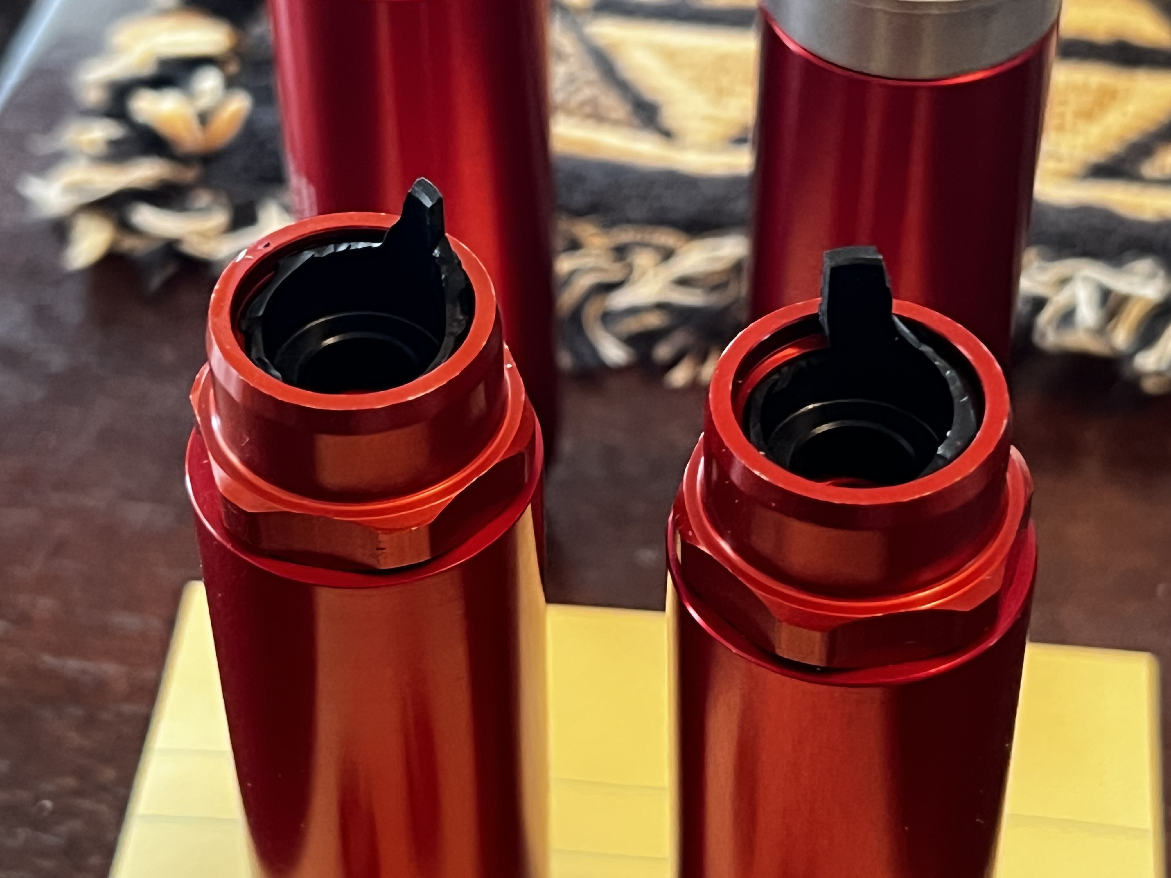

I believe the grooved cartridge base (Texoma video I think?) may be critical to venting.
I think this groove would've negated the breakage. Mine is not even the magnum!
As it sits now, I wonder if even (the coming new) metal holders can take shock like that.
...unless the stock holders were just junk plastic and not even genuine AEA...???
OTOH, I can't find any pics on google of grooved cartridge bases at all.
