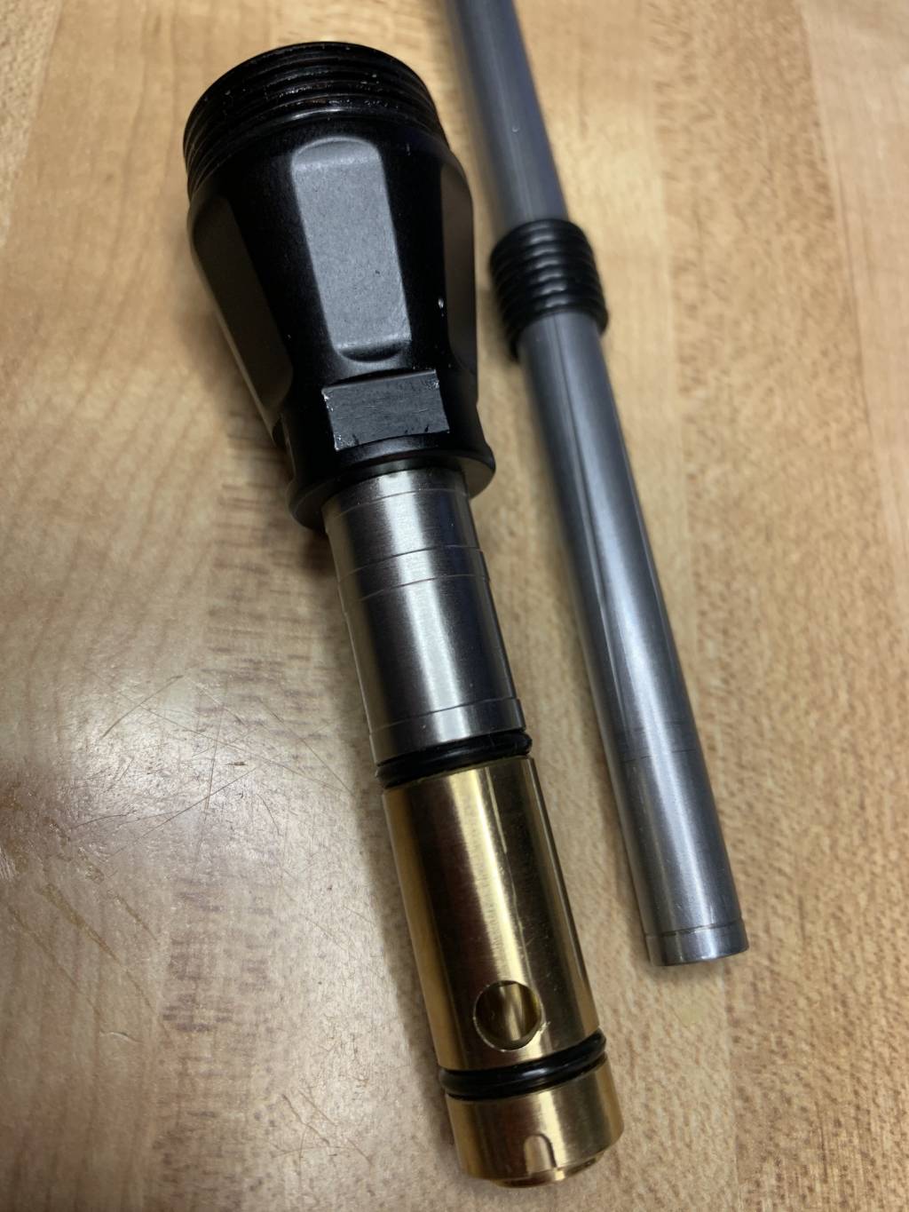

Looking at them, the tubes that slide into the receiver looked identical. But when I slid the lightweight barrel into the receiver it was short of engaging with the alignment pin. When I looked closer there is like only ⅛ inch difference in the length of that tube. Just enough that the alignment pin wouldn't engage. Why in hell would FX not make the barrels interchangeable between model versions?????? Or am I missing something?????
Long_Gun_Dalla - The thing that threw me is that everything else about the interface of that portion of the barrel and receiver is identical. Why just change the length by 1/8 inch?
I could machine that little bit off the (black) barrel nut/shroud retainer portion that bumps against the receiver (in my lathe) but I would remove the lip and be at the start of the wrench flats which doesn't excite me. It doesn't look like that silver tube portion that sits in the receiver can be moved out of the black part that the shroud screws onto. I'm not sure how they are held together.

The original barrel has that black section that is the same diameter as the silver section. You can see where if I turned down the lightweight barrel to the start of the wrench flats I could make it work. BUT WHY?????

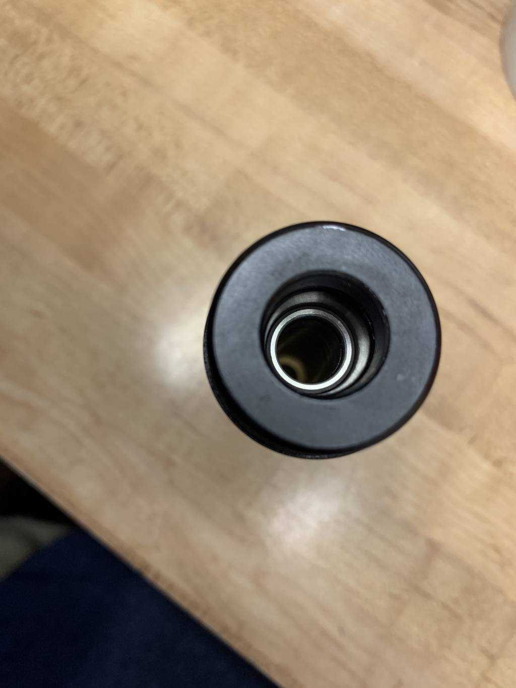

jking - In the photos, you can see the silver part of the silver/brass part that inserts into the receiver. I'm not sure how it is held into the black cone section. It looks like it is pressed in as I cannot see any sign or threads inside the black cone. The compression o-rings that hold the barrel liner in place seat against the end of that silver steel tube inside the cone. That steel portion of the silver/brass tube is turned down by about .050 inches in diameter where it fits into the black cone so the shoulder of the silver tube buts against the black cone. Therefore, I'm at a loss as to how to lengthen the silver/brass tube so the slot can engage with the pin in the receiver. It just seems like the only way would be to turn down approx. 1/8 inch of the black cone to match the diameter of the silver part as it is in the picture above of the original (heavyweight) barrel.
Long_Gun_Dallas - I kind of doubt the silver tube is threaded into the cone because the inside of the cone where the silver/brass tube would screw in would be most likely threaded through and I cannot see any threads in that area. My other problem with unscrewing it if it were threaded in is that the ID of the silver part inside the cone is roughly .050" smaller. With the shoulder of the tube not being in contact with the mating surface of the cone, any force on the barrel would probably cause it to bend or break.

I just saw a post on the impact barrel and the brass tube (with the transfer hole) does thread onto the silver tube. So maybe the silver part does thread into the cone. I would be able then to maybe back out the silver part and machine a washer to fill the gal so there would be support from the shoulder. The only question then would be what the inside of the cone would look like where the compression o-rings OD would seat.
If I knew for sure that it was screwed in I wouldn't be so afraid to try to unscrew it.
