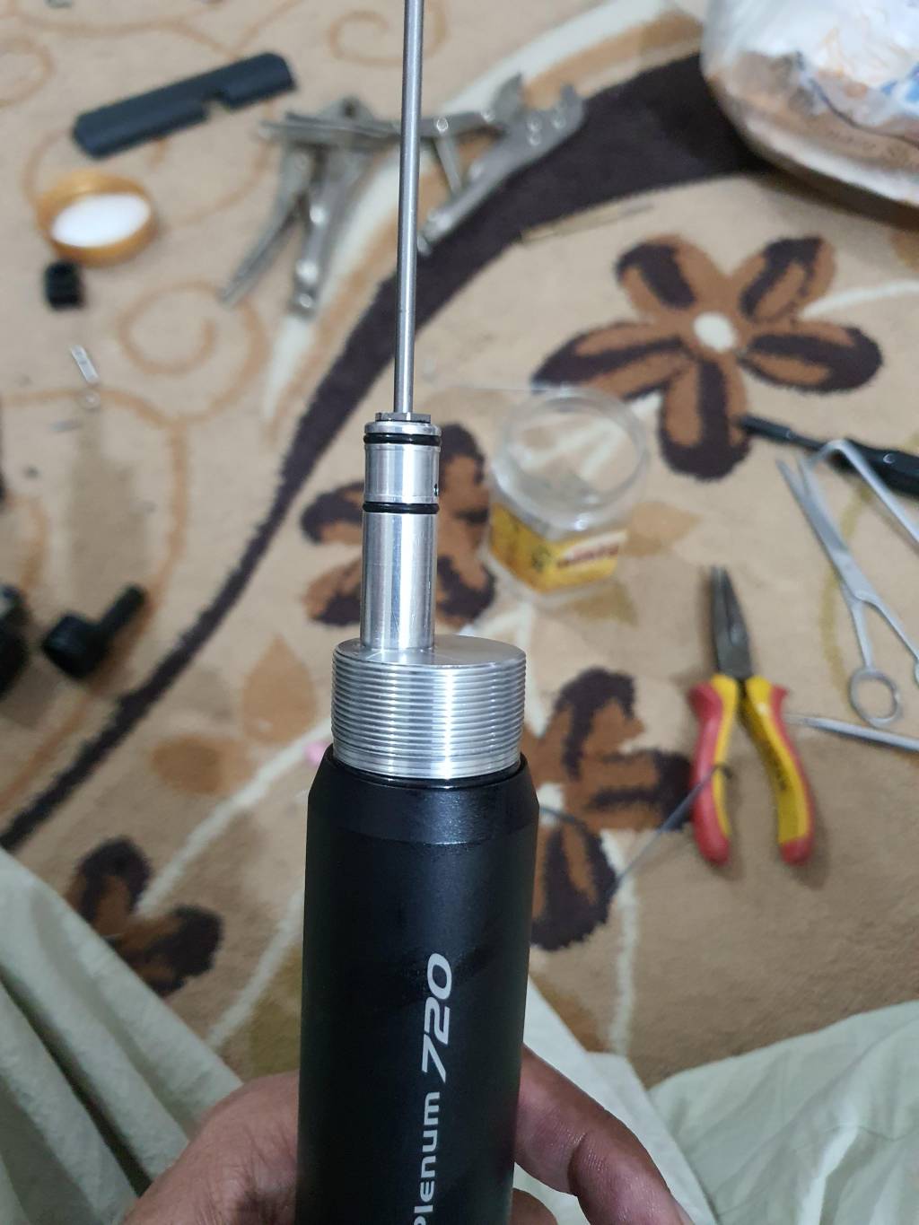

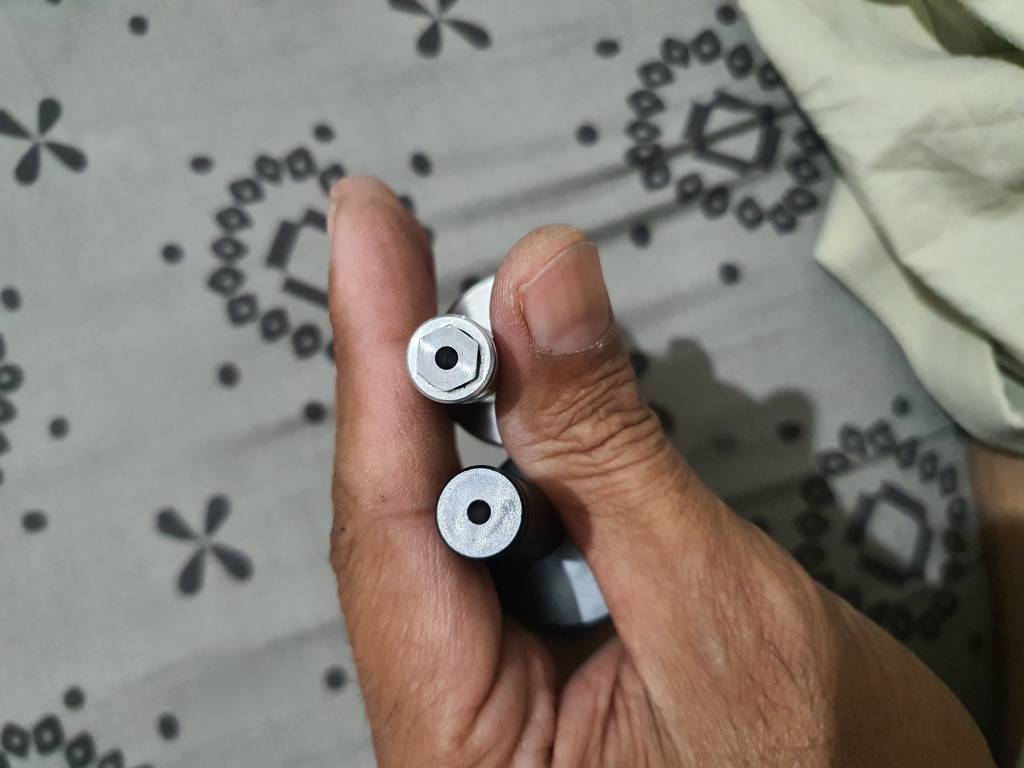

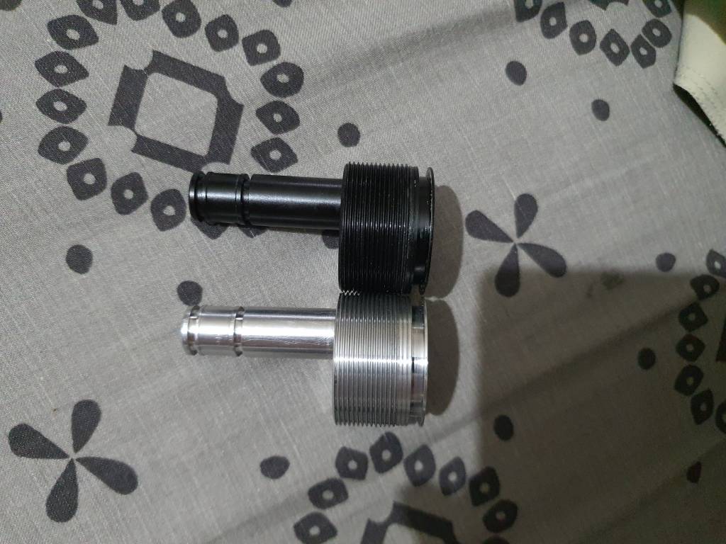

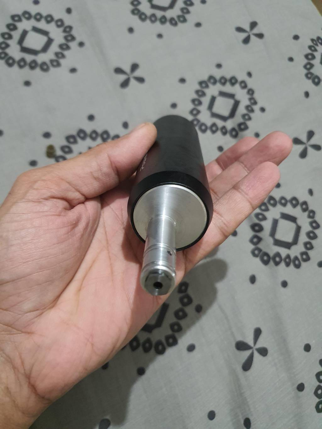

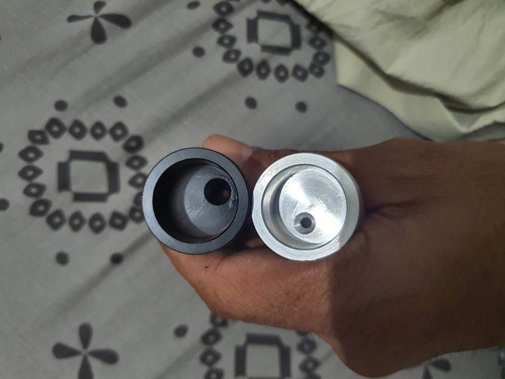

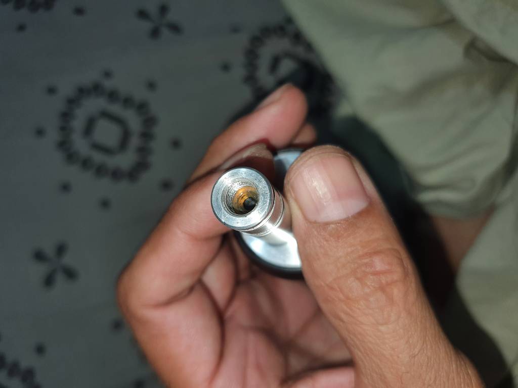

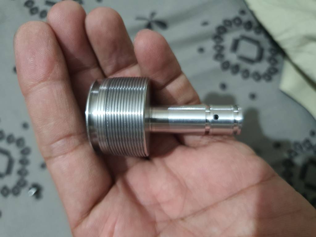

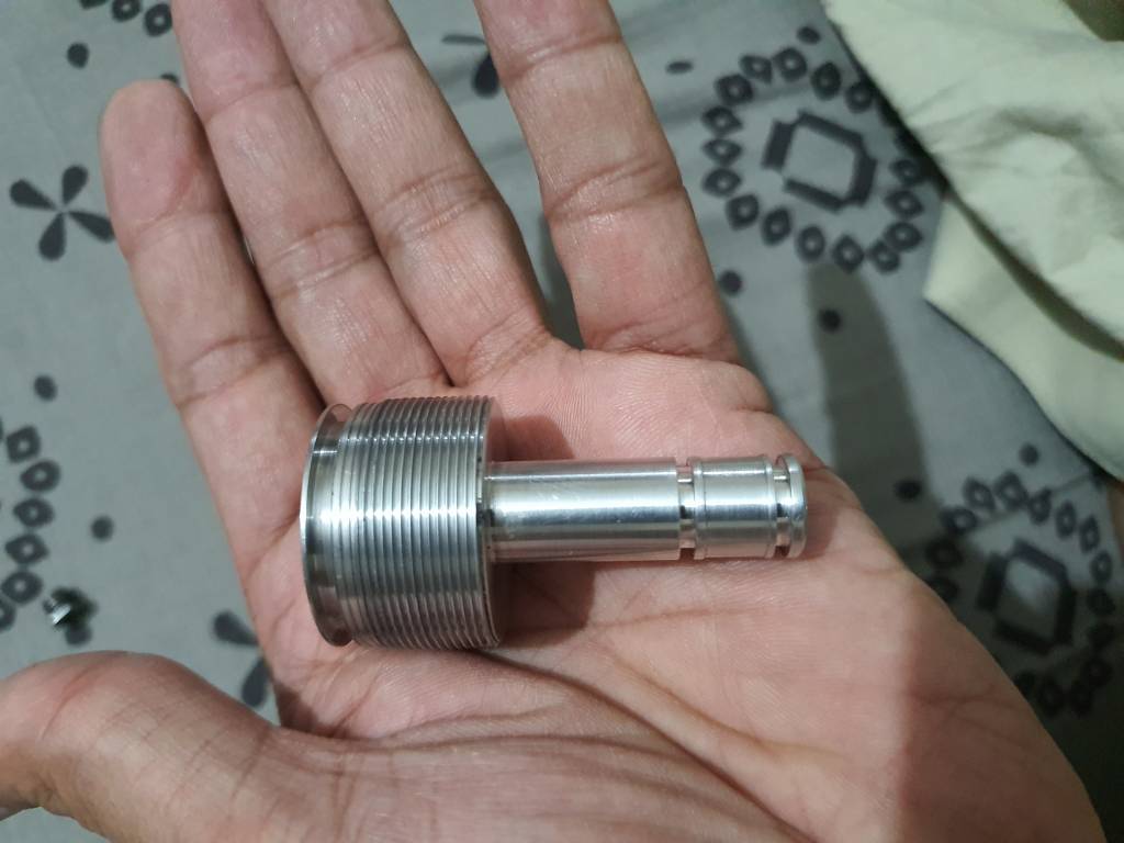

After many days of experiments with the front part of plenum made for R&D, I have finally concluded that the part that I made on the pattern of Impact 1st generation version, works much better when the gun is shot after lying idle.
In the OEM plenum system, I had to shoot 3 to 4 pellets after putting the gun away for overnight. Then after 3 or 4 shots the fps used to come back where I had set the gun.
Now after installing modified part I just need one shot and then the 2nd shot is within single digit of the last adjusted fps.
If users need this part I can arrange provided more than 2 parts are required in total.

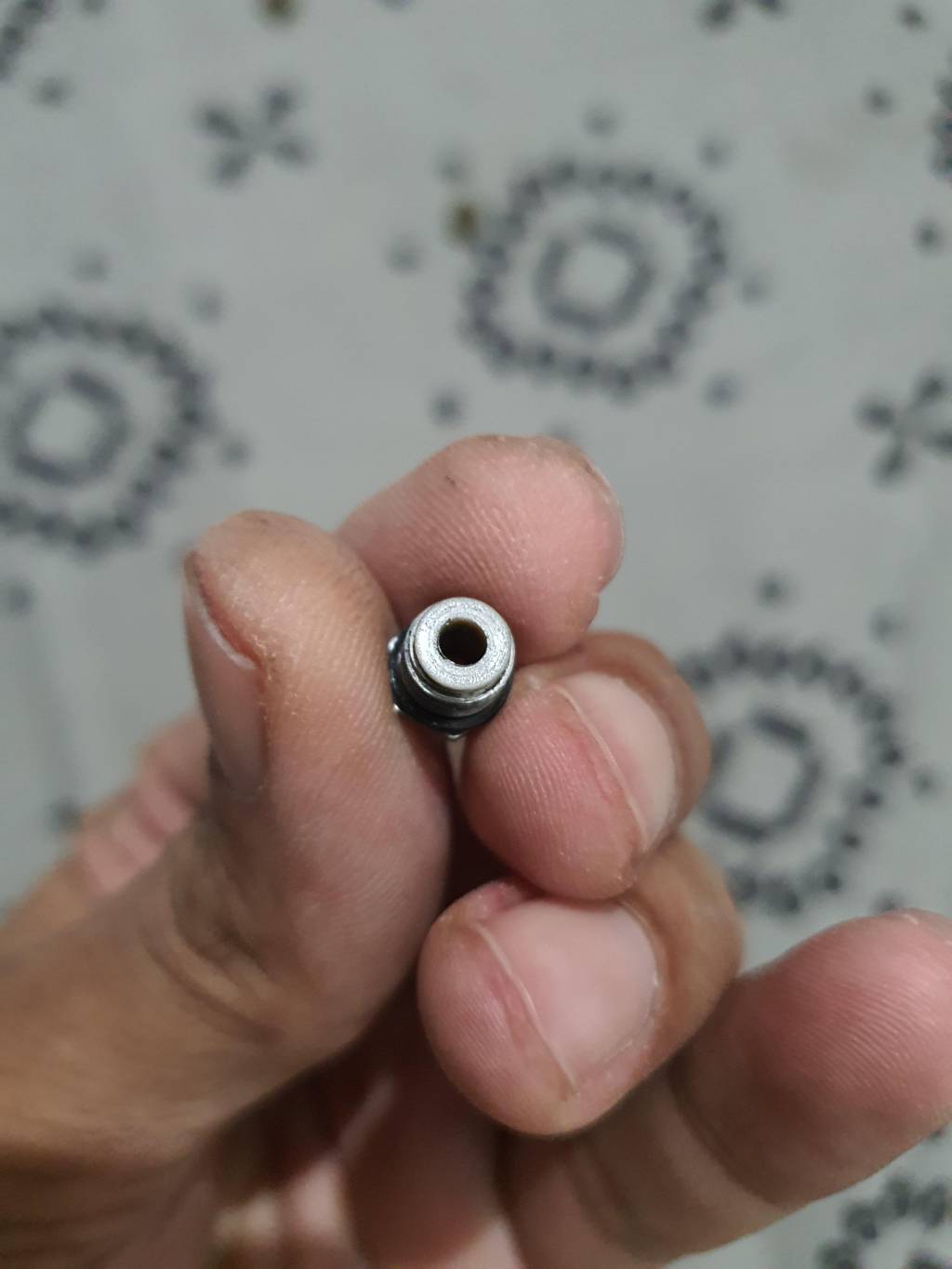

Hi Mubhaur, couple questions. When you went to the MKI style front plenum cap, did you delete the Buna o-ring that was behind the polyurethane 90 o-ring? Did you try switching the polyurethane o-ring for a Viton 90 like Seeker suggested? Did you notice if the first shot was improved to any degree before the gun settling in on the subsequent shots? Lastly, if you make these parts will it include the nut with PEEK insert? If so, I'd be in for one if anyone else is in for one to make 2, or let me know the price and I may be able to take 2 myself.
Cmatera
If you see my original post on this forum, you will know the date when I did it. I just refer it as I do not rememember the date really . Yes this modified part is exact copy of mk1 part. Hence no NBR 70 shore O ring in it. I did not use Viton as Seeker has tried with a peek disc. However I have tried NBR 90 shore with peek disc. It worked much better that the OEM set up of M3. For me and for some of my friends to whome I have talked to, MK2 pp and M3 takes 3 to 4 shots and the very 1st shot is sometimes 40 fps low and during 3 to 4 shots the fps gradually recovers to the actual desired setting. After using modified part I get the 1st shot at around 15 fps low and the 2nd shot is always within 10 fps of original setting.
Further even if I put the gun away for half an hour even then the 1st shot is within 10 fps of the desired fps hence usable. previously with OEM set up even after half an hour the 1st shot was so low that it was almost useless. During my various experiments the retaining nut with a bit tight peek insert prooved to be counter productive. Hence I finally opened up the hole of peek insert in the screw and now it moves freely on the valve rod. Yes this screw with free moving peek insert will be included.
