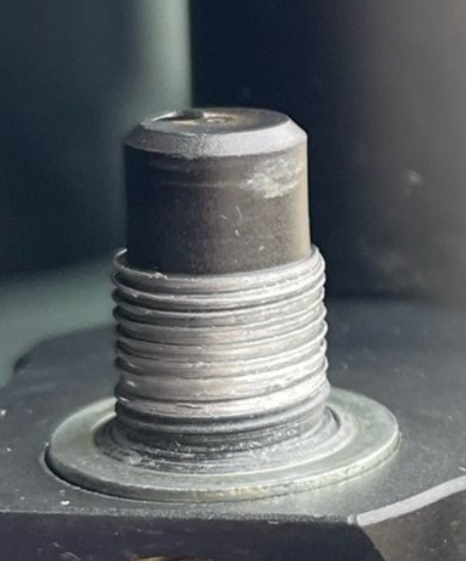

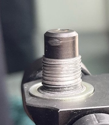

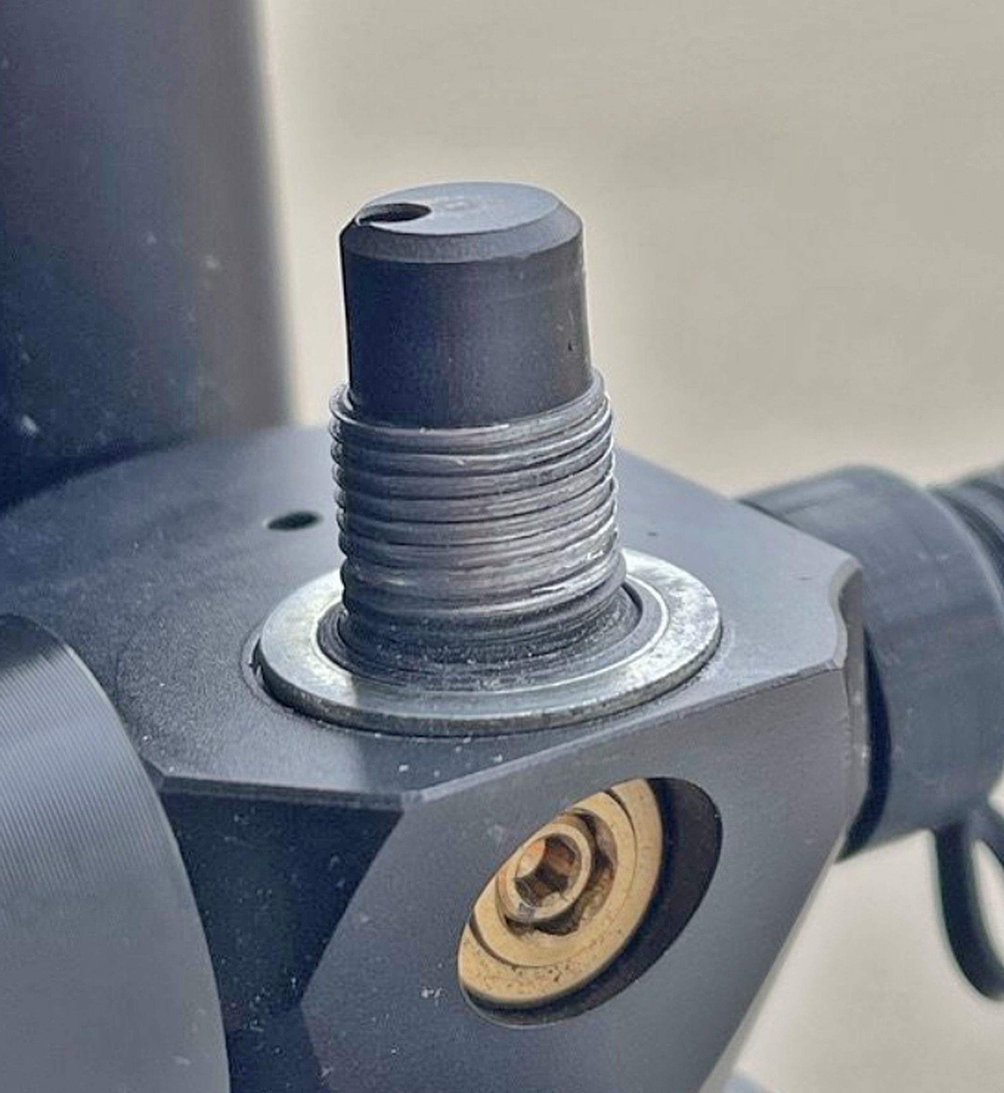

I was in the process to put back the CF bottle and all of a sudden it started hissing and would not seal. I took it off and on a couple of times today to set my regs and had no issues.
See pictures....what did I damage? Did I strip the threads around the nozzle or in the bottle?
What is the fix to this?
I was looking forward to enjoying today and tomorrow as we have not had good weather in a while but this completely put a wrench in my plans of tinkering and getting my gun set-up how I wanted.
Thanks for your help
Your threads are history. You got silicone on them and that’s not good. You shouldn’t have to take your bottle off a whole bunch to play with that reg. It’s not as important as some would lead you to believe. Set it at 190b until you are all done tuning your gun. When you finally get your gun set to where you like it, then you can adjust the first reg 30 or so bar above your first reg. So in the end you only have to take the bottle off the minimal amount of times. You need to order some parts before you can play with the gun again.
It may be an artifact of the picture compression but the threads are flat and pitched, classic cross-threading.

I made the mistake of using Super Lube O-ring lubricant and not silicone grease on the threads. Rookie mistake and now I am fu**** :mad:

Don't use anything with silicone on metal connections that are subject to high temperature or pressure. If anything, a good synthetic high pressure grease. I don't know how silicone became so widely accepted in air gun maintenance, maybe because it's good with rubber, plastics and O rings, but in low stress applications. Car window and door moldings for example.

Well you bought a FX, so you’re gonna have to learn how to work on a gun and the tools needed. I gave this advice long ago and I’m not a FX hater. I’m a FX realist. I currently have four of them. If you love shooting PCP’s and you feel you must own a FX, also have a Taipan, Edgun, or Kalibrgun. That way you always have something to shoot while your FX is down for the count.

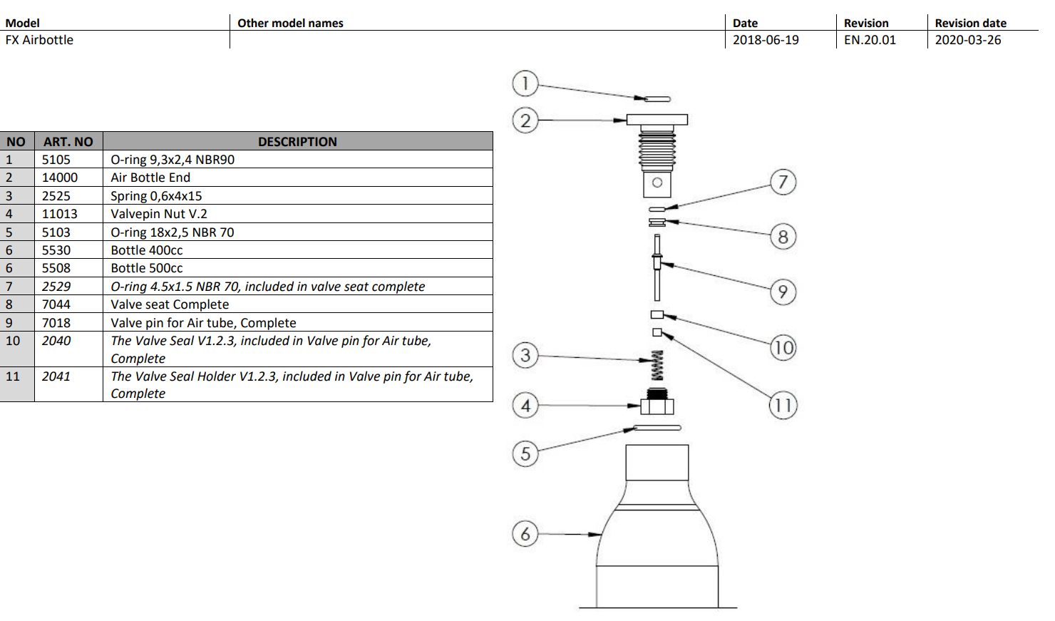

What do I need to order from the following list and from where can I get these parts aside from classifieds?
Utah Air is your best bet. You need the threaded part on the gun as well, don't try to get by with 1/2 of the repair.

Like several have stated above. NEVER use silicone grease for any metal to metal contact. I've read how many people think that Silicone is a good lubricant for all areas of airgun lubrication. Not true!!
It IS a great lubricant for metal, to most any plastic, rubber, and many composites. It's what you use for the leather seal, in the classic spring guns of the past. But only on the leather! Not the spring, or piston, or any hinge linkage points.

I am comfortable working on things. I just want to know the tools needed and with guidance i am confident i will get this resolved. Plus the parts I need to fix my mishap
