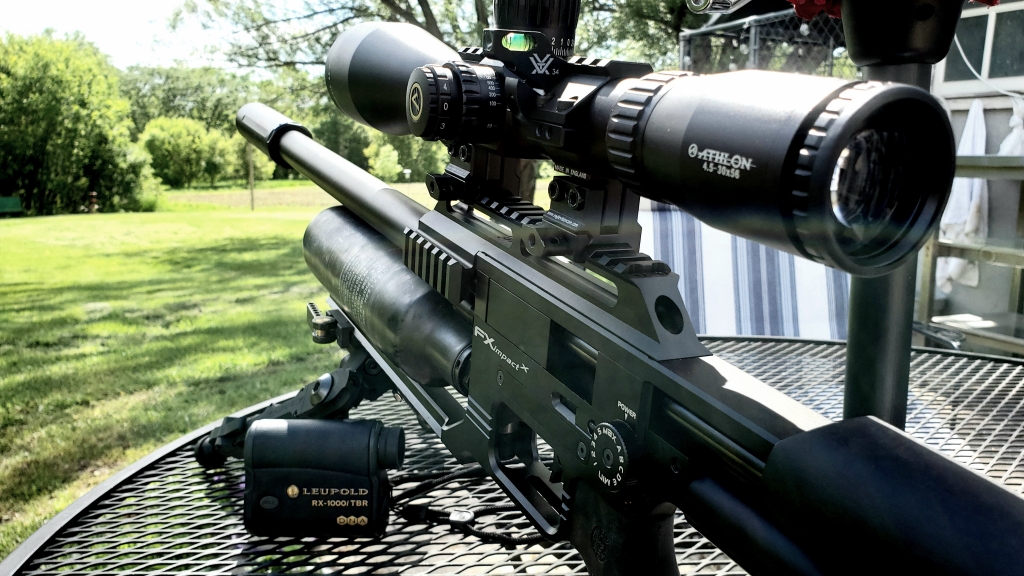

I am finally happy! .25 Mark II setup

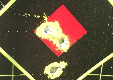

I finally have her dialed in over the last couple days. The Athlon turret is dialed in from 25 to 170 yards. Very happy camper here :) The target picture is 3 in a row at 132 yards

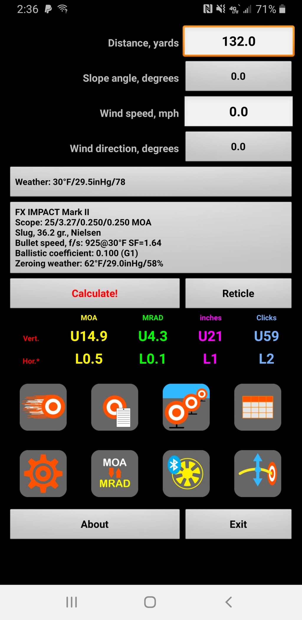

I have Strelok Pro and I have, I think, entered all the information correctly and my numbers don't quite match what Strelok says. Is there a way to fine tune Streloks numbers to match mine more closely? That way I could shoot all the way out to 200 and 300 yards with me having to walk my fat ass out there to the targets. LOL
there are a few ways but it would tweak with BC number first. BC changes with speed so see if you can get better BC number at your speed, there are YouTube videos on how to do that.

You can just start playing with the value that you enter in Strelok for bc until it predicts 68 clicks and use that. Which should be closer to correct for all other calculations as well.
I'm not sure how you determine the gyro stability value to enter for spin drift calculations but this could be a good guess as to why Strelok is recommending 2 clicks left.
