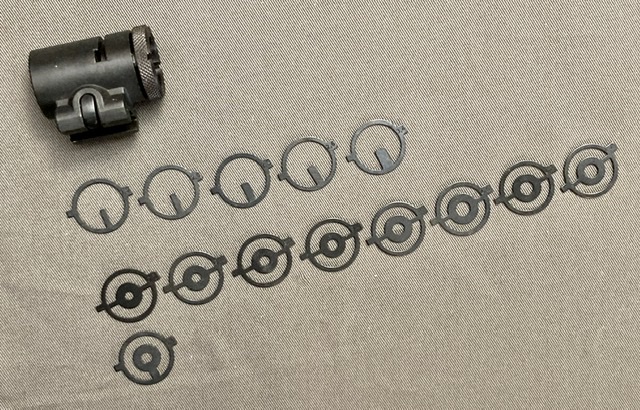

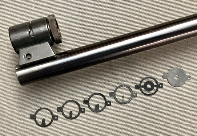

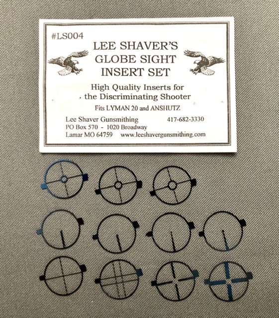

It's odd to me that HW has apparently never changed their repertoire of front sight inserts...I believe you get the same six today that you would've gotten in the Nixon administration! One odd thing is that the posts stop short of the center of the front opening. Which is perfect for a "6 o'clock" hold on a 10-meter target, but I find a little distracting for general shooting.
If you are so inclined, an old Anschutz front sight will fit HW's front rails just fine. An amazing variety of both factory and aftermarket inserts is made for those.

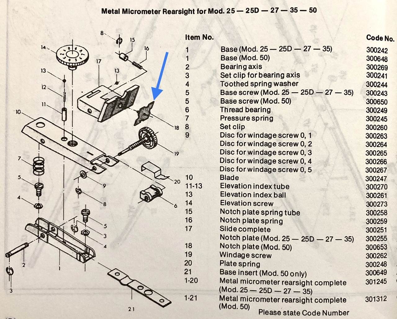

The "4-in-1" rear sight is an awesome idea!
But being a helplessly compulsive airgun history / trivia nerd, I am forced to add that it's not a new idea: Diana has been making their sights that way for, oh, about 70 years now...🙂
Thanks for the tip! Ordered a set yesterday.
