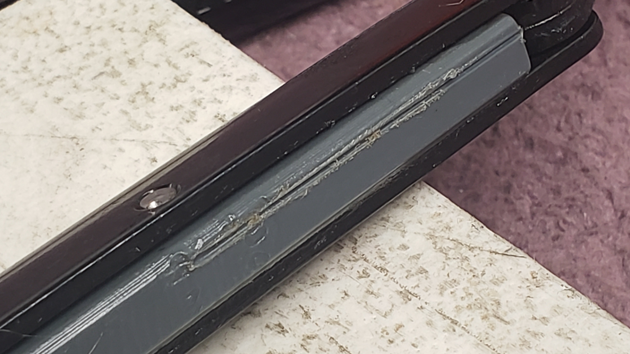

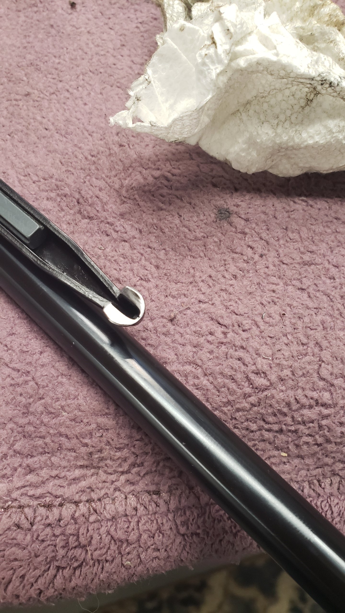

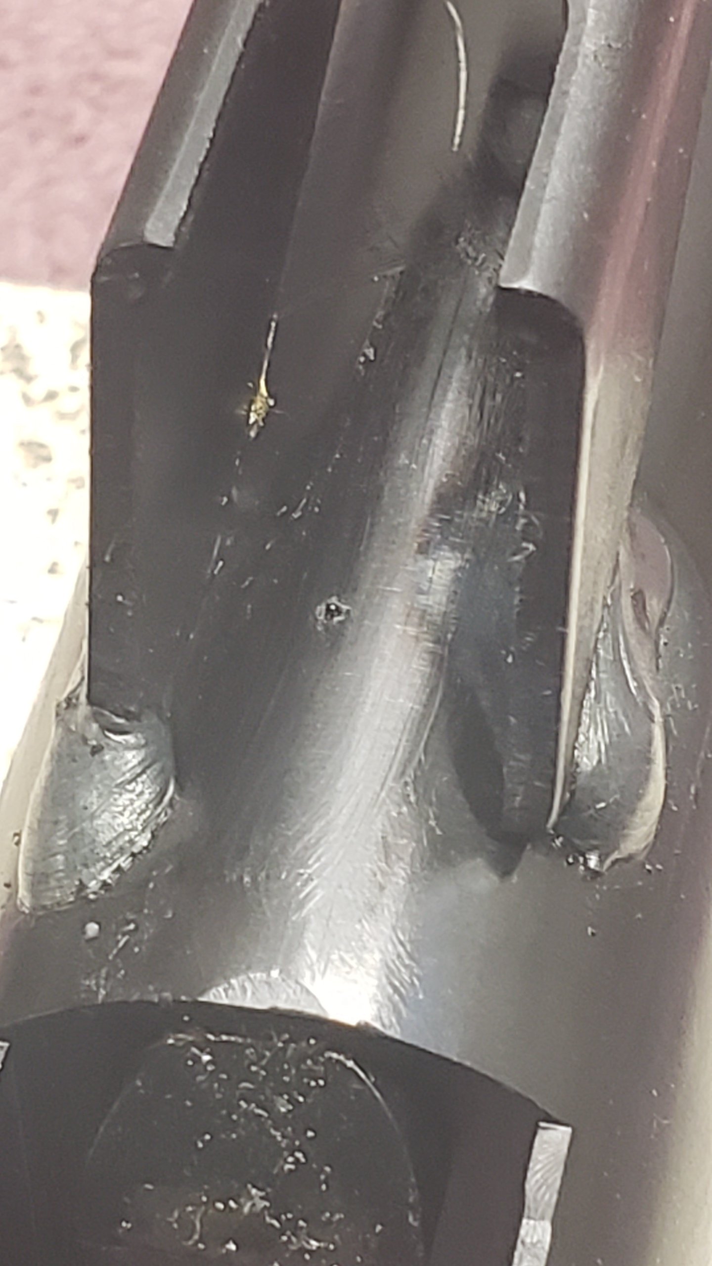

Nope just another sloppily built 2022 Weihrauch model. The first picture shows a bead of slag between the stock bracket that tore up the plastic glide (second picture). The third picture was taken to show how I polished and radiused the cocking foot to prevent galling with the Vortek steel outer guide.
