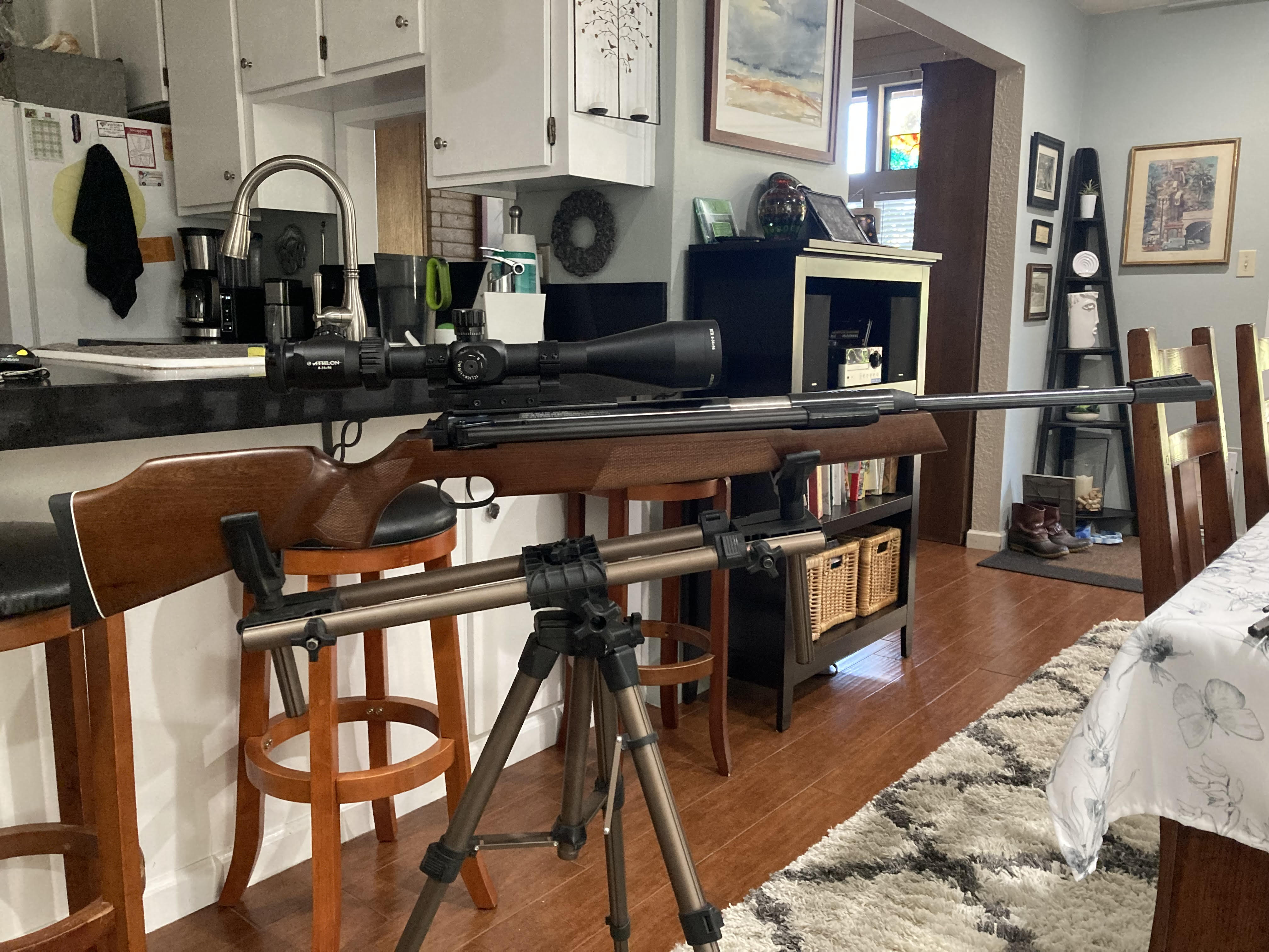

In terms of long-range accuracy, which Weihrauch would one choose? The HW 98 or the HW80View attachment 324756, both in .177 caliber? Extra question, how would either compare to the Diana 54 Air King, which I do own?
