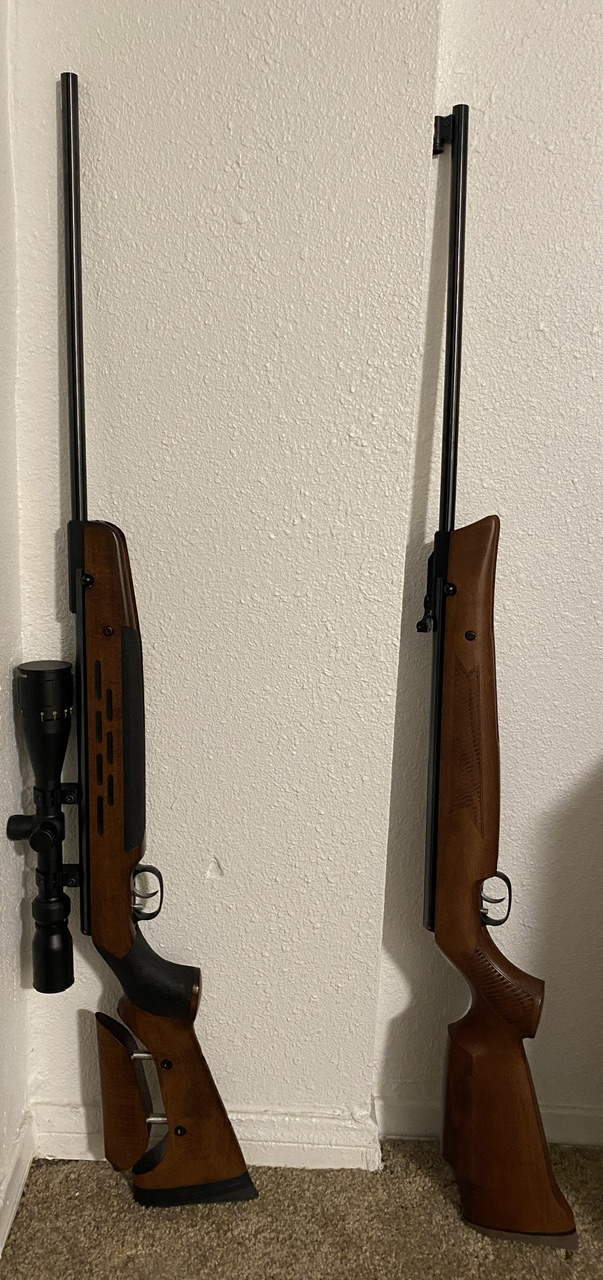

I just bought the hw98 “Match” model in .177cal . I could only find it overseas. It has the long barrel not the thick shrouded short one. Im waiting for the back ordered 98 that i have coming in .20cal with the short shrouded barrel. I will compare them when it arrives. So far the long barrel seems pretty good. I figured i could tune down the shot cycle more than the shorter barrel and maintain the same fps. I’m trying to figure out if the dwell time in a longer barrel will effect it more than being able to tune down and smooth out the shot cycle more. I will swap the same scope back to back to try and maintain consistency. I will probably have to try it with both .177 caliber to get the best possible comparison.
