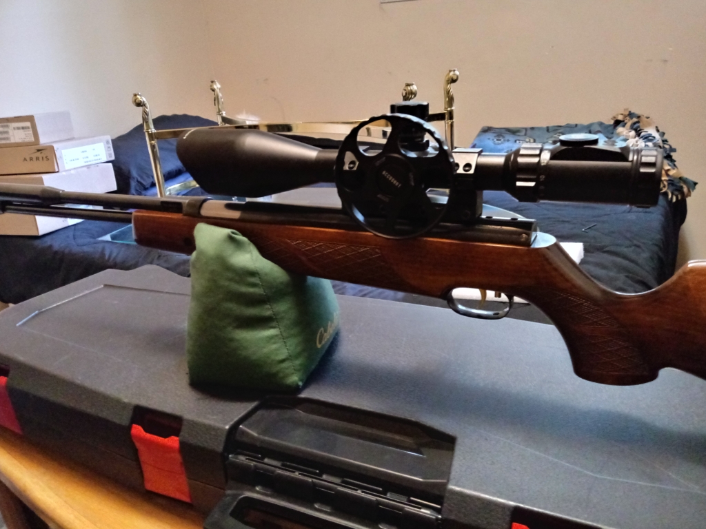

My '97 is a .177 12 ft lb model. I know a few shooters with the same gun in both FAC and 12 ft lb and the pellet of choice for the vast majority of us is the H+N ftt. Mine has a shift in impact in the cold, it doesn't seem to be velocity, just a mechanical shift of 1 mil as the temp changes between 40f and 70f. This is with a Leupold 6.5-20EFR scope mounted in an RWS lockdown mount. I have an SWFA 20x on it now, but it hasn't got below 90 degrees yet this year to see if it is different.

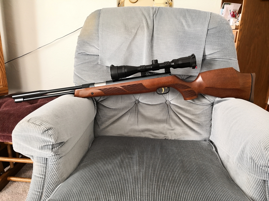

Mine is .22 and shooting at @14.5 fpe using JSB 15.89's. Plenty of power for Any small game or pests. Being able to put the pellet RIGHT where I want it...because:
It's superbly accurate and is on of the few springers I own that I can watch the pellet travel to the target.
Stock spring and guides with No buzz/twang.
Beautiful rifle thats built like a brick poop-house.
