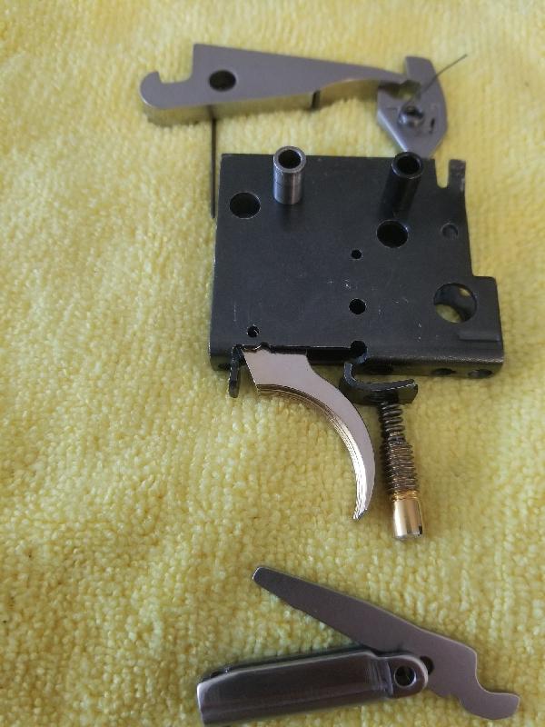

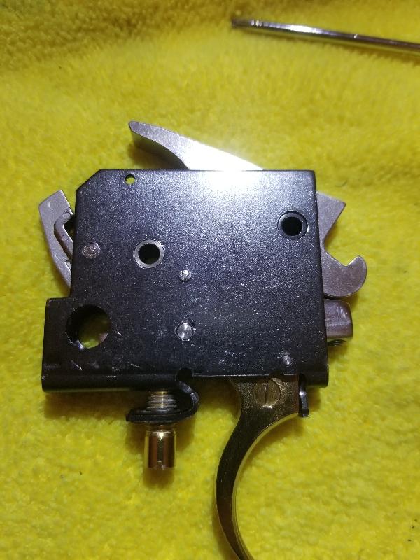

cool ya I lost the spring for my safety trying to install the trigger pack 3 times on the third time I acculy couldn't find it Haha. I used a spring from a ball point pen but I thinknit maybe be effecting the trigger...I just find the trigger feels completely diffrent every time I pick it up...the first stage has a nice heavy pull then on the next shot its light and has no weight behind it. and if you screw it in to much you really got to squeeze itnon the 2nd stage. I'm going to take it apart and try tunning it more and lightly sand n polish the internals of the trigger pack.

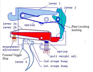

When I had mine out (not apart) to swap in a set back trigger, lever 2 ended up on the wrong side of lever 1 and 3....somehow (I had the trigger blade out, then put in a new one, and was double checking engagement). So I couldn't cock the trigger. I somehow got it back where it needed to be. Maybe that's what's going on with yours? The image shows it in the cocked state. Image taken from https://www.airgunstocks.com/articles/rekord-trigger-service.html

When it's uncocked, Lever 1 should spring up, and the top of Lever 2 should spring back. If they do that, your springs are likely right.
Did you mess with the Torx 8 screw at all? If it's outta whack the trigger won't really do anything. I have a spare pack at home in the drawer, but won't be there for a day or two.
