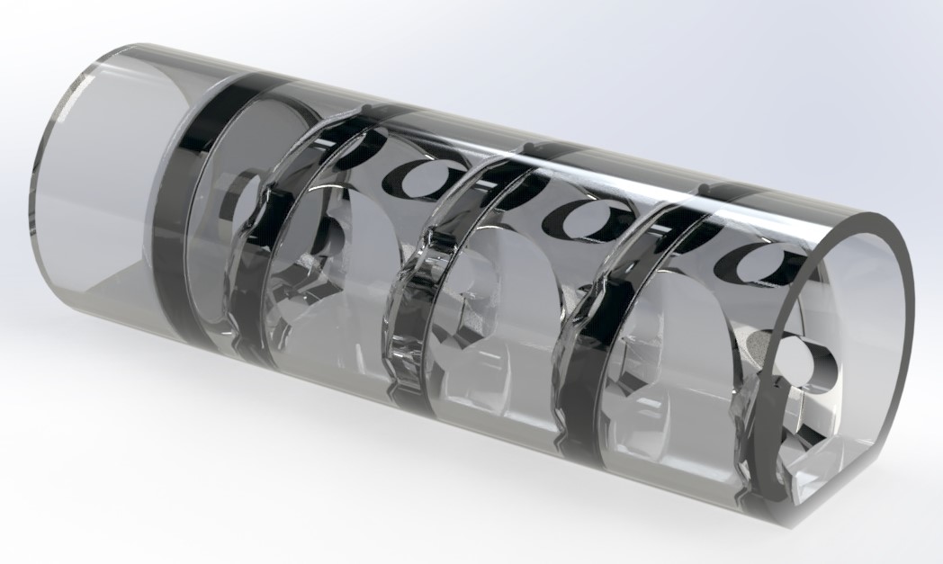

Just the other day, I was shooting my HW97 and the accuracy was getting spotty. So, I cleaned the barrel, and in the process, I forgot to reinstall the cap that goes on the end of the moderator. I didn't know I had forgotten it, and went back to shooting. The pop from the muzzle was so loud I thought it was dieseling. I tried a few more shots, thinking it would go away, but it didn't. Then I discovered I had failed to install the cap. Once I installed the cap, the gun quieted right down to normal. I was really shocked at the difference in report with the moderator assembled properly.
This lead me to think about installing a baffle in the space the moderator provides. So next I designed and 3D printed a mono-core baffle.
This is a rendering of it in acrylic so you can see the helical baffle. I 3D printed the one I installed in the gun. It had a very positive impact on the report volume and tone. It's now more comfortable to shoot inside, and the lower tone is more pleasing to my ear.
